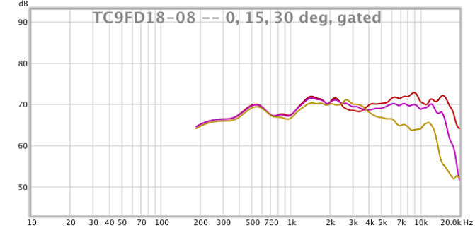

The TC9FD seems to be a winner. I just happened to measure one lately. Good to see that both our measurements match nicely. Looks like amateurs like us can produce good data without the need for an anechoic chamber or professional measuring software and microphones!
Yes, it's great to see confirmation of the TC9FD by someone else. Your measurment is very similar and the polar response from 0 to 30 deg is confirmed to be quite good.
