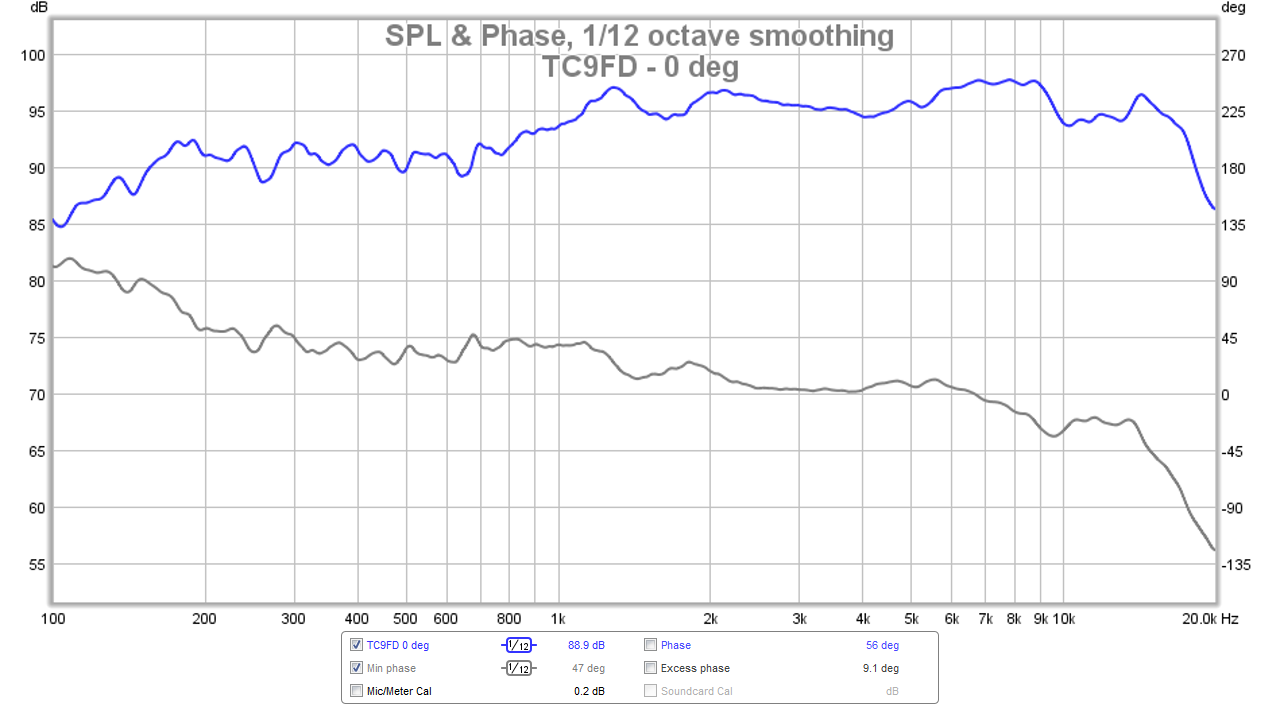

Thanks for the measurements, can you tell us what conditions were the measurements for the A7.3 were made? Drive voltage, distance of mic, type of enclosure, gating time, etc. In any event, the measurements look like they were carefully made and have gating applied to reduce room effects. I distilled your measurements down to 3 angles 0 deg, 15 deg, and 30 deg to keep the amount of data small for comparison with one of my favorite drivers, the Vifa TC9FD.
Here is a summary view of the three different measurements at 0, 15, 30 deg for both drivers. Clearly, the A7.3 has a much higher extended frequency response than the TC9FD, but it is not as smooth. There is a large dip at about 1.7kHz and a rather large cone breakup feature starting at about 9kHz with two large breakup peaks at 10.4kHz and 13.5kHz:

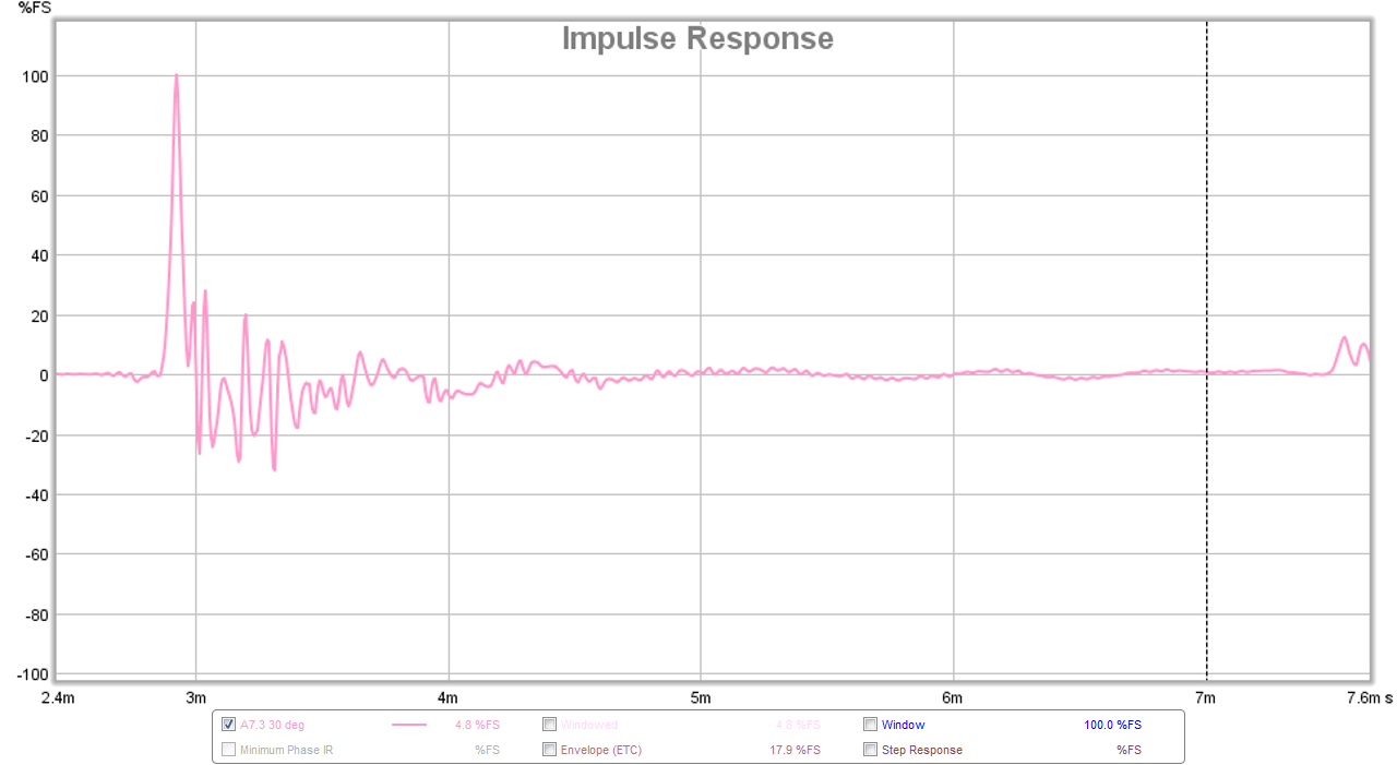

Here is the Impulse Response for the A7.3 at 0 deg, note the large amount of hash/ringing that occurs after the initial pulse - this will sound like an audible background after-effect on sharp percussive sounds that would otherwise sound clean and results from the inverse Fourier transform of a non-smooth frequency response. What shows up in frequency, must show up in the time domain and vice versa. Most notably, there is a ringing oscillation at about 10kHz that will have a sibillant effect:

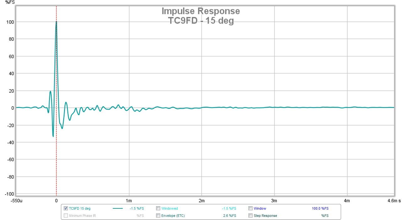

Here is the Impulse Response for the A7.3 at 15 deg, it starts to noticeably appear cleaner with less hash/ringing after the initial pulse. It may be the sweet spot for listening with the A7.3:

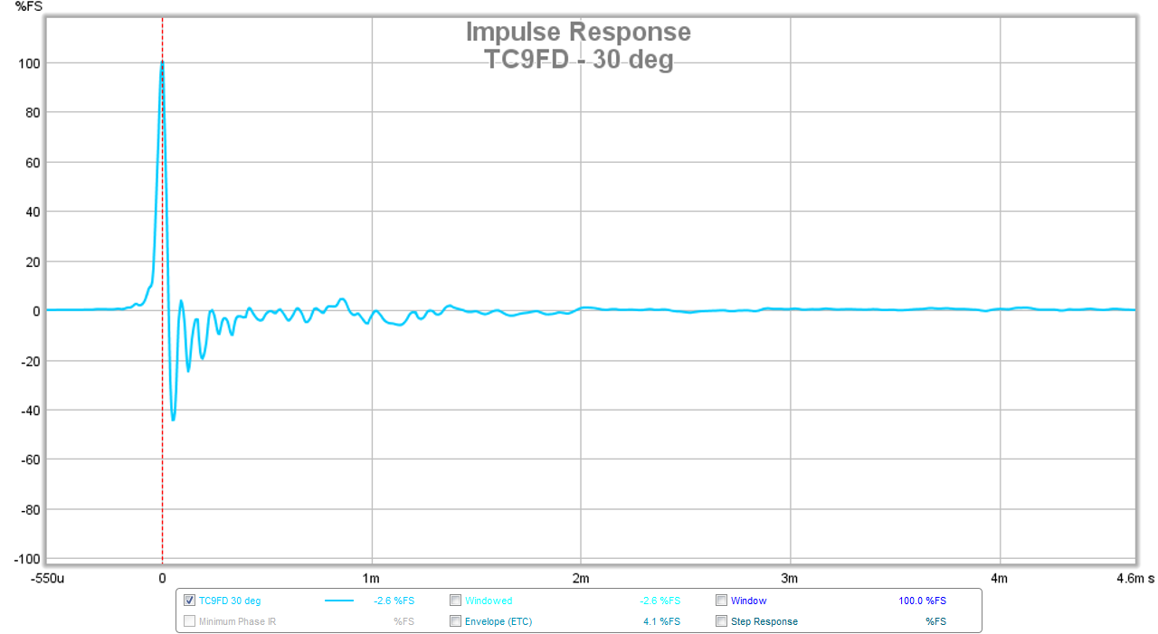

Here is the Impulse Response for the A7.3 at 30 deg, here there is some more after-pulse content showing up again and would lead to audible near-field echo like sound:
By comparison, here are the Impulse Responses for the TC9FD at the same three angles as measured on a Nautaloss sealed tapered TL. The pulses are cleaner with a main pulse and a single major overshoot pulse followed by low levels of noise.
TC9FD at 0 deg:
TC9FD at 15 deg
TC9FD at 30 deg:

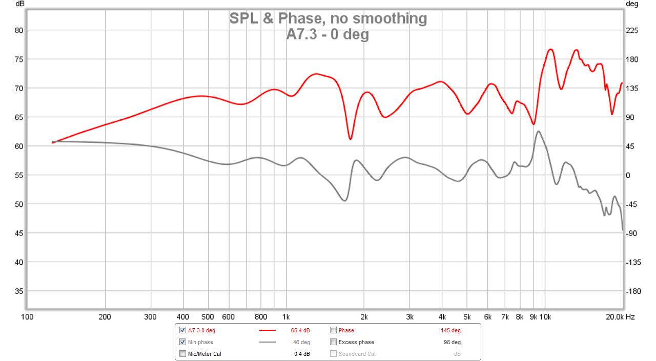

Here is the measured minimum phase variation for the A7.3:
Minimum phase for TC9FD:
The dips and peaks can also affect the imaging coherency of the driver through phase variations that stray from a flat response.

Those impulse responses include the whole room in which the driver was measured so this is not a fair comparison.
