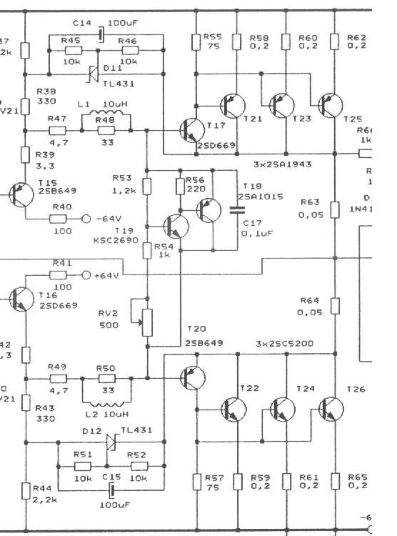

Hi all.
What is the function of: c14,r45,r46,d11 and c15,r51,r52,d12 network. Double bootstrapp?
Thank

Double bootstrapp
Hi all.
Steven said of PL400:
I think the main reason for connecting C11 to the emitter of the driver is that this emitter voltage follows the AC signal on the collector of Q5 much better than the output does, so the voltage across R18 is kept more constant and the collector impedance of Q5 becomes higher and more linear. I think even harmonic distortion is lower because the half wave rectified (class B) non linearity of the voltage across emitter resistors R40, 43, 45 is not fed back.
My questions: the explanation is valid for NAD C-370? Where the botton of double bootstrapp (c14 c15) are connected of the emitter of the drivers - colletors of sziklai output.
And this topology (double bootstrapp in NAD) is valid for EF output?
GEirin
Re: NAD C370
GEirin said:
Hi all.
Thank
GEirin
Yes, it is a double bootstrap. But here the bootstrap serves a different purpose than in the cases where it creates a high collector impedance for the VAS (for high loop gain). In this case the purpose is to create a constant current source for the emitter followers T15,16, that even works a bit beyond the supply lines to drive the amp closer to the supply lines.
The current through T15, 16 is set by (voltage across the TL431 minus a Vbe) / R38,43.

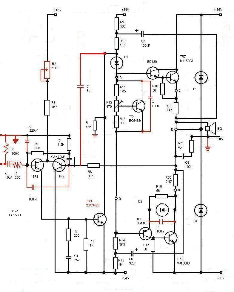

Sorry Steven. Other question.
I´m interested to know the topology the old amplifier attached below.
R9,R10,C7, is bootstrap the VAS TR3?
And R14,R15,C6, is bootstrap a constant current source?
Thank
regards
GEirin
Actually, both bootstraps serve to increase the collector impedance of the VAS. For AC signals both are in parallel; it makes no difference whether the load is connected to the positive supply voltage or the negative supply voltage. The top bootstrap acts as a current source, the bottom one as a current sink. The Vbe multiplier Tr4 is an AC-short circuit between these.
In many (most) amplifiers the VAS (Tr3) is the current sink itself and the bottom bootstrap is not present, i.e. point B of the Vbe multiplier is connected to the collector of Tr3.
In this topology with the double bootstrap the maximum negative output voltage is slightly increased because point B can exceed the negative supply voltage.
Steven

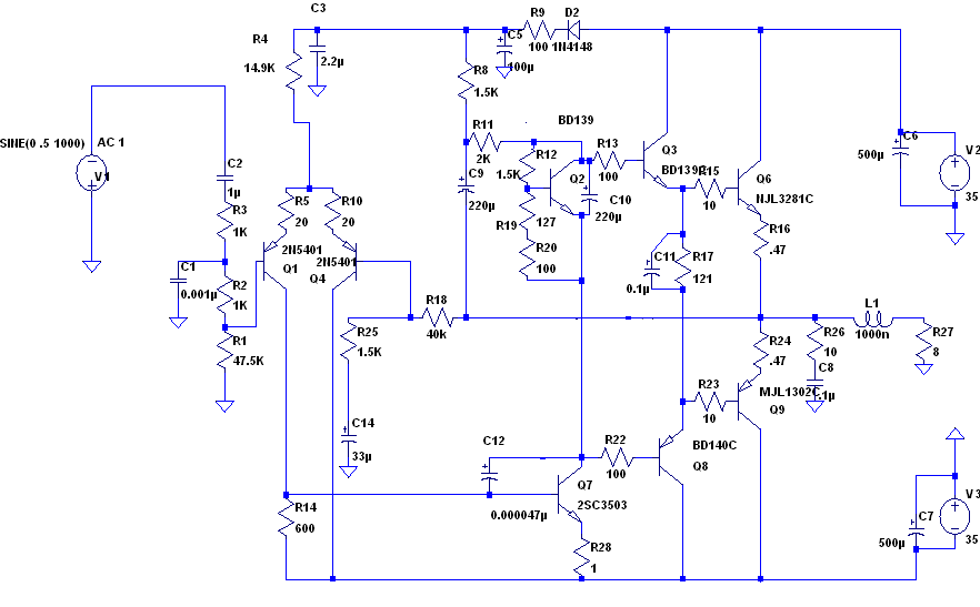

Hi Paul
Connect the collector of the VAS (Q7) to the junction of resistor R11 and R12/BD139 collector (disconnecting from R22 and BD139 emitter). Add the second bootstrap resistors to - rail and BD139 emitter, also still connected to R22.
Unfortunately the upper bootstrap now needs to have half the original values as the current has to double. The new bootstrap can use the resistors R8 and R11 you remove, and C9 connected from centre rail to bootstrap point. Add a new bootstrap capacitor (470uF) to the new R8 and R11 values (680 ohms, 1k for example).
This type of double bootstrap was already published by Mullards but they also added a diode in series with the bias transistor (i.e. between R11/VAS collector and R12/BD139c) for reverse bias protection of Q3.
John
Hi Paul
John
Hi
I can't understand some of your explanations, can you you use my asc file to draw you circuit ?
I include my asc file.
Thanx
Paul
Hi Paul
John
I had modified the .asc file posted in the other thread by tessier as per your instructions above. Is it OK now? Can you kindly correct the Diode position?
--gannaji
Hi
Your second file is right.
THe purpose is twofold. First, in the event of a short circuit, it protects the npn driver from being reverse biased beyond the breakdown limit. Secondly it protects the VAS from excessive current flow since the current will be limited by the upper bootstrap resistors. Though the dissipation in these will be higher, so it is advisable to use higher power resistors in these positions (e.g 2W).
John

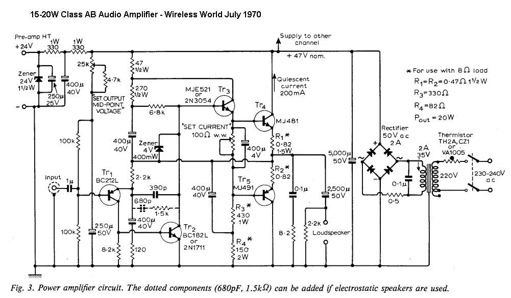

Triple (?) Bootstrap of JLH
Dear John,
Thank you for your kind reply.
In the 15-20 Class AB amp, picture below, the original article in Class A site, (The Class-A Amplifier Site - JLH Class-AB Amplifier) JLLH mentions that
" The first two transistor voltage amplifier stages of this follow conventional design practice, with the collector load resistor of Tr2 boot-strapped to obtain large voltage swing at the base of Tr3 with as little second harmonic distortion as practicable. The collector of Tr3 is also partially boot-strapped in order to reduce the peak voltage swing, and improve the symmetry of the output waveform prior to the application of the loop negative feedback. (Without overall n.f.b. the distortion at full output power is a little less than 4%, almost entirely second harmonic. This is similar to the performance of a good triode valve output stage prior to the application of n.f.b.) The lower end of R3 is also fed with the output signal to improve the output voltage swing obtainable from Tr5."
What are the advantages / disadvantages of JLH method compared to the one above? Can you kindly elaborate for my education only.
--gannaji
