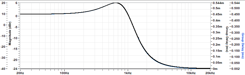

Or going back to a favorite, group delay, LOL. A speaker is minimum phase only in the regions of flat group delay.
A speaker is not minimum phase where group delay is not flat.
Here's a simple two-way electrical summation of LR24's @ 1000Hz.
The region of the group delay's slope and curvature, between say about 200Hz and 5kHz, is NOT minimum phase.
That electrical region, knocks out minimum phase for the speaker for same range, if so crossed.
