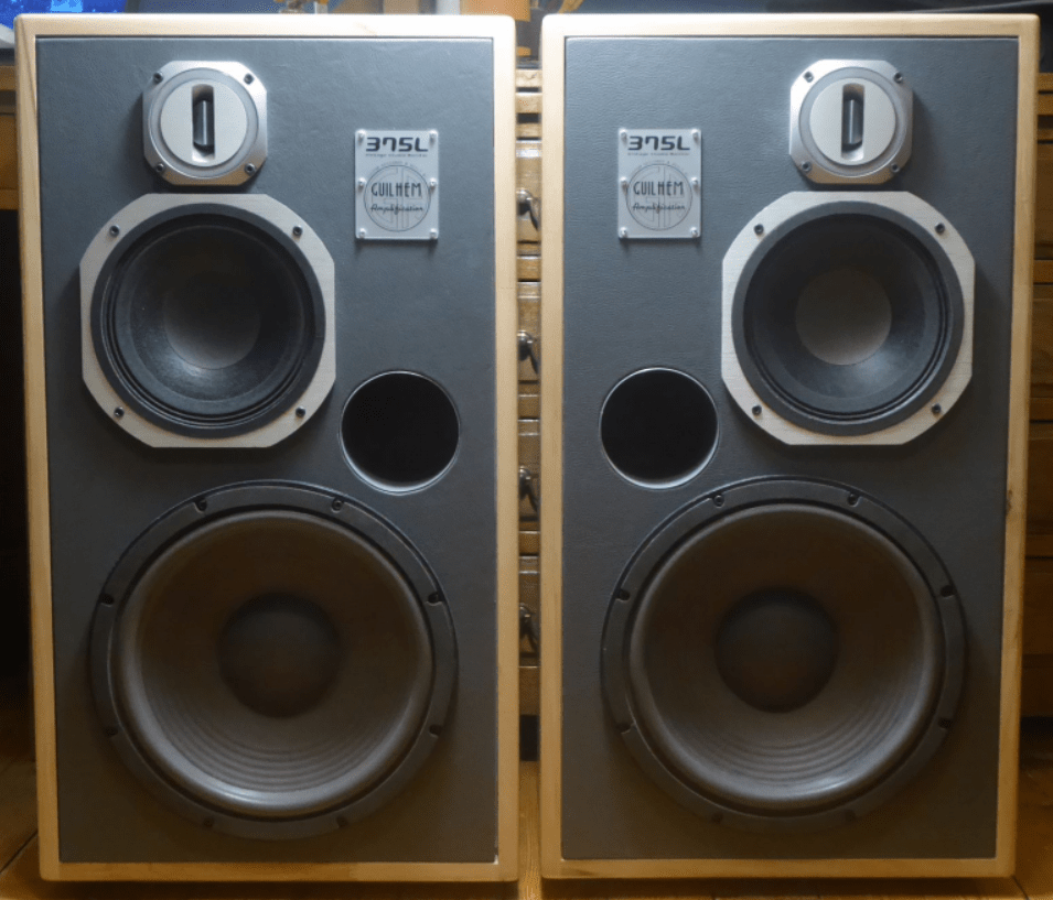

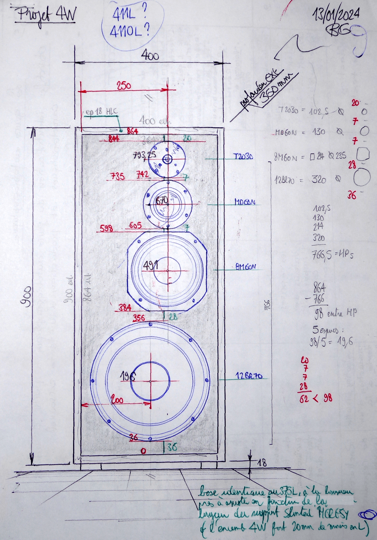

I don't think the sealed box are really out of fashion... But if you want to reach a low bass extension, the enclosure has to be quite wide and built with the suitable Woofer to maintain the QTC=0.71, which represents the optimal compromise between volume / bass extension / linearity / impulse response.
To "rival" my DIY bass-reflex 3-ways 375L, I designed a 4-ways sealed enclosure, using a Beyma 12BR70, still available today :
With a neat VB at 115L, I should reach F3=44Hz, F6=34Hz, F10=24Hz, with the excellent transient and damping characteristics tied to the sealed enclosures...
No prototype is built for the moment, but it will come ! 😉

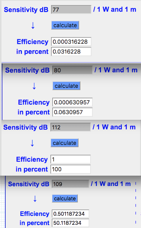

Manufactures seldom use "efficiency", describing a loudspeaker with an 80dB sensitivity at 40Hz as having 0.6% efficiency does not sell well 😉 .All that aside where are efficiency and sensitivity defined? The manufacturers often cloud the two. I would think efficiency should be in percent, 1 watt in .5 watts out is 50%.
Sensitivity is usually defined as on axis SPL in dB at 1 watt electrical input, measured at 1 meter.
A cone loudspeaker’s sensitivity is usually measured using an infinite baffle, a half sphere radiation.
The voltage used is often 2.83 Volts RMS, which is 1 watt into an 8 Ω (nominal) speaker impedance, though that same voltage would be double the power into half the impedance, or half the power into double the impedance.
Since a speaker’s sensitivity and Q (radiation pattern) varies with frequency, a single sensitivity number is not very useful in comparing loudspeakers.
Converting sensitivity to efficiency is possible.
https://sengpielaudio.com/calculator-efficiency.htm
The 0 dB reference level for sound is 10−12 watts.
1 acoustical watt is 120 dBSPL.
The standard measurement for a cone loudspeaker is done with it mounted flush on an infinite baffle radiating into half space at a distance of r = 1 m.
The resultant factor 2π × r2 (area of a half sphere) equals −8 dB. Therefore an efficiency of 1 = 100 % for a sensitivity of 120 − 8 = 112 dB.
This calculation is correct for a loudspeaker radiating in a hemisphere, 2π. Otherwise you must add the Q factor because of directionality.
Spherical radiation Q = 1, hemisphere Q = 2, quarter sphere Q = 4, and eighth sphere Q = 8.
Note that using the above calculation, efficiency of over 100% is possible for high Q devices like narrow coverage horns which can have on axis sensitivity of well over 112dB.
If the horn driver had uniform radiation over a half sphere, it’s efficiency would be under 50%.

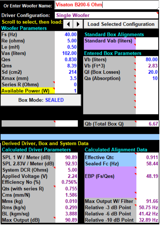

yes exactly. acoustic suspension has the box air spring as the dominant stiffness. The lower the suspension stiffness, the smaller box can be used for the same Qtc and same sensitivity. The ideal sealed woofer has thus a low Qts due to a high compliance suspension. The current paradigm about a high Qts suited for sealed is completely misunderstood. Same with the EBP rule for vented vs sealedI believe the definition of a "true" acoustic suspension is that the driver Vas is >2 times the box volume. You just don't find woofers with the really high compliance that used to be common years ago.
In a day and age of active systems are easy to make and in some cases even cheaper compared to passive filters, it's not all that interesting.The current paradigm about a high Qts suited for sealed is completely misunderstood. Same with the EBP rule for vented vs sealed
Although the truth is, that's also a bit of a simplified explanation if we don't look at other parameters, like apparent power from the amplifier as well as peak voltage from the boost EQ. (Well the last ine will be a cut EQ in this particular case).
I have never noticed the paradigm. It has always been a mix between Qt, VAS and Fs.
But also still ONLY as a very rough rule of thumb.
Just model and simulate it in your favourite software program.
It takes less than 5 minutes to get a first impression.
