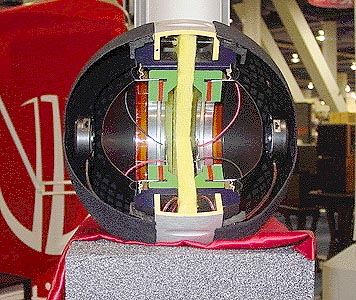

nice looking, but looks like a dipole design, and not omni
now, if they were bipole, and turned 90 degr, maybe they could be called vertical omni directional
well, due to size I concluded that it could not be bipole, but maybe a bit too fast 'logic'
are front and back connected in phase, or out of phase ?
still, I think you need to listen 120-180 degr off axis on driver, to called omni

Dave, my reasoning for saying dipole is that with the drivers mounted almost face to face gives way too little air volume for the bipole configuration
well, according to a test it really is a bipole
Whether it's a dipole or bipole would depend on polarity, not volume.
yes ofcourse
point is, bipole needs a box with volume, just like any other drivers around
and two drivers need twice the volume as one driver
dipole does not need any box
the artistic audio speaker is bipole
and why I posted the picture and asked; where is the box volume
