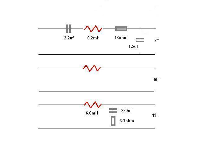

btw, its funny tho that my experiment clearly showed that floor positioned drivers had great and precise imaging/soundstage
and even more funny that singers etc were positioned with the correct height
and that with all sorts of things placed around
furniture, boxes, project, etc
far from optimal
placed close to walls
and below a big bookshelf
probably couldn't be worse
but it still worked
and the 3way xo, even more silly

ah, they forgot how to mount wires and terminal, and just left out a woofer instead
thats clever, considering it costs a fortune
expencive waste scrap
shoot, I did wonder about the size of that 'box', for that many woofers
but maybe they thought; hell, lets make it a ripole instead
No Lars, the design is sort of open baffle. The gaping hole is part of the design.
