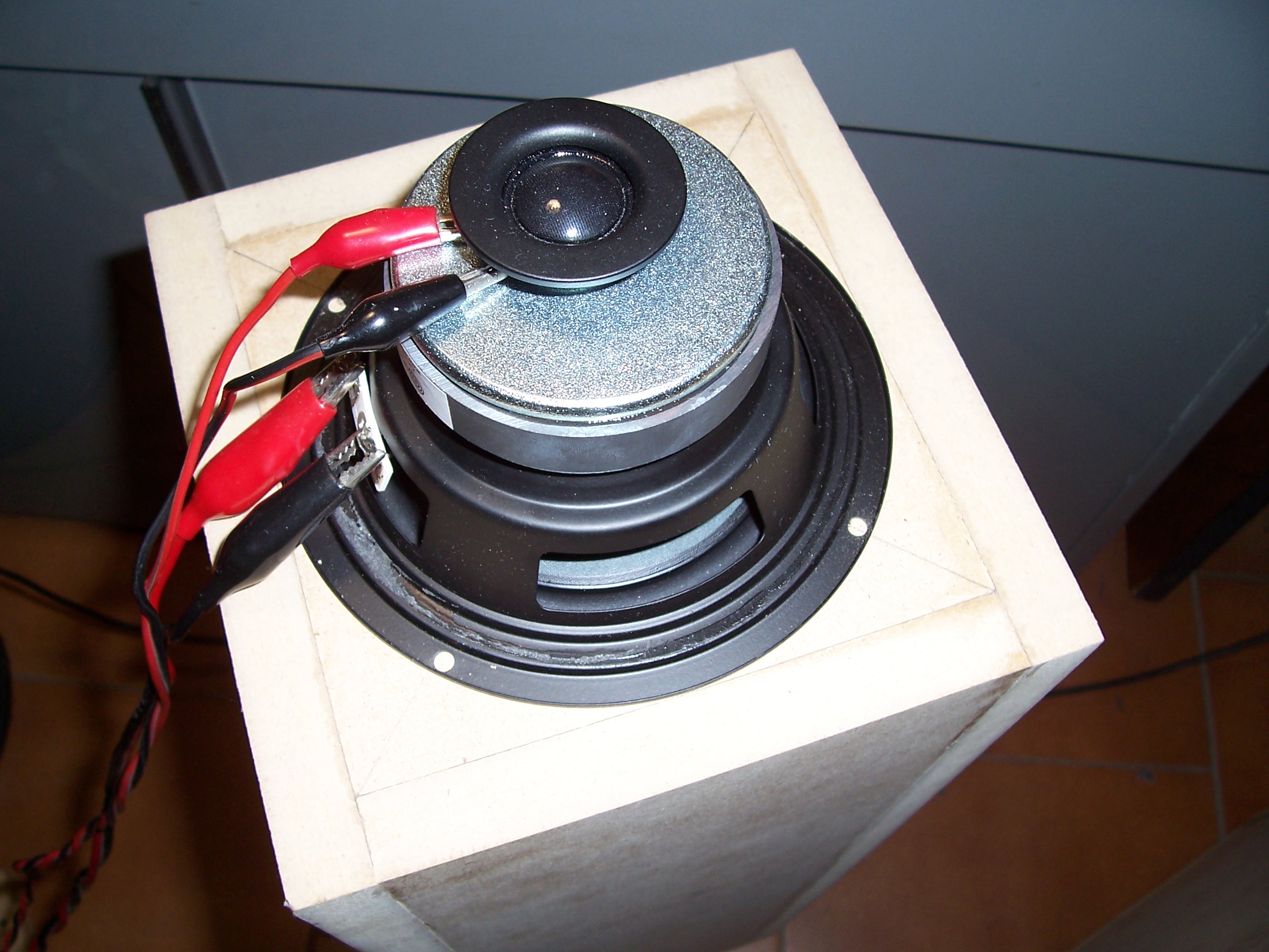

Have you tried mounting the full-range "upside-down"? 😉My woofer is frontfiring and plays to 90 hz. Then I have a 7 inch full range that plays directly up.
Like in these nice little things here.
Can't see the pictures. I have tried to listen to the back side but don't experience that this should have any upsides

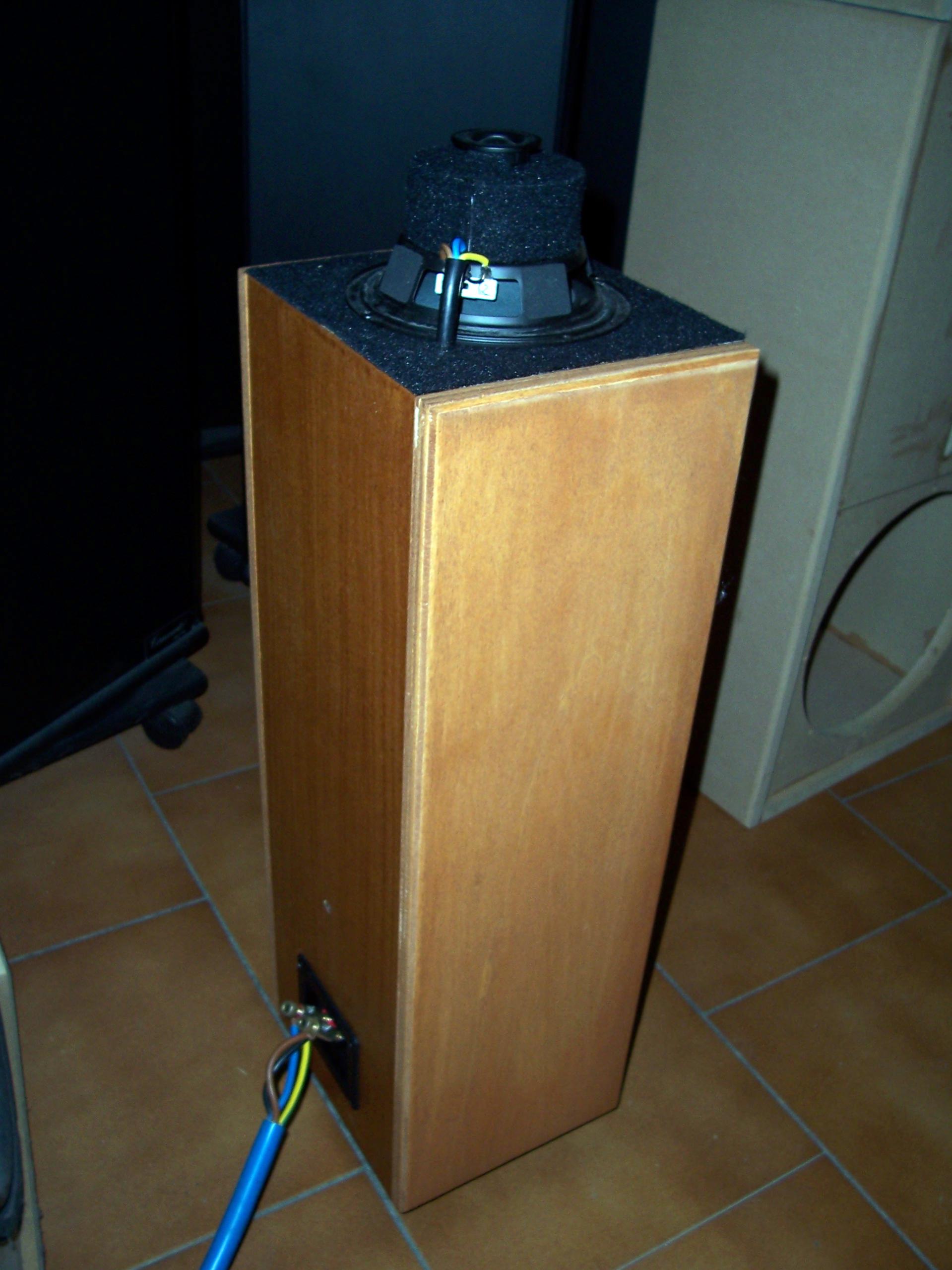

Oh... right, you need to register & login to see images and other attachments. Here is one of the pictures during the first tests of the prototype:Can't see the pictures.
A finished build:
in principle operating the mid-woofer "backward" (upside-down) should give "better" dispersion (more "focused" on the horizontal plane), particularly in the upper part of the range covered by that driver. Whether / how much this is relevant in practice I don't know.I have tried to listen to the back side but don't experience that this should have any upsides
Not better directivity because the motor blocks high frequencies and makes huge diffractions. But perhaps that might be beneficial considering using it as omni...

Ops... sorry. I've tried to cut&paste the image itself, but I guess I've got to link its URL instead. 🙁Your picture links are broken. I get "You are not authorized to download this attachment” (in Italian?).
I can't modify the previous post anymore, so I'll try again here.
Hi, Unix 'n all y'all....*S* And, yes, 'backside' with the magnet structure on top does give improved horizontal/radial dispersion. With the Walsh arrangement, the cone is 'stretched' on it's Y axis, allowing for an improved 'range' of X plane angles. The pics you posted 12/3/18 mirror what one finds under the hood of your typical 'modern' Ohm speaker, with the 'normal' cone face firing into (I assume) a transmission line box....ported at the base....
