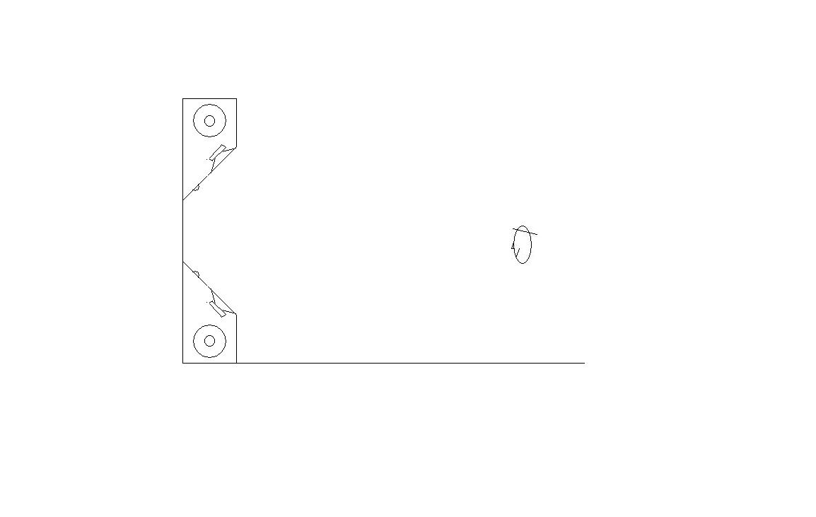

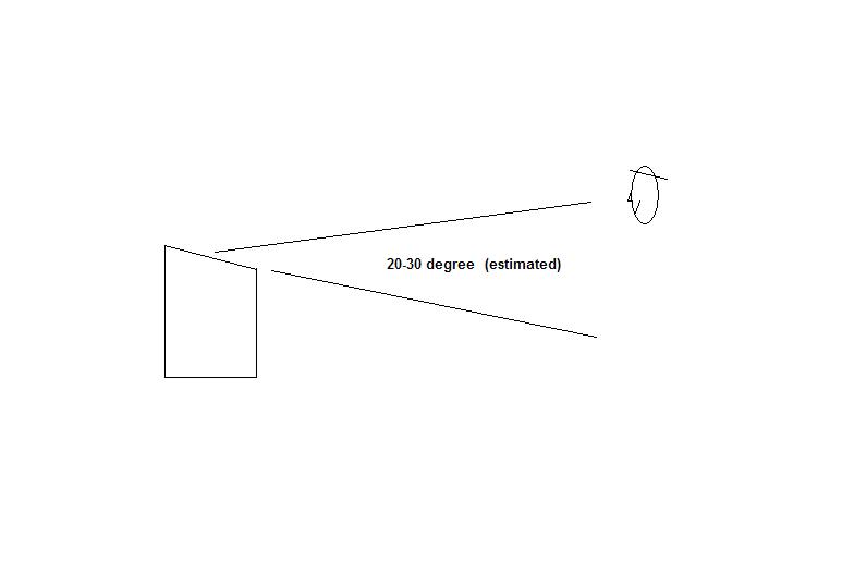

there have been some questions about the possible actual height of such omni design
well, I think it may be related to physical angle of drivers
meaning, a higher placed driver may need to be angled more
and that to avoid diffusors 😉

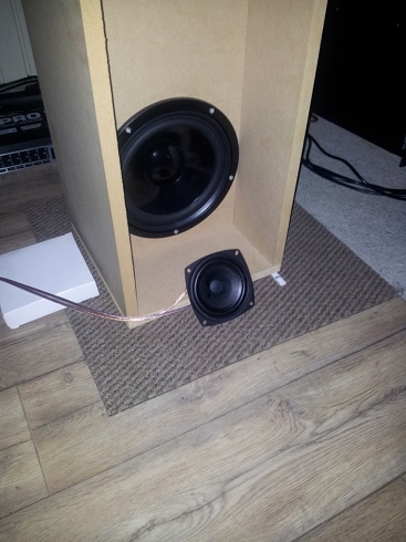

The talk about naked drivers on the floor made me want to experiment with two of the FR10's I got.
Tried them angled and flat on the ground against the front wall, but the best soundstage and height came from placing them at an angle in front of my speakers (about 2 1/4 meter distance from my chair).
What I noticed (at any position in front or next to the speaker) was a strong phantom center and deep, wide soundstage (with the exception of placing the drivers between the speakers, of course not so wide then). As long as the driver could radiate freely I could hear a 3D soundstage.
Height depended on the recording, some were at ear level, others more halfway to the ground. High frequencies were least compromised in height. It only seemed like sound coming directly from the drivers in the horizontal plain took a dive to the floor, anything outside that position had height (I think it has to do with extra distortion from turning up the bass, single instruments were fine).
Thinking about creating two small cubes with FR10's at 5 sides to hear what effect this has.
