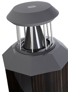

I was looking at the fact that the RAAL omni is built from multiple ribbons, arranged in a circle
it's been clearly stated by others that drivers arranged in a circle is not 'the best way' to achieve omni radiation
maybe all sorts of strange phase related things will happen, I don't know
but seems possible from what we know about 'side by side' arranged drivers
below is a real true omni driver
and really not that much different from any other horisontal mounted driver
It reallly depends how omni you want it to be!
