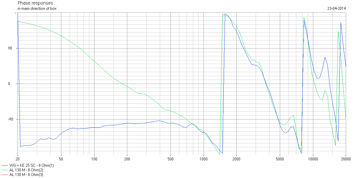

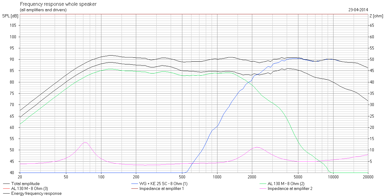

I've tried to model a new filter and have achieve a little higher XO point, but now the phase starts acting up - at least in the simulation.
So what is most important:
  1. Change phase at the same time/frequency ?
  2. keep the same the same between the two (three) drivers)
I how the attached pictures illustrates my point.
I.e. where is it of most importance that the green line meets the blue line?

This is a TMM 2-way, BSC compensated by near-wall placement. If I understand the simulation above right, we see crosspoint between a single midbass and tweeter at 1,8kHz. Parallel midbasses make the upper line and then real acoustic crosspoint of total system is something like 2,2kHz.
Sorry but I don't know passive xo desing well, I can't say anything helpful about phase matching. Is this a Boxsim simulation? Is the effect of waveguide set in the simulation?
All most.
Actually both mid-bass drivers are in the simulation.
Yes it is Boxsim and the waveguide gain is also in the simulation; hence the ~90 dB sensitivity.
In the range where woofer and tweeter contribute to the overall SPL (1 kHz - 4 kHz). The phase in your latest simulation actually looks very good.
I see you now have changed the woofer to AL130M. I would like to verify your simulation results, but you need to give more reliable information regarding woofer model, waveguide model, cabinet dimensions, box volume and baffle layout. A picture would help very much and answer most of the questions.😉

I have thought about using the M-version for a while, as it is more efficient in the upper midrange, so I might as well start doing some simulations with that instead.
I have simulated with both mid-bass driver and it does not make much of a difference in the simulation. Can achieve the same phase response - I know that the real world is somewhat different or at least can be.
Good to hear that I'm not completely off/out of phase ;-)
The box is 60x29x12cm.
The waveguide is the round version - WG 148 R
The amp is an Arcam AVR300 with 100 watts per channel, so that you be enough.
