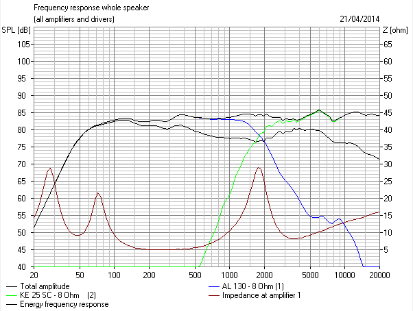

The drivers are two AL-130 and a KE 25 SC tweeter. All Visaton.
They are crossed at about 1,5kHz. The woofer is crossed using a 2nd order filter and the tweeter with a first order.
The tweeter is mounted in a waveguide to get the extra extention in the low end.

A "waveguide" does not likely give extra low end extension, but may increase level by +3 dB or so.
The tweeter's acoustic crossover may be lower or higher than 1500 Hz, measurements would confirm that, but assuming a 1500 Hz crossover, at higher levels when nearing the excursion maximum harmonics will be generated at 3 kHz, 4.5 kHz, 6 kHz, 7.5 kHz, 9 kHz, 10.5 kHz, 12 kHz, etc.

I've heard good things about the KE25SC tweeter. But it is surely going to struggle on a first order filter at 1.5kHz crossover. Looks like the Bijou is a bit bass light, so with the "Fletcher Munson" curve applied would improve at high volume.
Truthfully, I'd guess the tweeter and metal woofer is distorting a lot at high volume. It seems, strangely, like you like that sound. Fs notches, like the one built into the KE25SC don't work that well IMO. They let through a lot of bass into the tweeter. If you think about it, an LCR lets through a lot more subsonics than a coil. Because the capacitor turns the filter into first order at low frequency.
Perhaps you could redesign them for a gentle downward slope overall. They used to call that the BBC slope, and it sounds very smooth. I'd use a third order tweeter filter too if it all works out on phase.

I know of no 1" dome tweeter that can do 1st order electrical at 1.5KHz.
Model it in Visatons free Boxsim program. An Fs impedance notch does
what it does and I can't make any sense of S7's comments at all.
They do work well, its pointless to say they don't, and being a
parallel network, it has no effect on the signal to the tweeter.
Without distortion curves for the tweeter your flying blind.
2KHz 4th order L/R acoustic is as good a target as any.

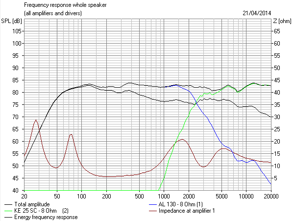

I've already Modeled them in boxsim. Nice program.
Can it tell me anything about the distortion or should I measure that?
I've used REW a little, but haven't found any graph that tells me much about the measures distortion.
Any pointers?

Like I said 2KHz 4th order acoustic is a reasonable
target to sensibly avoid distortion in the treble unit.
And no, sims don't do distortion stuff, except Xmax.
rgds, sreten.

Read my lips. Third order butterworth tweeter filter is better than first order plus FS notch. Less subsonics to cause distortion! 😀
Reasons here: http://www.diyaudio.com/forums/multi-way/97043-elsinore-project-thread-175.html#post3895980
I just ran this past Boxsim using Troels' filter for the similar SEAS W15CY001:
SEAS 5INCH
He uses a much higher crossover. I took it up a tidge myself with a smaller bass capacitor and it all seemed to work. I added a 33R/0.22uF tank to the bass coil to notch the breakup too.
As it goes, I think I had something round 4.7uF/0.4mH/4.7uF for the tweeter which is the correct form for butterworth with a 6R resistor in front.

The Fs notch has nothing to to do with the veracity of the crossover.
1st order is always going to be poor, and unworkable without the
the Fs notch, but still a poor choice. If fitted there is no point in
removing it, and in this case looks to me me 2nd order electrical
can hit near 4th order acoustic L/R around 2KHz.
"Read my lips " ? IMO in this is case very poor exposition,
and trying to make out what you said is something else.
Which doesn't change what you said is nonsense.
