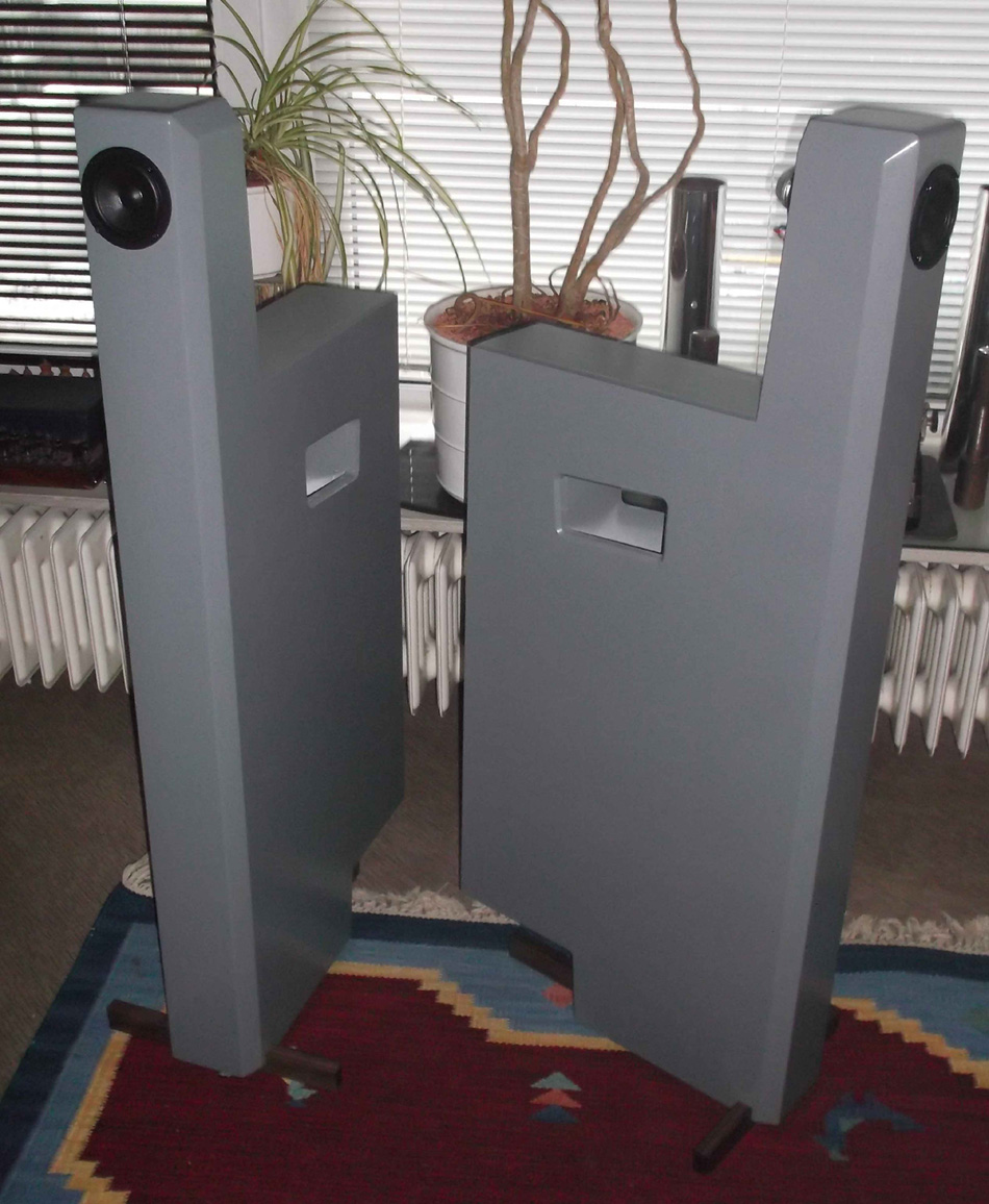

Yes, and I agree with that Bob. But I think bass sounds better on a bigger woofer that can reach deeper. Even though I think the mid range of a 4" sounds better. So the attack part of a kick drum will sound better (generally) on the small diameter driver, but the thump will sound better on the larger woofer. I do believe these can be evaluated independently. Kevin seems to think that isn't possible. I think that's coming from the notion that the music must bring the bass and mids together, which is true. Which is why I'd ultimately take the 4" driver. So far I haven't heard a 3" driver that can do it for me. The ultimately sacrifice to much of the "thump" to satisfy me.
