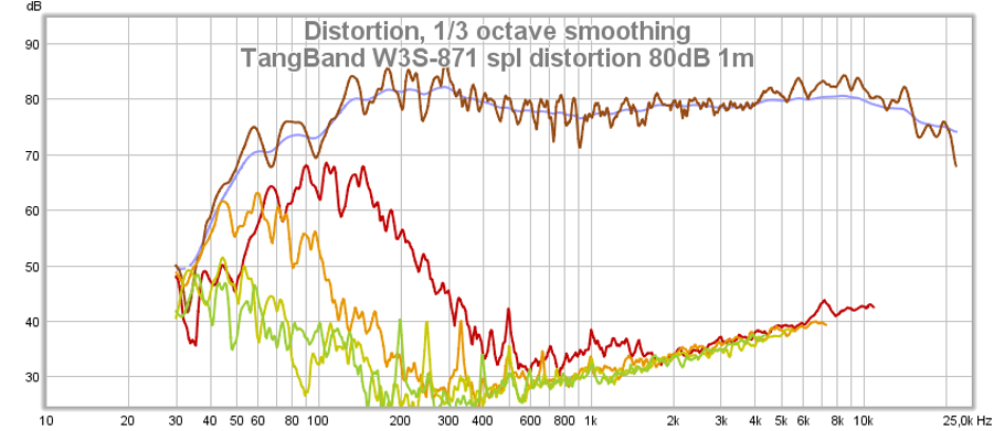

Guys discussing about 3 and 4" bass - please show us some measurements of distortion, tell measuring distance too!
Her is my measurement of Tangband 871-s in 2 liter closed box. Measured with Umik-1 and REW at ~1m. By the way there is huge rise in distortion from 75 to 80dB volume! 70dB at .5meters is too easy to give anything meaningful info!
