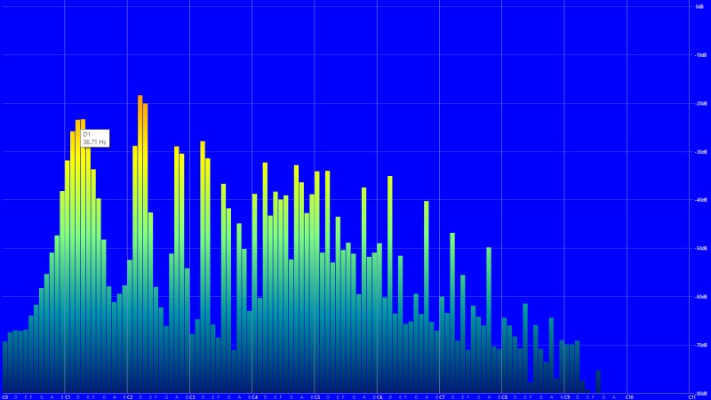

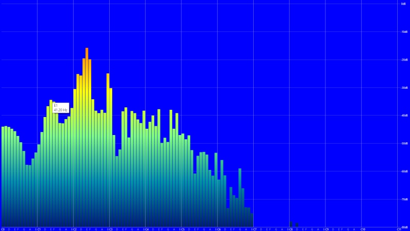

I was listening to some of my favorite test tracks and this thought crossed by mind. It is well known that if the fundamental frequency is missing, but the remainder of the harmonic structure is intact, the brain will reconstruct the missing fundamental and the listener will "hear" the correct frequency. Organ players have known for centuries that if you play C and G in the lowest octave, the listener will "hear" C one octave below. So...
My music player has a third-party plug-in of a spectrum analyser that is based of the actual notes rather than raw frequencies. Very nice.
The first example is a string bass playing the bottom string open and plucked. This is from a track off of the Chesky "Ultimate Demonstration Disc". The frequency in the little white box if you can read it is 41.20Hz. The fundamental is nearly 20dB below the first overtone at 82.4Hz. This is, of course the open E-string, and a perfect example of why string players avoid open strings when possible. However, the bottom line here is that even small speakers can convincingly produce very low notes. (Some one elsewhere posted a spectrum on a 4-string bass guitar. The fundamental was only down 6dB!)
The next example is from the E. Power Biggs recording of the Bach "Toccata and Fugue in d", the bottom on the opening flourish. The frequency is 38.7Hz. Now here, the fundamental is about 5dB down, and the harmonic is doubled with another pipe. This is going to be a bit harder for a small speaker to produce convincingly, and for sure you will not feel the note.

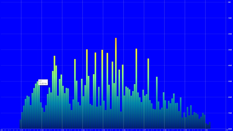

The last example is why you really need a good sub to reproduce a good recording. The bottom note at 55Hz is not played by any instrument. It is a room resonance in the concert hall and not harmonically related to the music. The real bottom note is G2 and 98Hz, a bassoon, BTW. Resonances like this are always present in concert hall recordings, as apposed to multitrack studio recordings.
