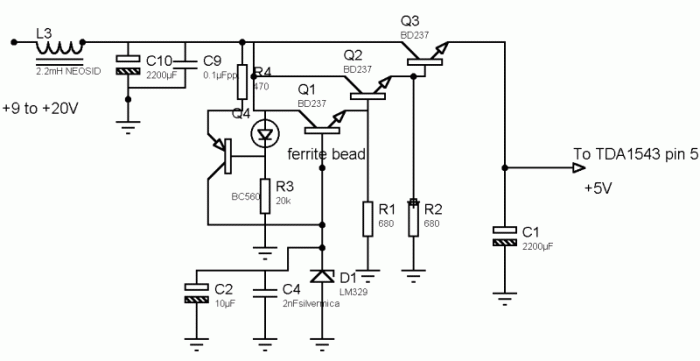

Re: Further Improved Poer supply
Elso, you could swap D1 and C3 and put a resistor in between to filter the noise from the voltage reference.
Elso Kwak said:
Hi All,
Attached is a further improved powersupply circuit.
The red LED and the PNP transistor provide a 2mA constant current source for the LM329. The red LED is used as a 1.6V reference providing a 1V drop across the 470 Ohm resistor in the emittor lead.
This circuit also works with four green LED's, in a series string, in place of the LM329 but sound is better with the circuit as depicted.
I also did some experiments with LT1021-5 and MAX 6250. These are expensive low-noise 5V references. I amplified the 5V to 6.9V with a OP27 and connected this to the base of Q1. Sound is definitely different but I am not sure it is better. It has a kind of inflated quality just as the sound of commercials on our national television.😕 Also more fatigueing.😕 I keep lowering the volume, not a good sign...😱
Re: Re: Re: Further Improved Power supply
Elso,
It may not be critical for the circuit you have designed but from a point of elegance, the addition of a resistor and swapping D1 and C3 could significantly reduce the 75nV/sq.root-Hz reference noise.
I mean you have got the capacitors there in the first place, why brute force filter the reference when you can add a litle more finesse with a resistor and be more gentle to your reference.
As I said, low noise may not be your ultimate goal but it is there for the taking and may be beneficial for other designs.
Regards, Craig.
Elso Kwak said:
Hi Craig,
Noise is not a issue.😉

Re: Improved (?) Circuit Correction of Drawing Error
Elso Kwak said:
I just got a email pointing me at a stupid drawing error. As the shaded part of the electrolytics is the minus side these have to be connected to ground of course.
I apologise.
:blush: :blush:
Attached (hopefully) the corrected schematic.:bigeyes:
