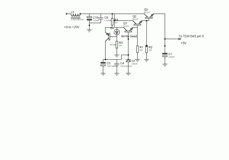

Further Improved Poer supply
Hi All,
Attached is a further improved powersupply circuit.
The red LED and the PNP transistor provide a 2mA constant current source for the LM329. The red LED is used as a 1.6V reference providing a 1V drop across the 470 Ohm resistor in the emittor lead.
This circuit also works with four green LED's, in a series string, in place of the LM329 but sound is better with the circuit as depicted.
I also did some experiments with LT1021-5 and MAX 6250. These are expensive low-noise 5V references. I amplified the 5V to 6.9V with a OP27 and connected this to the base of Q1. Sound is definitely different but I am not sure it is better. It has a kind of inflated quality just as the sound of commercials on our national television.😕 Also more fatigueing.😕 I keep lowering the volume, not a good sign...😱
Hi Elso,
What is the reason you are still using a “triplet”? The output impedance is mainly defined by the current flowing out of the emitter of Q3. For this reason the circuit should have a minimum standing load current of over 10mA to 25mA. So it is wise to add a load resistance of 220 ohms to the output. Or does the supply modulation due to the high output impedance + varying load current add to the sonic qualities of the circuit? And why are you loading the driving transistors to ground? (R1 and R3). A resistor between the base and the emitter is a more efficient way. I don’s see any advantages over a normal darlington build with a BC649 and a BD135 (See my pervious posted circuit). Your circuit is still spitting out the excessive noise of the reference zener directly. Take rid of it at the origin: the zener itself and not by large output caps.
Feeding the zener by a current source only reduces ripple, but not noise
According to some sources /LC Audio/ the noise in the power rail can seriously damage the sound due to inducting jitter in the clock generator. You, Patwen, can check this out by a connecting a passive RC filter right in front of the Clock generator IC /and before that check which it is/ os, say, 10-100ohms and 1000-2200uF, depending on consumption. Please reply to me if you find something true in this! 10-x
