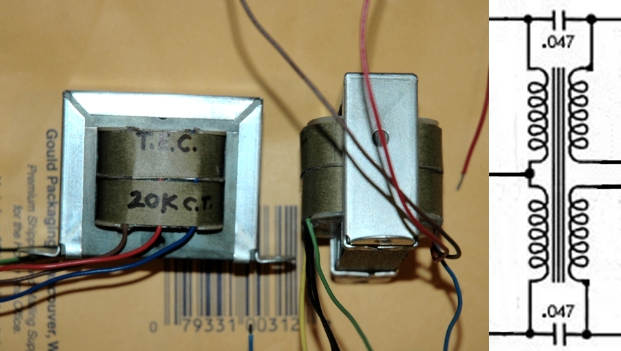

And, no interstage transformers are not a "gimme" at all. Go ahead and show me the commercially available interstage that really does work well. Show me one that really permits the wide bandwidth that the typical McIntosh amp is able to acheive? Not so easy, not so simple. One of the problems is that the grid of a tube that runs into AB2 is not such a nice simple load.

Please see it in the right perspective; compared with the more or less complex output transformers the interstage transformers are not. If you could live with some 150kHz with for instance an ECC99 driver tube you could try me....
Driving a tube which runs into AB2 is exactly where interstage transformers excel! "Not such a simple load" - grid current: the low DCR secondary of the interstage transformer is much better here than a highish fixed input resistor.

Hands down the hardest transformer to design in audio. The balance between capacitive coupling, capacitive loss and amount of inductance required, eliminates any sort of universal design. The worst are push pull to push pull and the easiest are single ended to push pull. The tiniest sort of changes can cause a minus 6 db at 12kHz to change to a plus 6 db at 35kHz.

No step down; just 1:1.
The comparison with the "fixed resistor" is because the interstage secondary replaces the 50k, 100k or whatever input resistor of the next (mostly power) stage. The secondary DCR can be some some 200, 400 or 600 ohms, and that is why it is working that well with grid current situations for tubes switching from A1 to A2.
