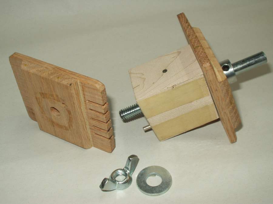

Incidentally, here is a picture of what we have found to be the easiest, least expensive, most durable and least offensive style of rectangular/square winding form mounting arbor.
Materials are a carriage bolt in a convenient size, along with washer, wing nut set screw collar and two tapered metal pins or rolled pins. The form is made from pieces of oak glued together and sanded to size with a hole drilled through the center that fits the carriage bolt exactly.
The end plates are made from thin oak with the thick portion grain running across the grain of the slotted plate. The carriage bolt head is cut off and the assembly is mounted into the predrilled block of wood. A hole is drilled for the rolled or tapered pin through the block of wood and into the carriage bolt and a pin is driven in. Another pin hole is drilled through the outer end plate, into the block of wood and a second rolled pin is inserted into the block of wood.
These work better than metal arbors as the wood is softer to intruding fingers and the end plates don't flash as they revolve.
