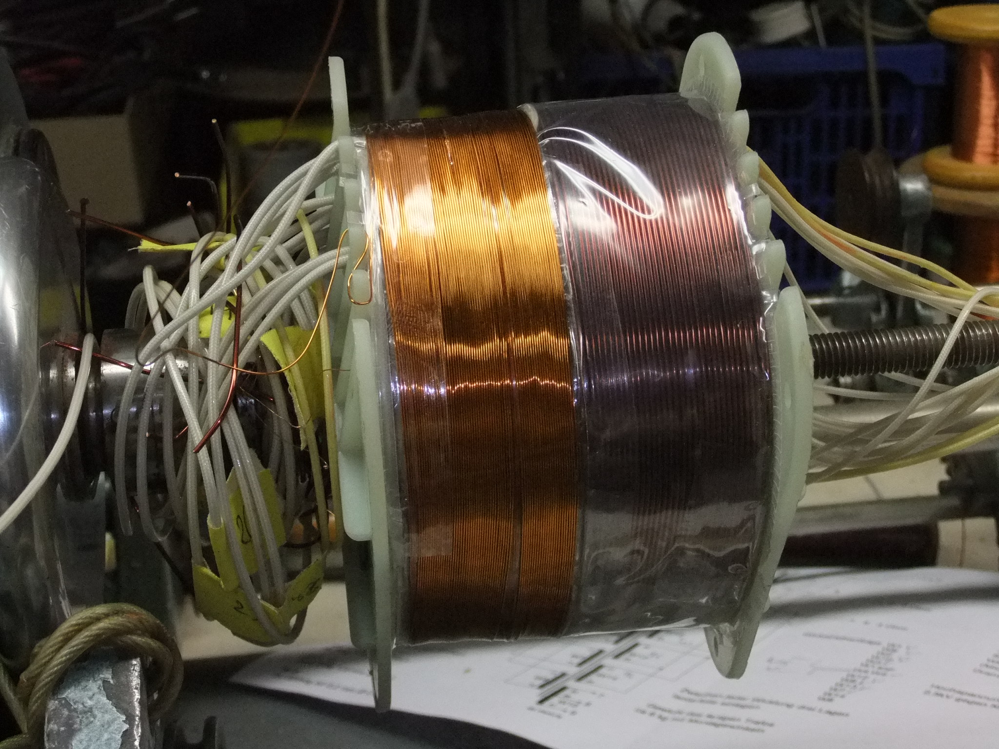

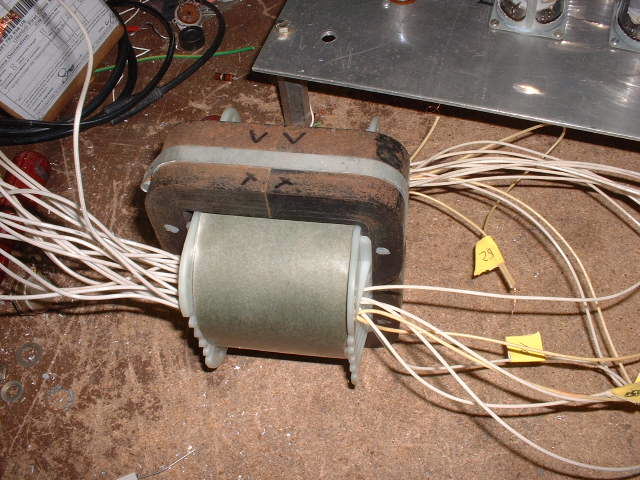

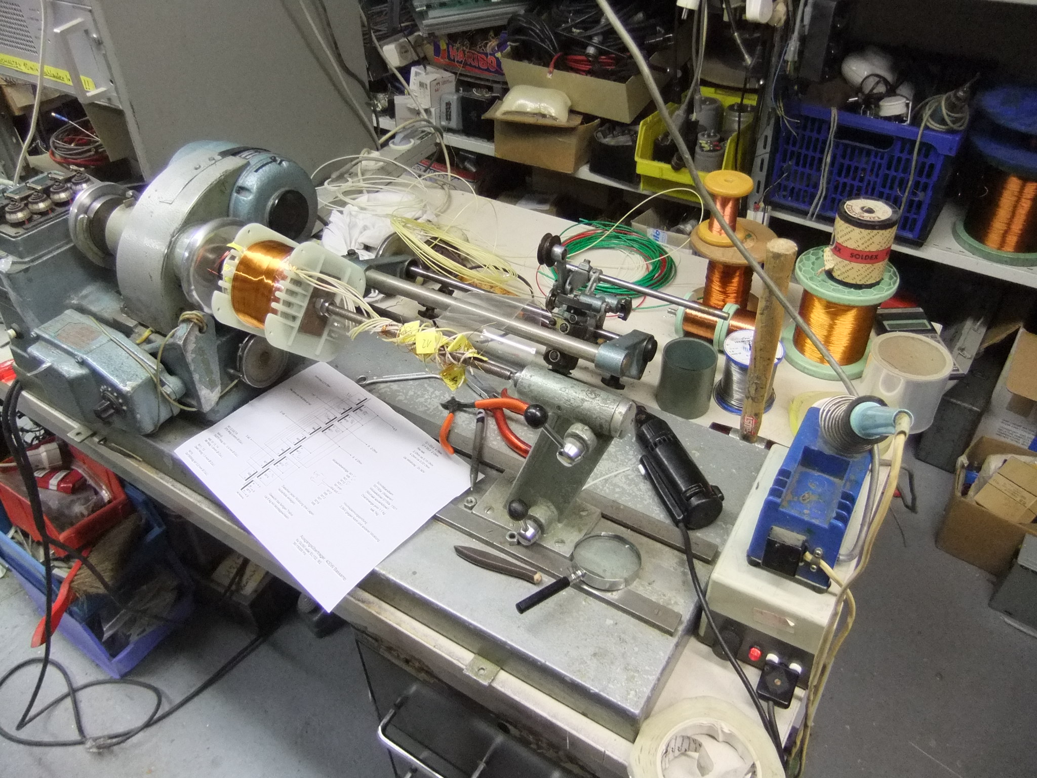

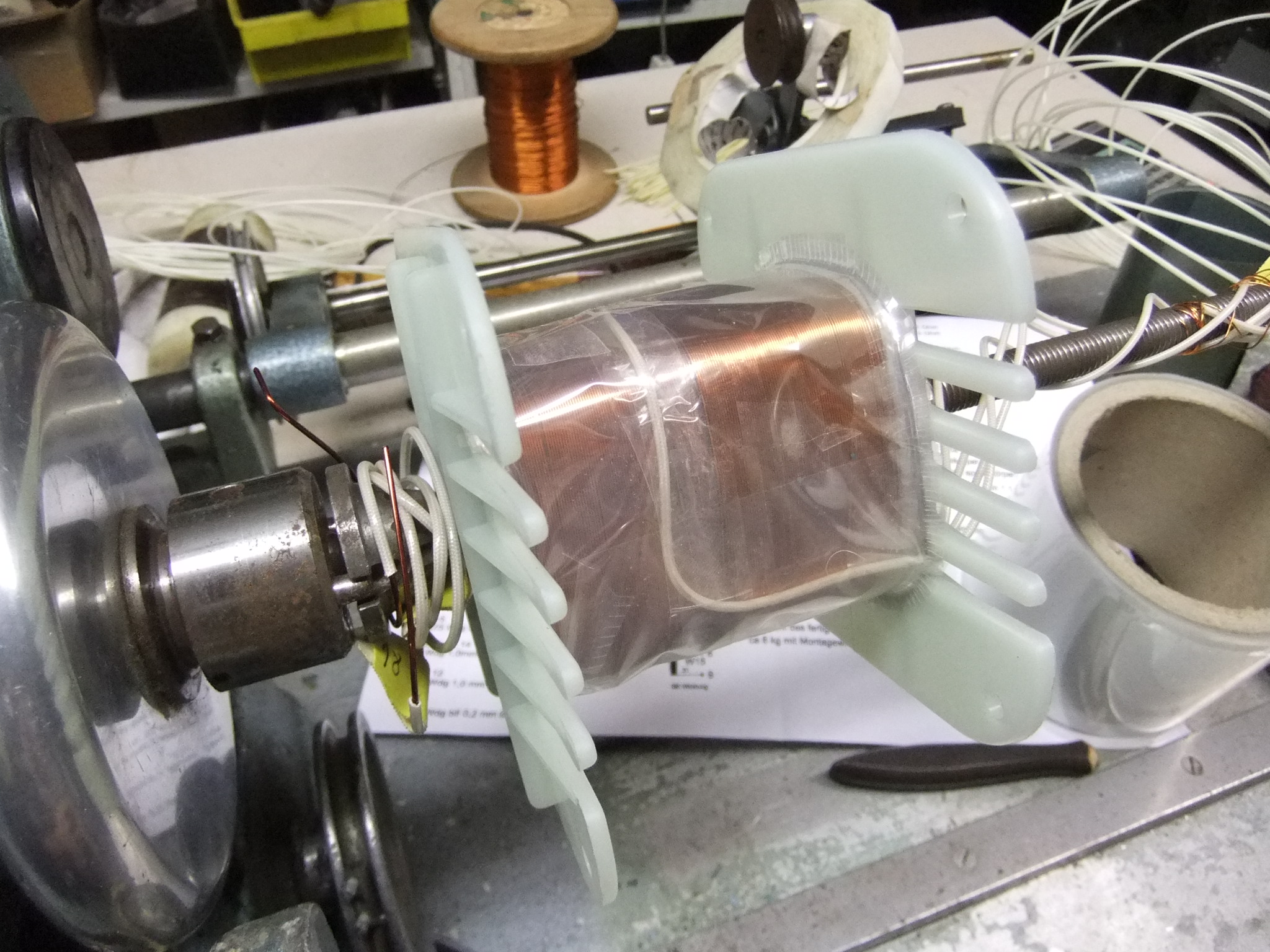

Hi Folks,
I´m late here. I had wound many transformers in the past. All wind by hand. Most of these are power or inverter trafos with low numbers of turns.
Since I came across with an old winding machine I wound opts and high voltage power trafos.
here some pics of my homebrew trafos:
upper row, left to right: homebrew MC-3500 opt, Coil former on winding machine, 400W opt for bass amp with 6 GU50, coil former of on the winding machine, ditto,
lower row: coil former nearly finished.
