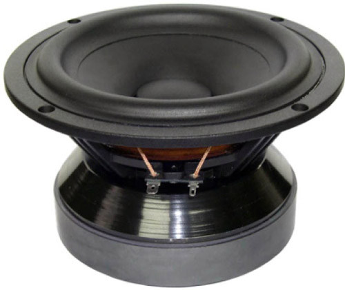

In the driver vault HD data the Lambda underhung TD15LO shows lower 2nd and 3rd harmonic distortion than the well over hung TD15X, but higher 4th and 5th harmonic distortion, ....
But did you see the rising HD towards the LF (<100Hz) of the underhung TD15LO?

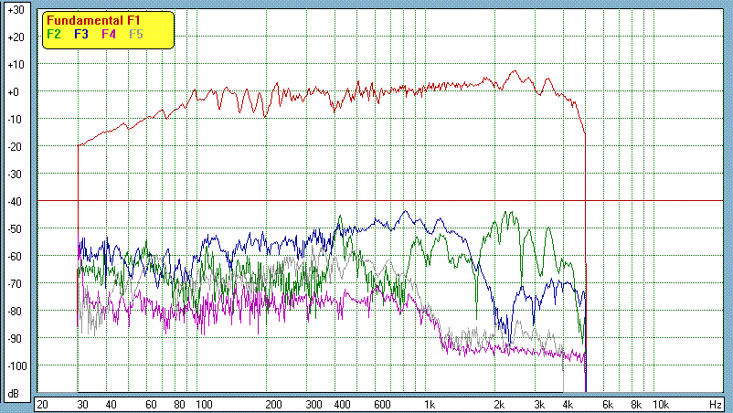

OTOH, the overhung motors show more consistent results. This is the HD of Eminence Kappalite 3012HO, (pretty good I guess):
But did you see the rising HD towards the LF (<100Hz) of the underhung TD15LO?:

I believe the TD15LO is designed as a 15" midbass to be used down to 100-200Hz as a special build for Lynn Olsen. Lynn liked the sound of the Altec underhung motor and wanted to see if a Lambda could surpass the simplier Altec motors. It has the TD15_Dipole underhung motor and short voice coil, with the TD15M pleated surround cone. For this design, the rising HD under 100Hz would be expected.
Even the TD15M with a overhung motor is designed to be used in a 3-way. Sometimes over the new 18" woofer.

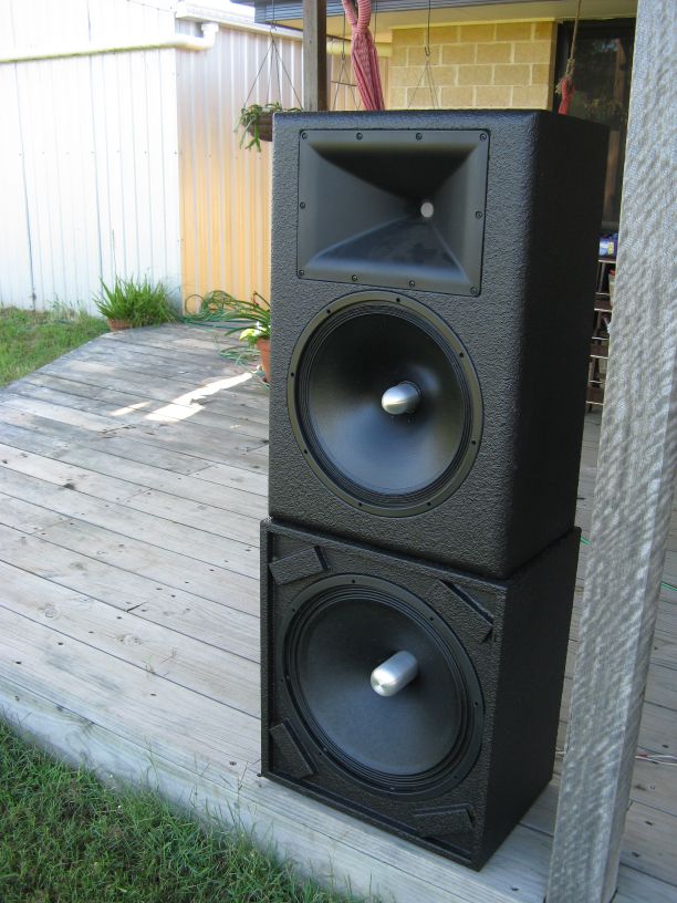

Very nice!! The TD12M doesnt go low at all. I have TD12S drivers too so I could build again just like yours. I like that horn, Was it custom built? Do you have a build thread?
Hi Doug, a friend and I designed and built them. They are Tractrix flairs driven by JBL 2445 compression drivers with TrueXtent barrilyum (S) diaphragms. The whole speaker is flat from 25hz or so to 20khz. The lambda in the ones in the pix are TD15X which go lower than the Ms and are 3db less effiencent. I am still on the fence about using the M or X, but I have great subwoofers so I don't need to go that low.

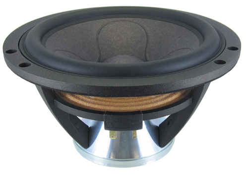

John (AEspeakers) recommends the M series if you want to go higher then 500Hz since it has different surrounds with almost no resonance vs the S, X, H series. The foam surrounds on those designs have resonance higher up the frequency range and create big dips at I believe 1KHz.
Thanks Doug. I'd not gotten that far in my research. I'd hate to screw with the upper mid bass as that is where they shine.
I think it's more useful to look at the HD sweeps. I had the same concerns with the TD12M's Xmax numbers but I realized that the HD rises rapidly below 80 Hz. Brandon's Xmax test is done at Fs where the distortion is quite high even with small signals. Use them above 80 Hz as they are intended and both the M series and the LO series are excellent performers.Don't get me wrong. I admire AE's drivers very much and appreciate their effort in making good quality dirvers. It's now the underhang motor confuses me.

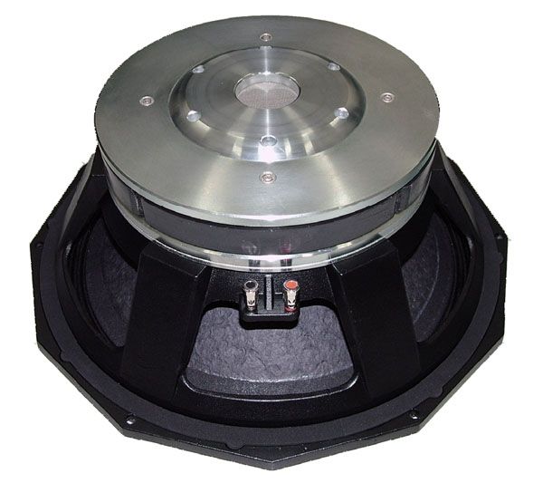

Precision Devices 15' bass
Hi all,
I have not had a chance to listen to any of the AE drivers in my own system yet but I really like the look of the 15M on paper.
What I can tell you for sure is that the bass performance from the PD 1550 and the mid bass / low midrange performance of the PD 158 drivers is the best I have experienced.
On the spec front it’s very difficult, sometimes impossible to draw meaningful comparisons between different manufacturers data sheets and / or different independent testers results.
For example the 2nd and 3rd harmonic distortion of the 1550 is quoted as
" below 1% " but that is at OVER 117dB at 1 m...! Or 60 watts i.e. 10% of AES rated power.
Also worthy of note is that very few manufacturers ( Precision Devices are one of the few ) who adhere to the demanding AES reference measurement practices. Many drivers which boast " huge spec " crumble when asked to meet the AES standard....
