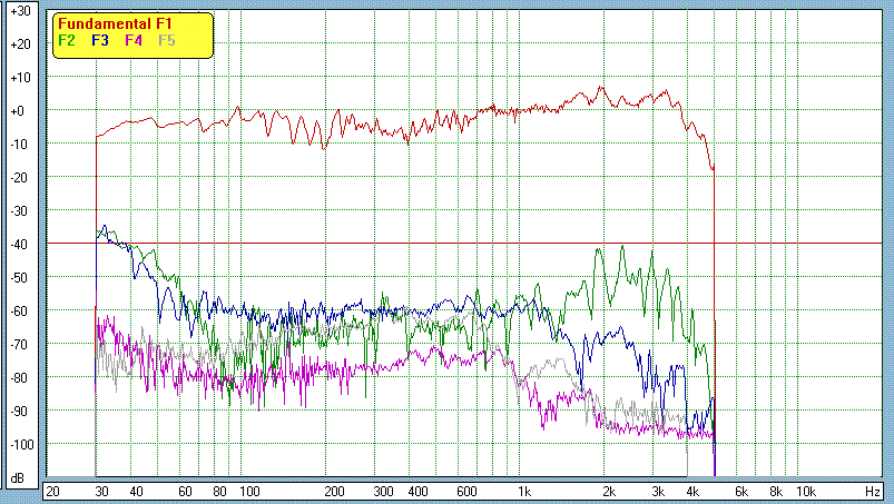

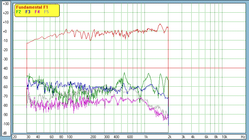

(5) Looking at your graphs is interesting. First, these graphs ( and of course the whole paper ) are based on a small 6.6 inch bass / mid driver ( more midrange as its over 10dB down at 60 Hz...), not a serious 12, 15 or 18 inch driver as is the subject of this whole thread... Regardless of that, frequency response first: Does this not say it all, there is almost no difference at all when you ( 78% ) increase the Le ( green trace ) compared to the raw driver ( red trace )? You regularly see far more discrepancy with driver to driver tolerance... only in the last octave of its range at around 2.5KHz to 3.5Khz is there ANY difference at all, and here it is still within a typical plus or minus 2 dB tolerance. PLUS look at the 100% increase in mass driver ( the blue trace ) it, according to your graph, out performs ( greater efficiency) both the raw driver and the high Le driver above 1,800Hz and has exactly the same high frequency extension as your reference driver...! I really am doubtful of these experiments, sorry but they don’t add up.
These of course are not my graphs. Adire was pretty much a direct competitor for a number of years. That doesn't change the fact that the findings of the paper shed some good insight into this. This also shows a quite small change in Le. Yes, 78% may seem large but I have seen drivers that will vary as much as 500% over their full travel.
Again, here is something more typical in the top curve here of a driver that has a typical S shaped Le curve. If you planned to take that driver to 500hz, 1KHz, etc, do you think the difference in response would have an issue with the implementation of the crossover?
The laws of physics do not know what size the driver is. They apply to all drivers.
