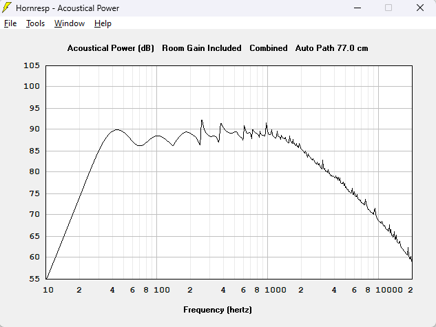

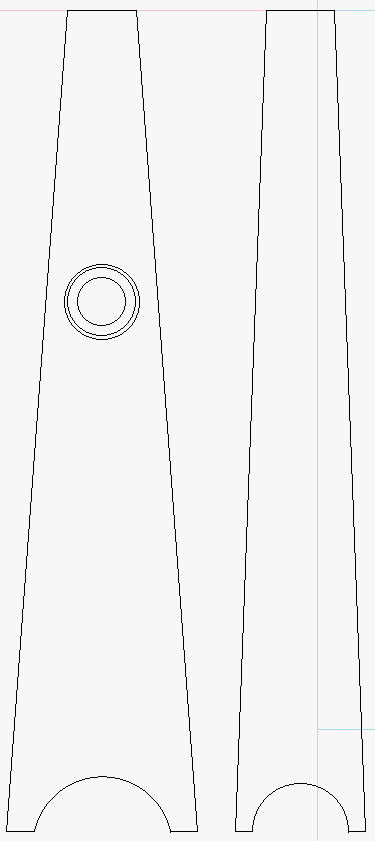

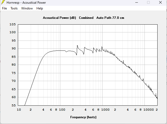

I'll post pictures once I build them, but I've been modeling various alignments in hornresp. First inspired by this alignment table and tweaking for response and aesthetics, I landed on:
L= 142 cm (`56")
Zd= 54cm (21.15")
So= 113 cm^2 (17.5 sq in)
Sl= 697 cm^2 (108 sq in)
Tuned to 40Hz
Total volume (remember, it's a bipole) is 52L
Factoring in the legs the driver will be at a height of 38-39" off the ground. That's at a null in the harmonics, but not the best one (which would have the driver lower)
A drawing to scale looks like:
.. and the response in hornresp looks like
.. and with estimated room gain based (it's a a large open area for living and dining room, almost 65 m^2, or 700 sq ft), rough ballpark in-room response might look plausibly something like:
This has a little less volume (per driver) than the Bluebuck. It has a slightly softer roll off at lower frequencies, but it looks close enough that based on Leif's observations I'm optimistic it'll return great results

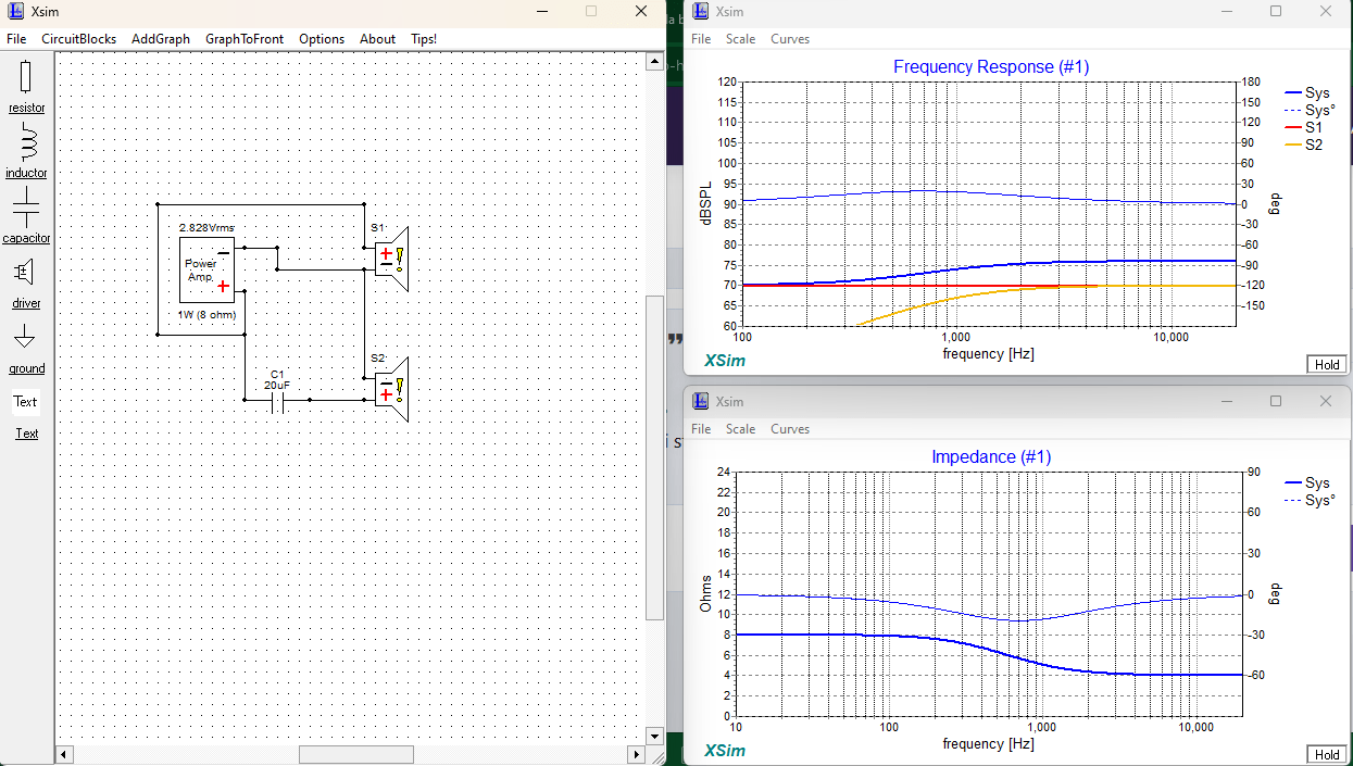

I'm a little confused in here (and a little off topic but wasn't sure to revive an old thread),
Ended up with 4 TG9's 4 ohms
when making a 1.5, the second driver is HP or LP?
I thought one would make it LP for BSC but then i stumbled upon Nola Brio Trio clone thread and it seems otherwise...
