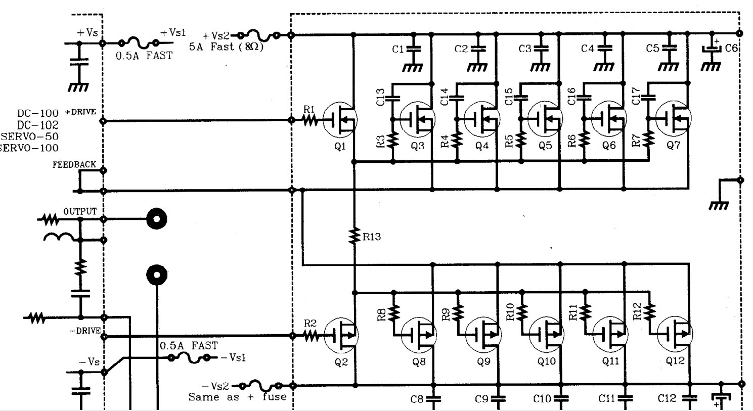

I was about to give up and did a final search on lateral mosfet schematics and found none with a 33pF cap from rail to Gate on any production amp except this White Audio. So what do you do but despiser one leg off the mosfet and bend it out of the way. What happened - <5mV offset on both channels now, this is down from 55-70mV and would go up to >100mV with the inputs shorted or connected to a source (tried CD, MP3, iPhone and HT pre-amp and they all have high offset)
So all is well that end well - I have biased to 120mA per mosfet across the 0.47r source resistors I added and the amp powers on, idles up nicely and plays music.

So your amp had gate-drain 33pF caps tacked in? At each of the each of the 12 output FETs?
Do you think the amp may have been oscillating and removing the caps cured?
Thanks. And again congrats.
Yes exactly - gate/source 39pF caps (CGO), my amp has 4-or outputs not 5-or like the OP. Otherwise identical design.
I assume it was oscillating but only causing bias fluctuations on the right channel, otherwise DC offset issue on both channels.
Weird symptoms and can only assume that these caps were added when the previous owner had the amp re-capped and possibly why he sold it (hum, hiss and distortion complaints).
Well that's interesting especially given the fact that the amp I was working on had no capacitors. There are some production designs that used rail to gate caps. The Borbely audio Servo amps used them but only on the positive rail, see attached picture, they were 39pF. Also the later Hafler Transnova 9300/9500 amps used a single 22pF from rail to gate. Did you happen to test the caps that were pulled? I'm wondering if one of them had failed.
At any rate, I'm glad you got it sorted out.

I mis-spoke earlier - the caps are 39pF and go from Pin 1 (on output) to Pin 3 (on board) on the N-channel (k1058) side of the outputs, so Gate to Drain. I did have a couple that broke in half when I was untacking them from the outputs, but unsure if that was me being careless with the soldering iron, or they were in fact already broken. They are very small COGs likely not more than 100V, so highly possible I melted them with a careless touch.
I originally replaced the two that fell apart on the right channel, replaced all of them with 22pF and 200V parts I have on hand so they would all match. There was no change, so I opted to unsolder one leg (Gate) and leave attached to the Drain part of the board. Easy enough to replicate on the Left channel because those 1058 outputs are on the top of the heatsink (right channel they are on the bottom), so I could do it without taking anything apart.

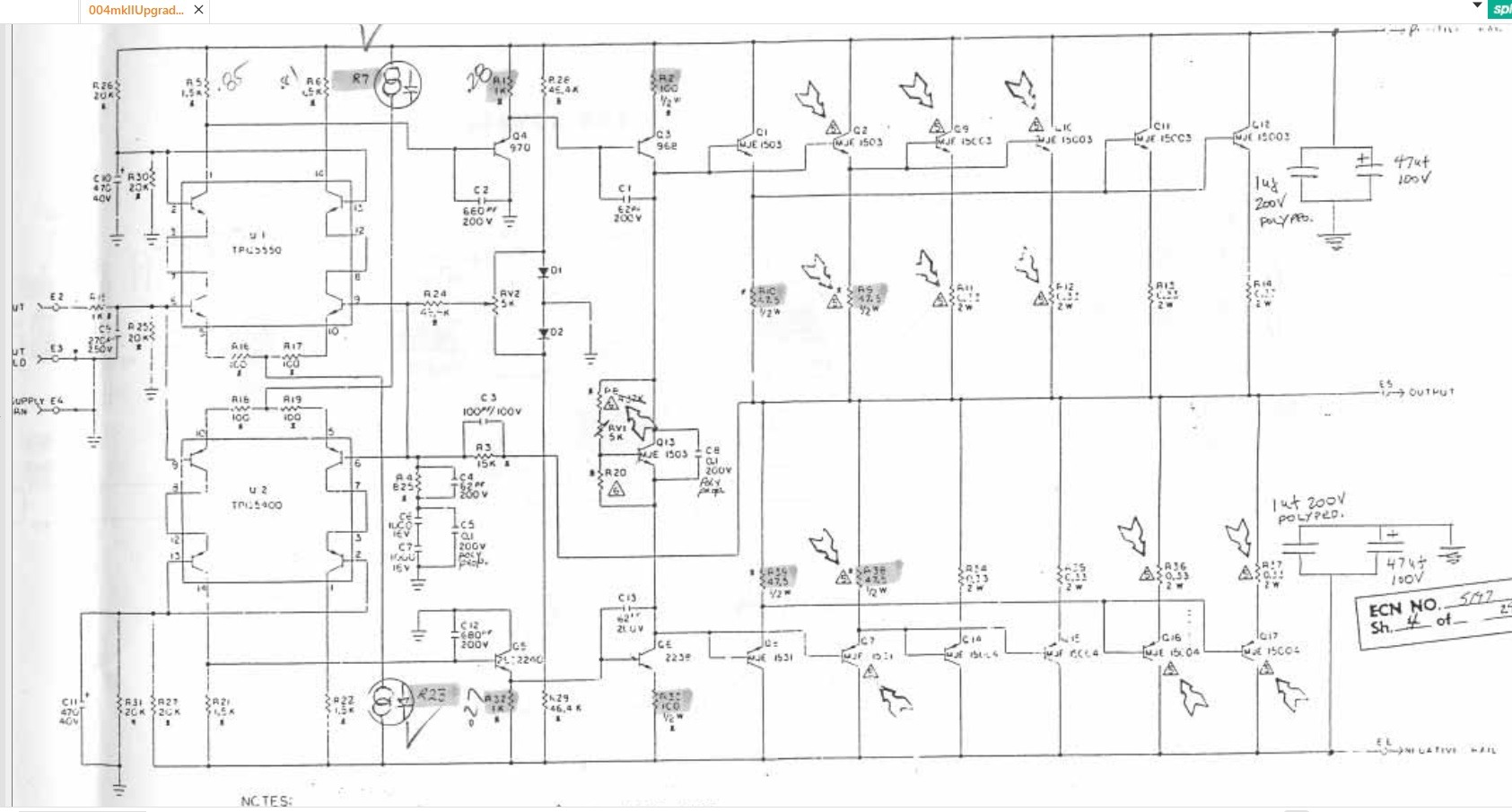

For offset adjustment a simple offset trimmer can be added using a resistive divider between the DC rails and a pair of diodes to limit the adjustable voltage. See the attached schematic of the Aragon 4004 which uses this type of simple offset adjustment. R28, R29, D1, D2, R24, and RV2 are the components you'd need to add.
However the offset would have to be much higher, well above 100mV, before I'd consider doing this. If you put your amp on an analyzer you'll not measure any more distortion with 70mV than you do with 5mV.

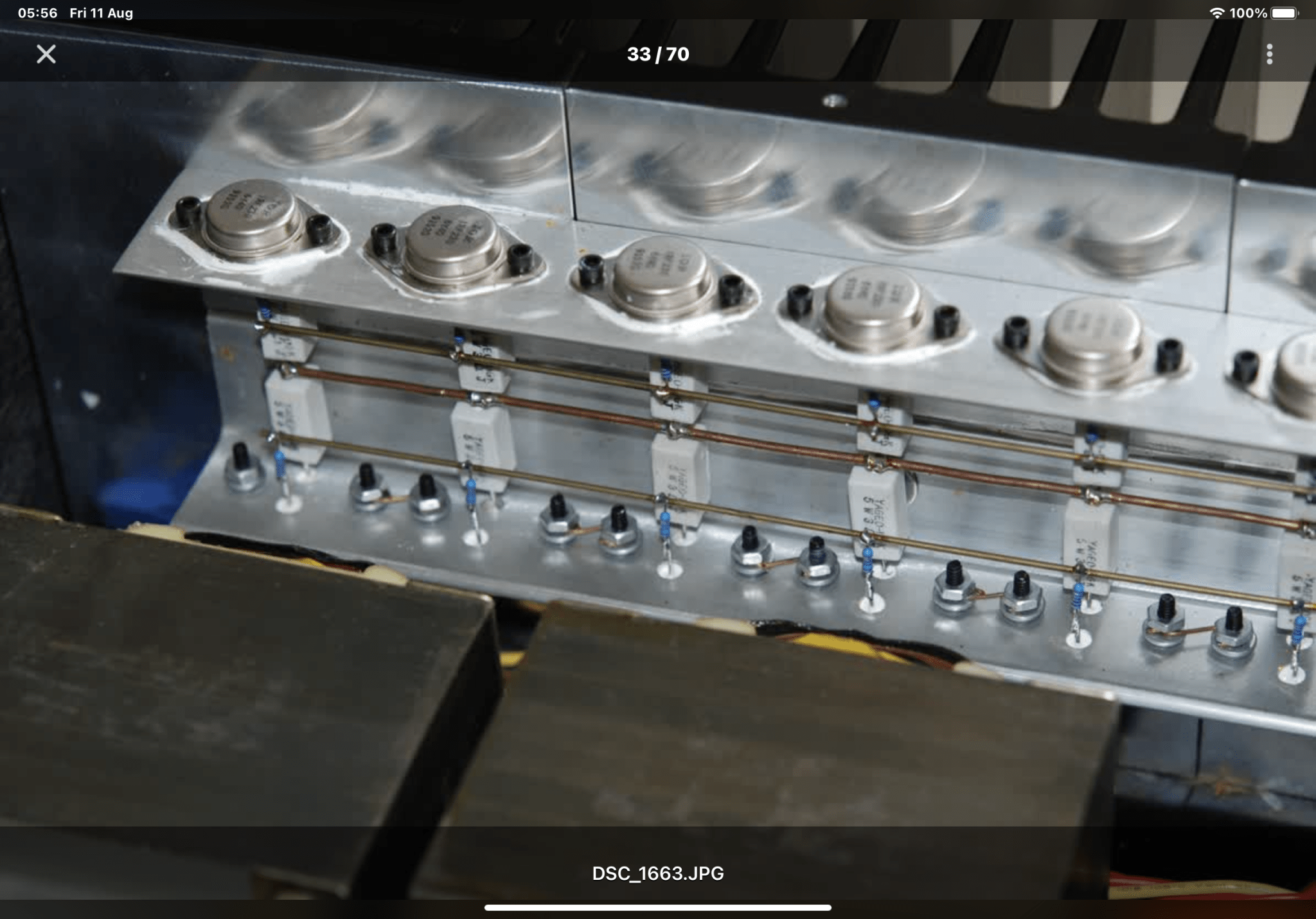

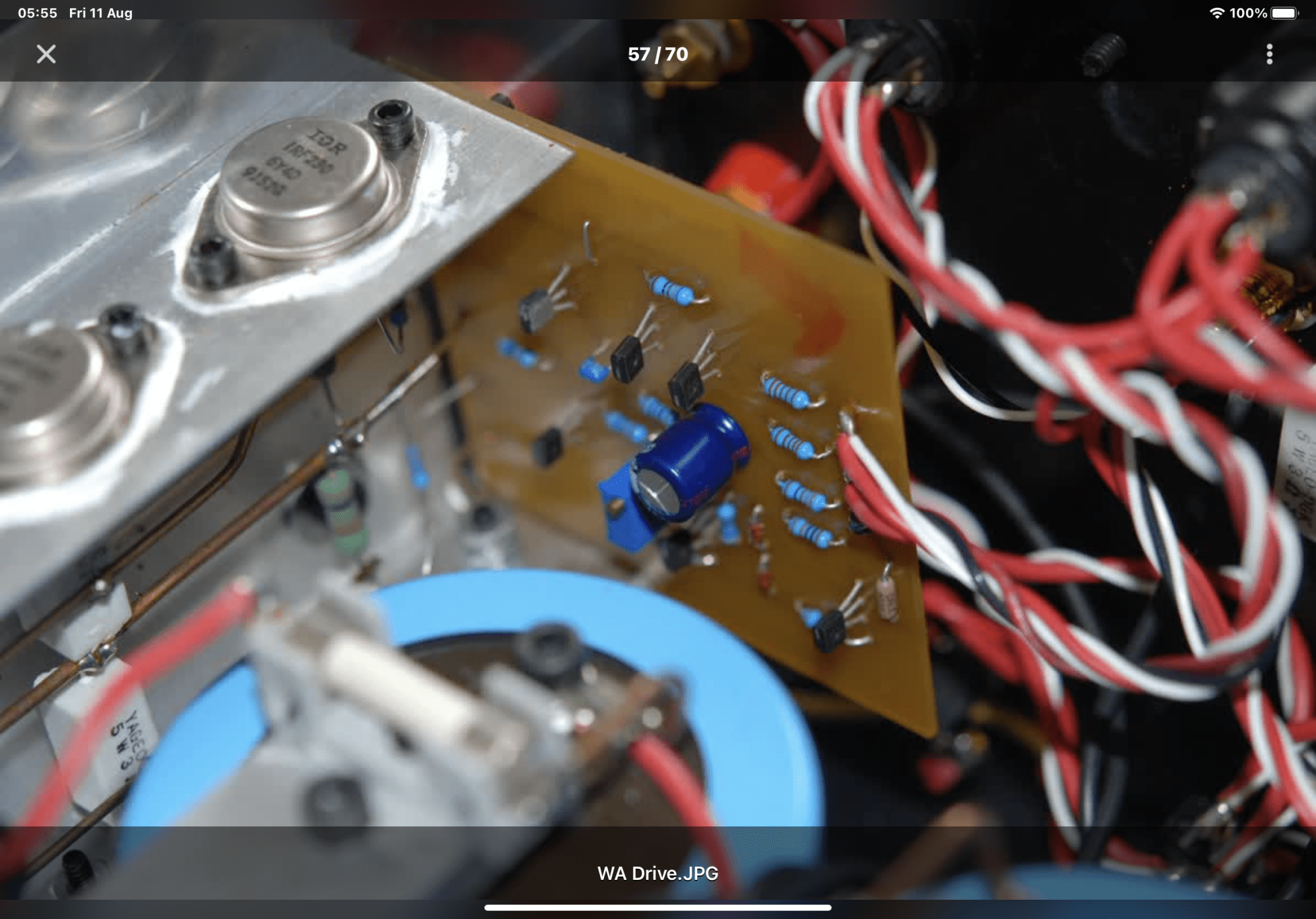

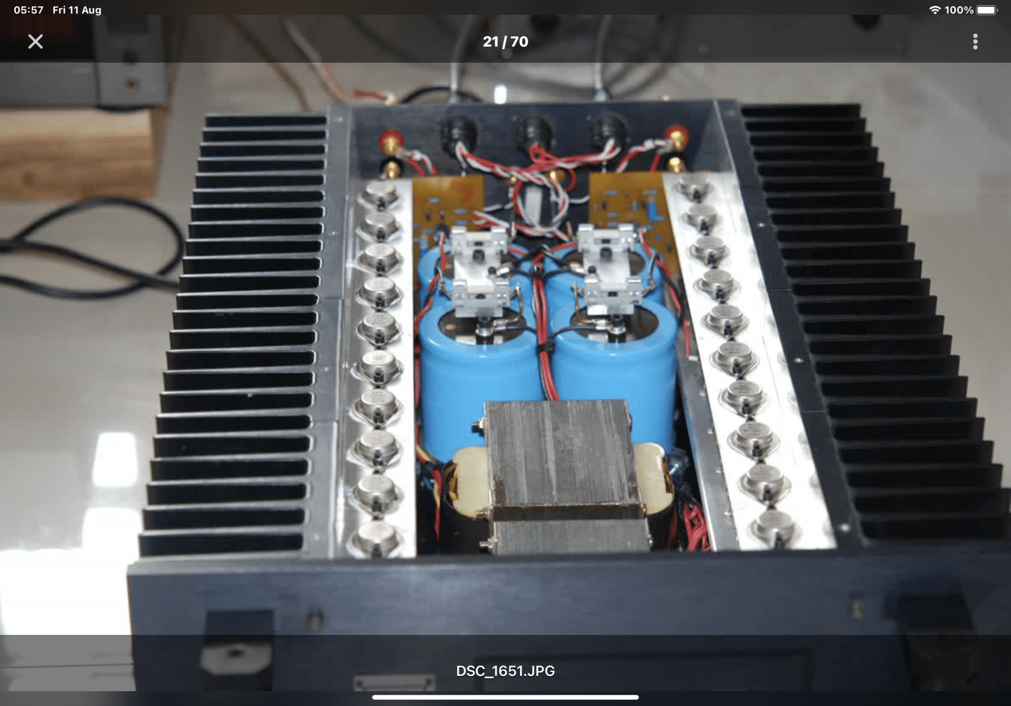

Hi, All.
Thank you for posting and sharing the issues and resolutions regarding to the White Audiolab amp. I happen to own a 250wpc White Audiolab power amp. Overall performance sound wise I think it does OK. But looking inside ,IMO, it is abit with DIY look indeed. But love its simplicity though.
Yootk.
