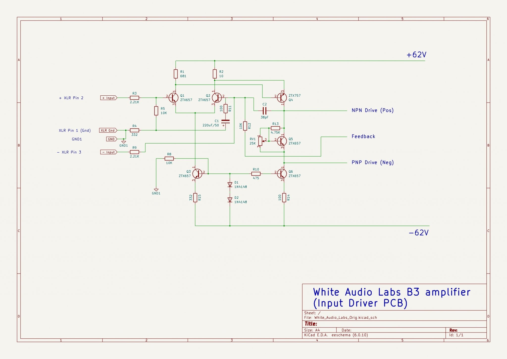

I do worry that oscillation may have been a problem with this amplifier in the past and may be even more of a problem if I install the Exicon's. So extra compensation will likely be needed. The right channel in this amp has an extra capacitor strapped in parallel across the C2 capacitor shown in my driver pcb schematic, it was tacked onto the backside of the board. It seems to me that this would've likely been placed there when the amp was built to tame some oscillations seen when it was built. The left channel doesn't have this extra cap added.
Thoughts or ideas?

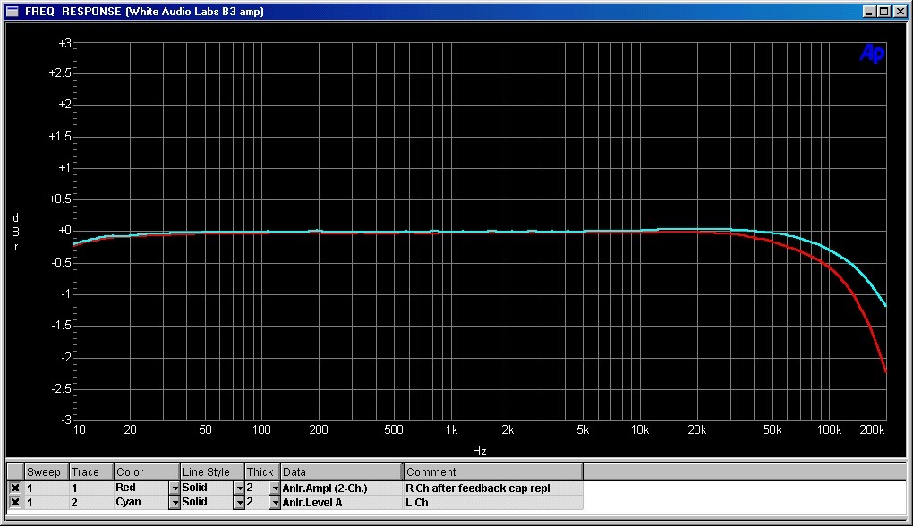

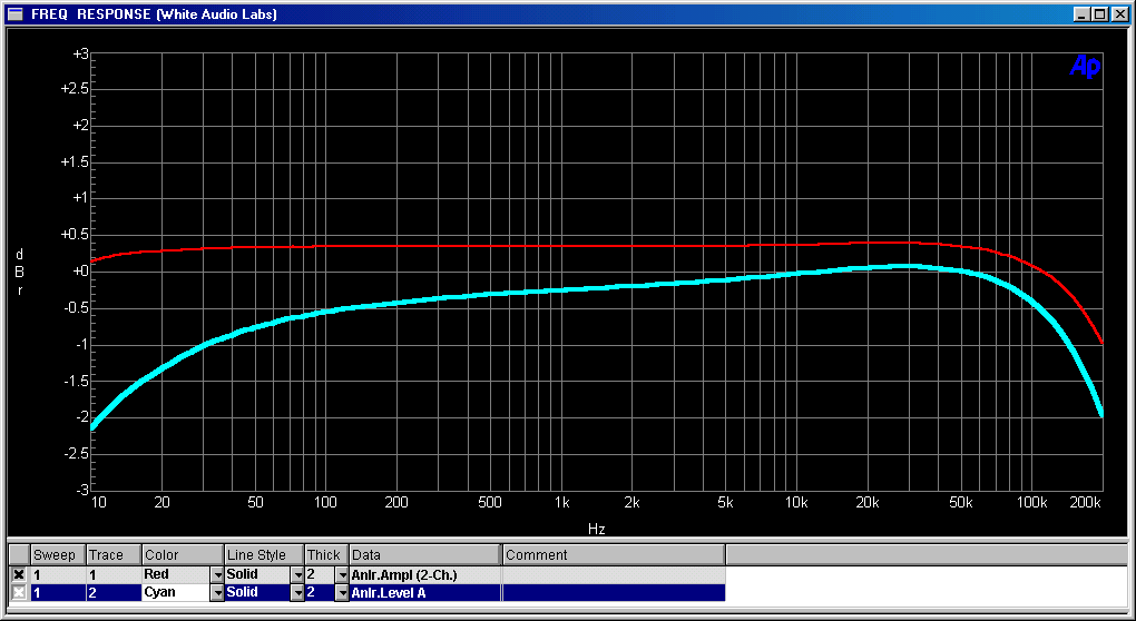

Steveu, you were correct! It was the 220uF cap that was causing the freq response issue. It was so bad that it tested as a 25ohm resistor with no capacitance. I guess that's why it the gain didn't rebound back to match the other channel at higher frequencies.
The reason that it threw me off is I had a cable connection reversed. A few weeks ago I had moved things around in my testing area and I pulled the leads going to my dummy load out so I could reposition it. I'm using an old amp case to mount my dummy load resistors in and the connections are at the rear against the wall. When I reinstalled the cables a few weeks ago I wasn't paying attention and I connected the L & R channels up backwards. Doh! Anyway I had triple checked the leads up front and this morning I decided to pull the RCA input to the bad channel while watching the voltage output on the analyzer and when I pulled the input cable the signal didn't drop like I had expected. It took me about 5 secs to remember I had pulled those dummy load cables a few weeks ago. Oh well, at least I didn't waste too much time on that.

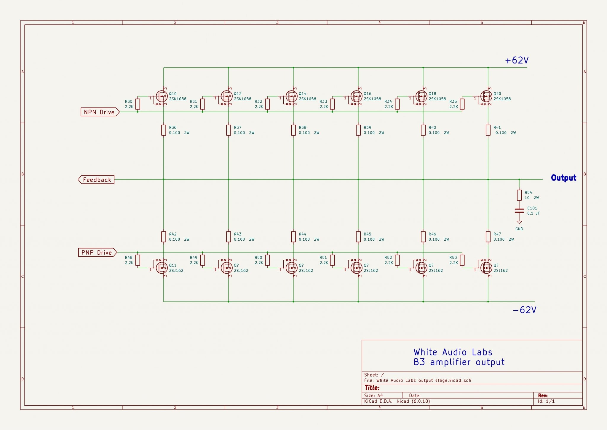

Just a few comments on the unusual design choices: the feedback ratio (10k:100) gives an open gain of 100 which is high and little feedback to correct; the half a John Curl JC2 front end; high gate resistors (2k2), usually 220R; no capacitors between the grid and drain for both n and p sides to balance out differences in mosfet capacitance; no output inductor, could have problems with high frequency oscillation; and approx 8mA from the VAS to drive 6 pairs of mosfets, which is on the light side. Looking at the pictures of the insides of various White Audio and Llano amps, very amateurish in their construction with ok parts. Concerning also, the previously mentioned TO92 devices being run hot.
He actually has the feedback resistance split on either side of the feedback cap, so its actually 10k : 432 so the open gain is a little better, but yes it seems he was trying to minimize the amount of capacitance in the circuit but I think this decision left these amps borderline unstable. I too was surprised that the interior of the amp has an almost DIY'er kind of look to it. Especially with the exterior looking so professional.
I also thought that the gate resistance seemed at least double what it should be.

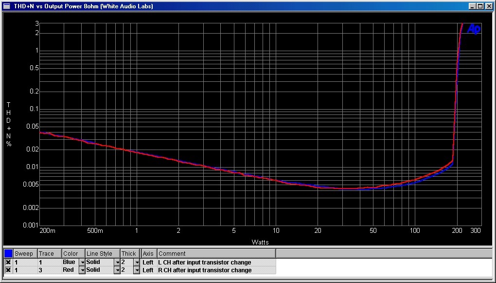

Well I received a batch of ZTX657 & ZTX757 transistors tonight and I matched up a few pairs for new LTP's and I also replaced Q4 and the current source Q6. Due to the amount of heat those last two have seen I thought it was a good measure. Connecting it up to the analyzer I was immediately rewarded with a very clean pair of identical traces dipping down close to .004% THD+N at its low point when running a quick test into 8 ohms. That chart is attached below. I thought "Great this thing is fixed!"
I ran a quick freq response test and the 2 channels were matching better than prior tests. So I decided to power down and connect the XLR cables and run an 8ohm power test via XLR inputs to see if the distortion was better than before. The next really bad chart included is what I got running the test via XLR input.

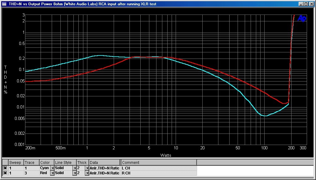

I ran it again via XLR input and had the same poor results, so I decided to switch back to RCA input for some more testing. Well, I get the same screwy bad results now via RCA input that I was getting via XLR, that chart is below. So it looks like something about the XLR input circuit is cr@p and damaged the new parts I just installed. Anyway, now I'm back to trying to find out which parts were damaged when running the test, via XLR input. Its probably the LTP pair which sucks because I only had a few good matches in the ZTX657 parts I bought.

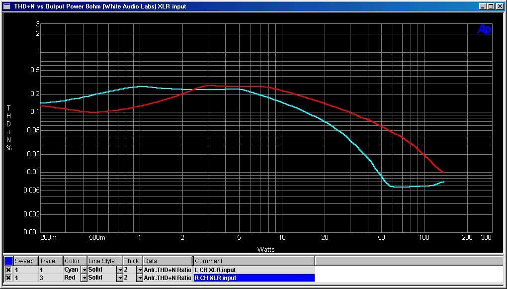

As it turns out the right channel lateral outputs were shot. My thinking and prior comments that the XLR input was causing the issues was wrong. It was a weird failure mode though. If I let the amp cool down completely overnight it would test good all the way up to 200WPC on both channels for about 3 - 4 min with very low distortion. Then the distortion would start to decay and I'd go from -80dB THD+N to about -30dB in a matter of minutes and on both channels. I finally disconnected a couple of the lateral mosfets in the R channel that had much higher bias currents (leaky) than their counterparts. This brought the distortion down in both channels for a much longer period, about an hour. Then once the heatsinks got fairly warm more mosfets would begin leaking in the right channel and both channels distortion would decay once again. Why both channels will begin testing bad once the R ch goes bad is baffling to me, the only thing I can think of is that the two channels share a common ground and the channel with the bad mosfets is creating a noisy ground.
Many of the later White amps moved from the lateral Mosfets over to Hexfet's and the local audiophile for whom I'm doing the work on this amp had access to one of the White audio hexfet amps and I had him get photos of those input driver boards. It turns out that the driver boards used in that amp use the identical driver circuit as this lateral amp, the only addition was gate to source protection zeners and a lower 2k ohm bias potentiometer, but otherwise identical. So I decided to give it a try. As a test I converted the R ch to IRFP9240/240's using a quad of matched devices I had in my parts drawer. I just limited my testing to 100W just to be safe due to only using 2N & 2P devices in the channel. I also swapped Q4/Q6 out for 2N3440/2N5416's (TO-39's) that I have a small supply of, and added heatsinks and I also increased the VAS current to 12mA. So far its testing good, but I do have what looks like some oscillation showing up at higher power levels 50W - 100W or so and then it reduces, so I need to work on that. We plan to convert the L and R channels to a full complement of the IRFP's. Hopefully that'll happen later this week.

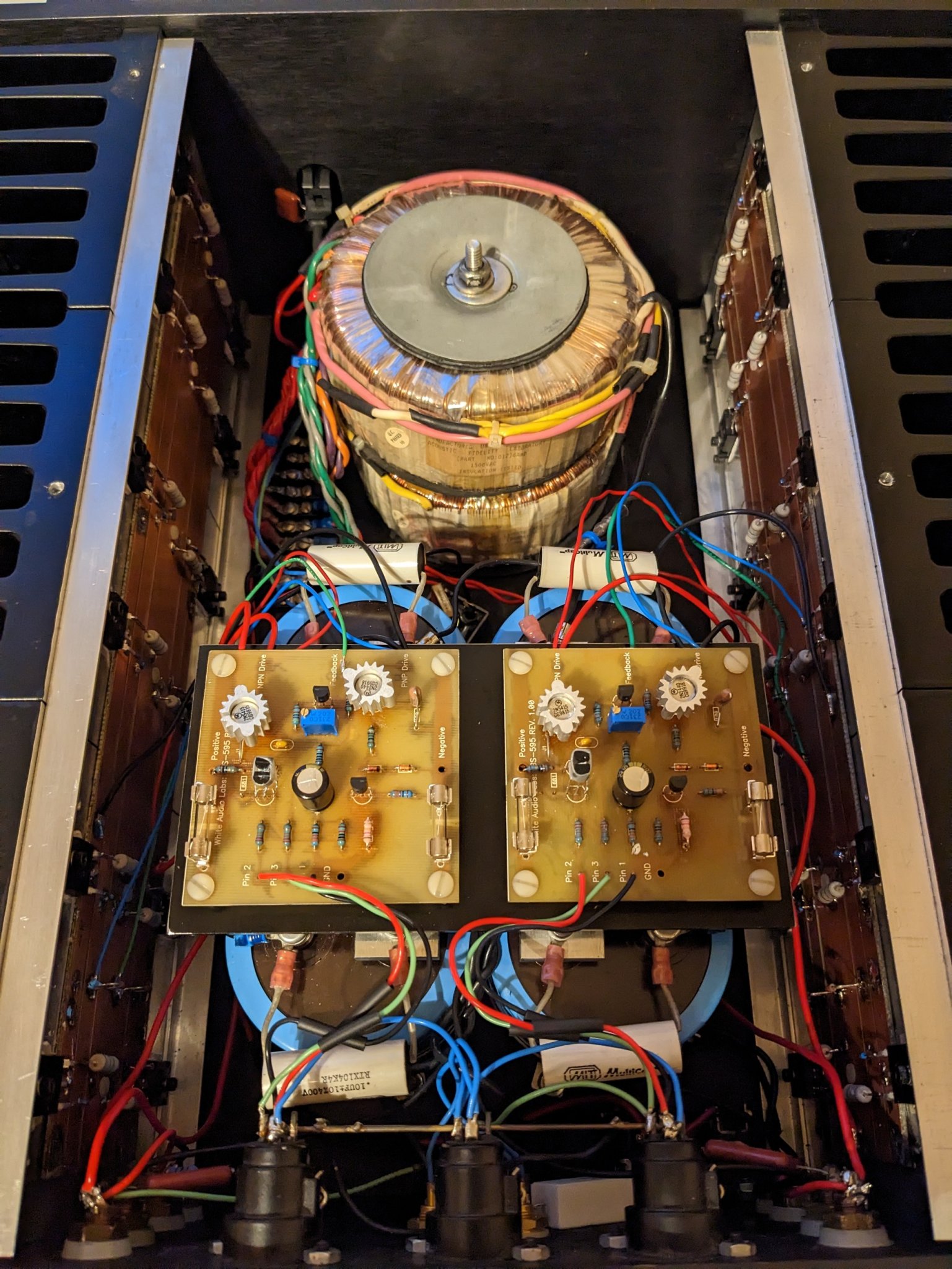

I ended up moving the driver boards from their mounting location on top of the channel boards, which was hard to access and work on, to a top mounted aluminum plate above the primary capacitors. I included a picture of the new mounting position for the driver boards in the amp I'm working on. I made other changes to try and improve the reliability of the amp. I changed Q4/Q6 out for 2N5415/2N3440 TO-39 transistors with heatsinks to improve their power handing capacity. I also increased the current through the VAS from ~7mA to ~11mA. R8 was also changed to a 12K/1W resistor. I also added DC rail fuses to both of the driver boards for safety purposes. You can see these in the pictures. For some reason White Audio decided that a single slow blow AC mains fuse was enough to protect downstream gear from catching fire in the event of a major failure.
