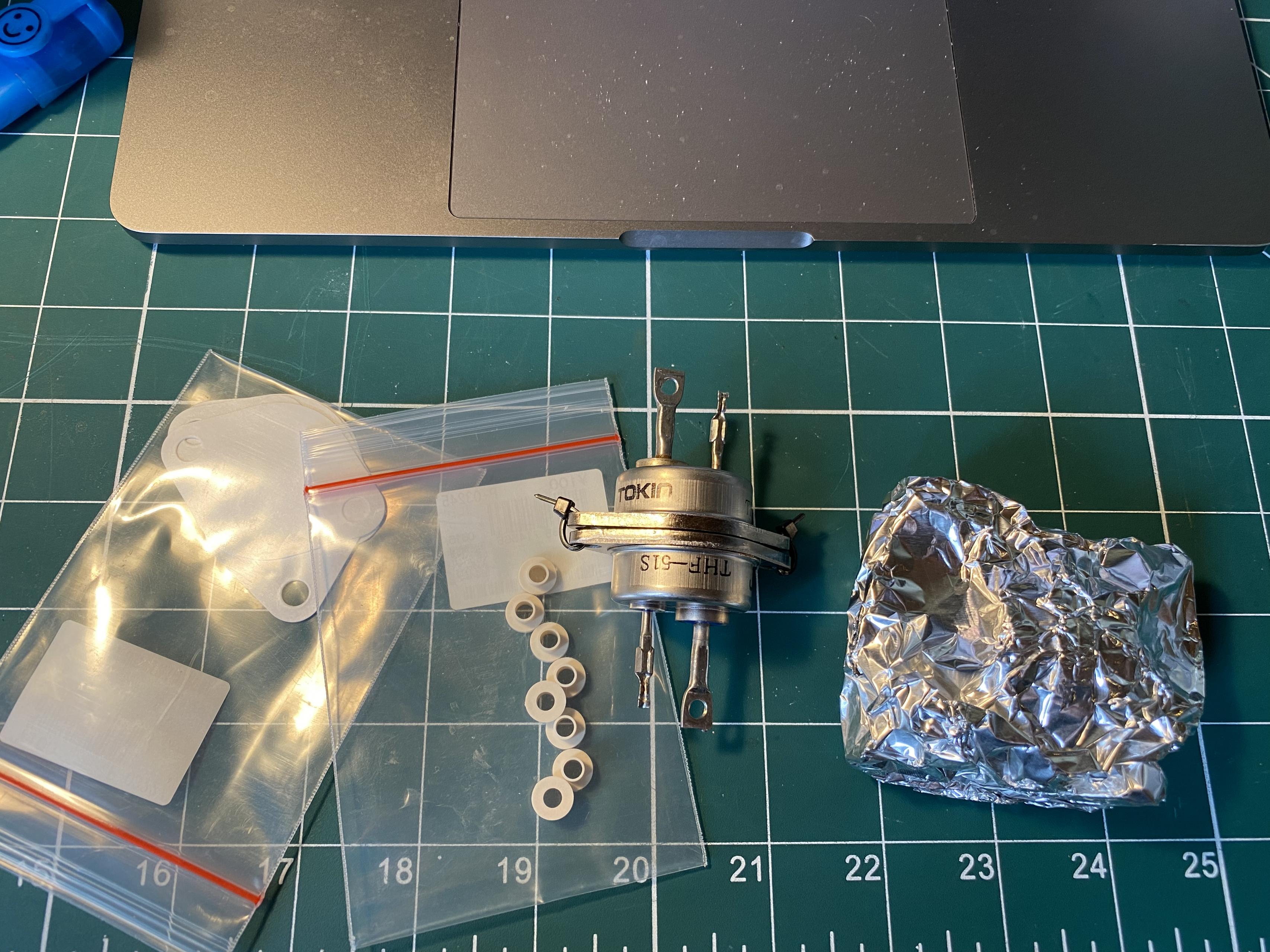

I have also been considering how to handle the thermal interface for these large electrically connected cases. I have been using Keratherm Kerafol for my builds. The sheets and some shapes are available in our neck of the woods at Conrad (as you probably already know). However I was intrigued by something a bit beefier for the Tokins and indulged in a few Al2O3 insulators from Canada. See attached.
The THF-51S starts to heat up once you get some current flowing >1.5?A. I used a fan on my test heatsink to keep the temperature in the thirties when over 1.8A. Being a €50 part and not easily obtainable I was being observant.
Hi Martin,
Either you did a perfect job or did not use thermal paste at all, just too clean and neat;-)
I recall Frank mentioned using thermal paste to "fill the gap".

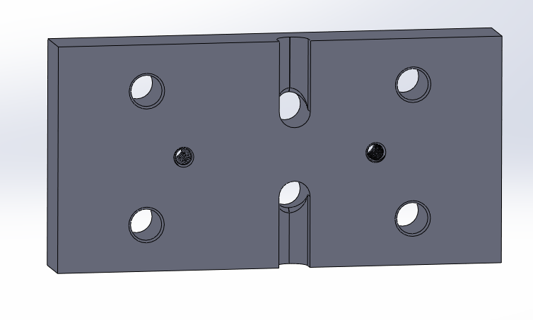

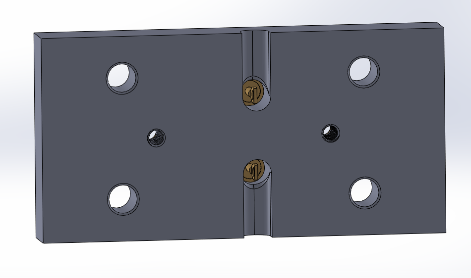

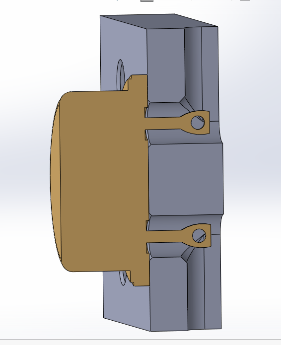

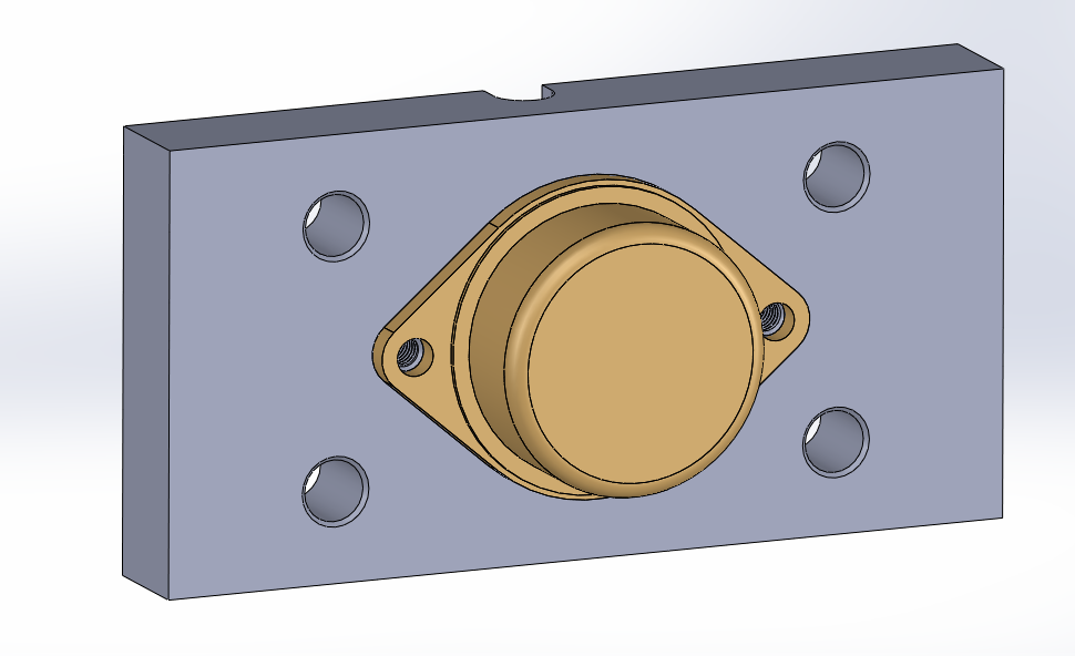

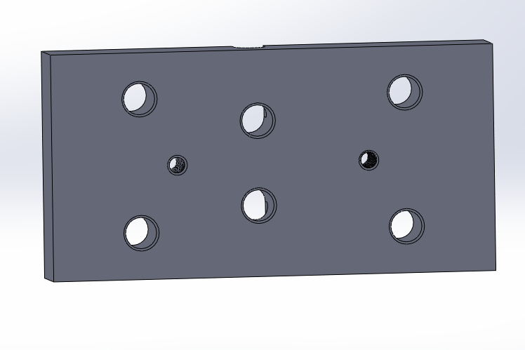

60 Watts sounds perfect to me. It will give a chance for my long serving Aleph 5 to have a rest. A point of note, this will make heat sink interfaces more important. I have modeled up one possible option. This would suit the 2SK180 as the leads are on the same side as the mounting face, (not needed for the other Tokin VFets as the leads are on the other side). It could be made from Aluminium and hard anodized thus not requiring surface insulation (the fixings to the heat sink would still need to be isolated) or just isolated as is done at present.
This example is 2" x 1/2" Aluminium flat bar. 100mm (4") long. A point to note is that the mechanical drawing for the 2SK180 shows the original type. The later type (which many of us seem to have) has different size leads.
For 60W output from a 2SK180 you will definitely need the best heat dissipation possible!
