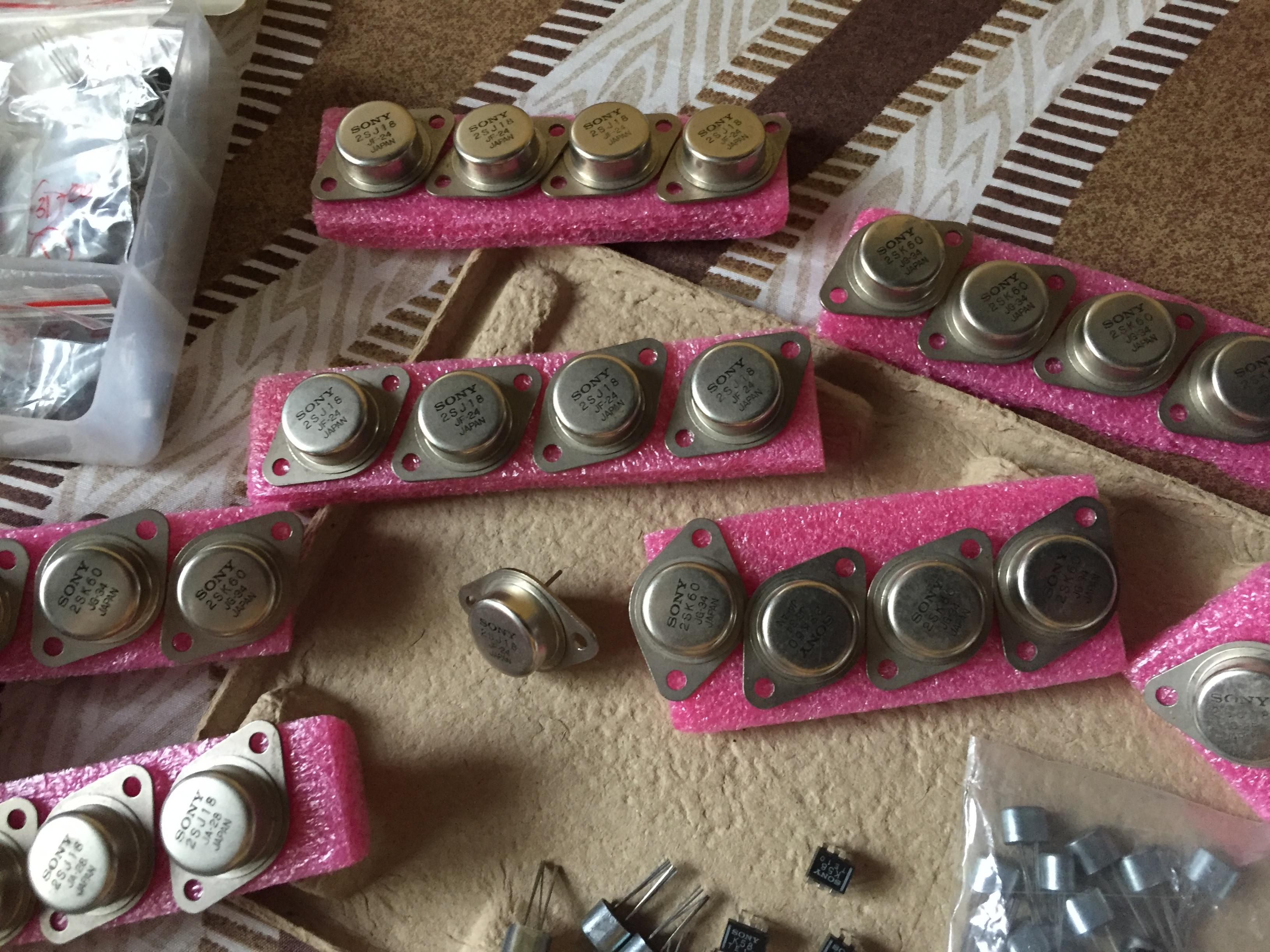

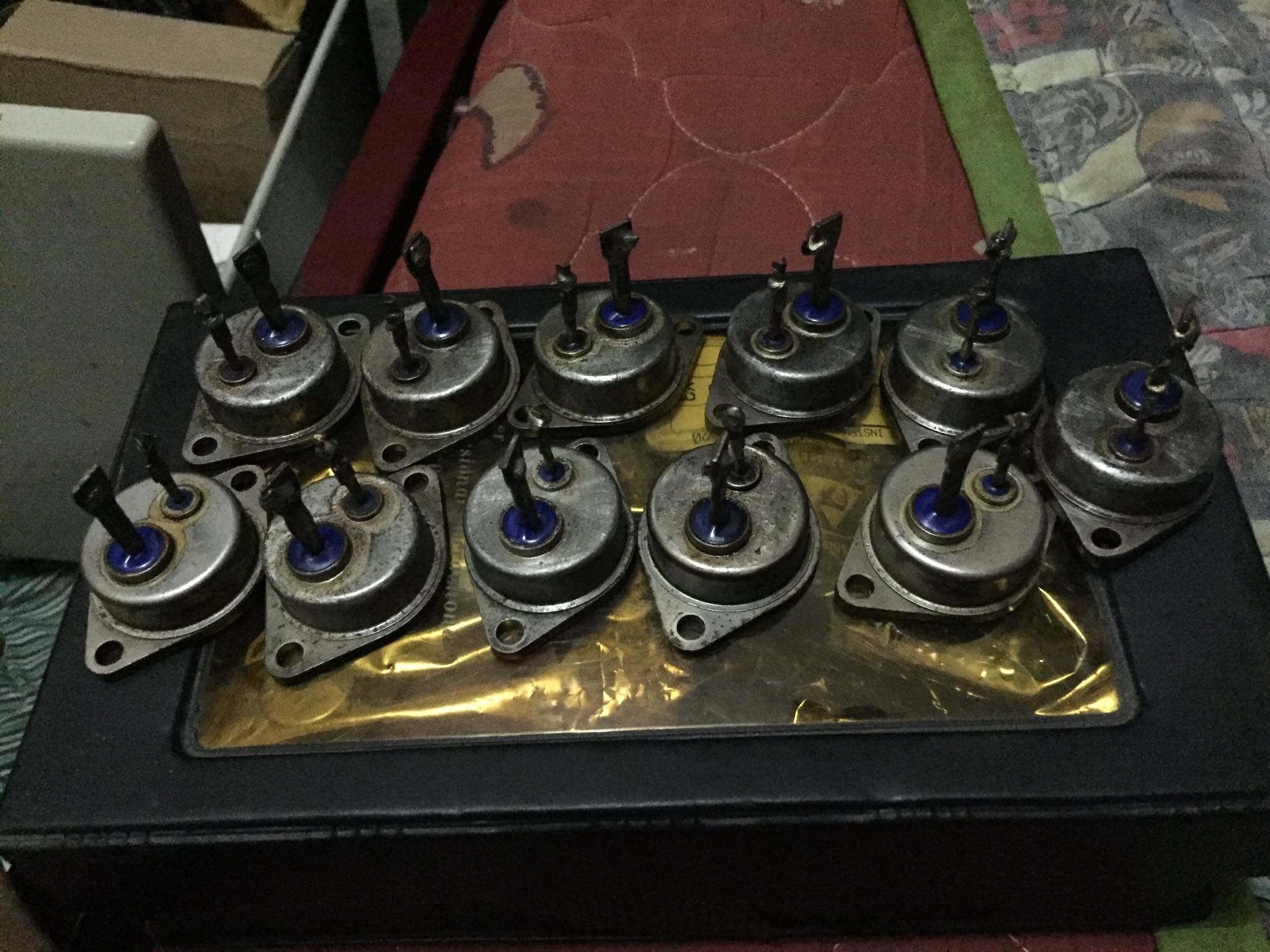

Hopefully this things will finally come to work . 2SK182ES original pulls and still test good from medical equipment's and K60 and J18's.

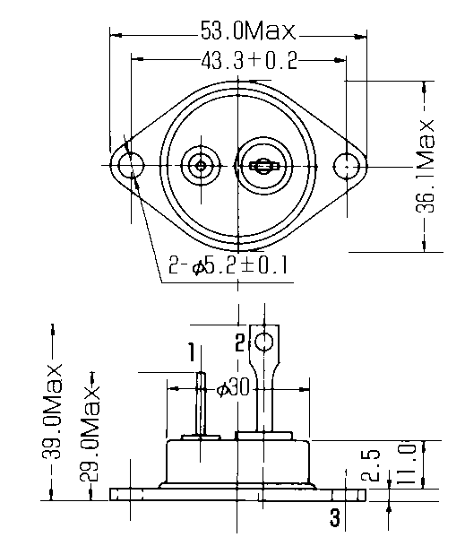

Can I ask , for the members who have received the THF-51 and 2SK182ES SITS from watanabe in Japan, did he include the insulating pad and mounting screw insulating bushes, with the transistors?
If not, where do we get these from?
As I understand he only sell transistors.
No mounting kits and so on.
Info of what everyone use scattered through SissySit and HockeyPuck threads.
THF-51/2SK182E mounting holes are 5.2mm and 2.5mm deep.
Right now i found this for insulation bushing:
Screw Nylon Transistor Gasket The step T Type Plastic Washer Insulation Spacer Screw Thread Protector M3 M4 M5 M6 M8 M10 M12|Washers| - AliExpress
(TW-10 model) But it's lenght still need to cut.
May be I will find something beter later.
Mounting bolts or screws M4.
Edit: Fixed link to ".com"
