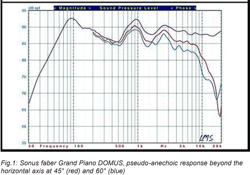

The bass problems of this speaker are well documented. Independend of rooms, from different sources.
It has a huge 95 Hz peak and then has a steep decline. The response above this bass peak has huge ups and downs too.
The crossover is very strange, to say it friendly. It includes some obvious mistakes in crossover construction, that make bass and mid chassis peak at an undesired frequency. An objective example of a very expensive, messed up high end speaker construction.

Here is a whole thread with measurements from different sources that show the problem. Sadly, it ends without any final measurements of the modified speaker, seems the starter just tanked when they worked for him.

Obviously. Seems a commercial tuning to me. And the overal response, well, I’d be ashamed if one of my designs would show such a mountainous landscape.The bass problems of this speaker are well documented. Independend of rooms, from different sources.
A longer port or dismissing it altogether (use a towel and stuff it) might help at the low end. But to be more certain, we’d need impedance measurements and internal box volume.
