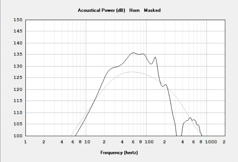

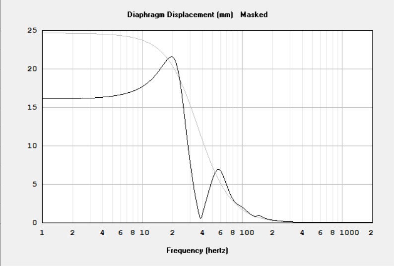

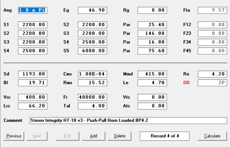

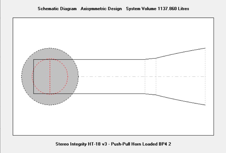

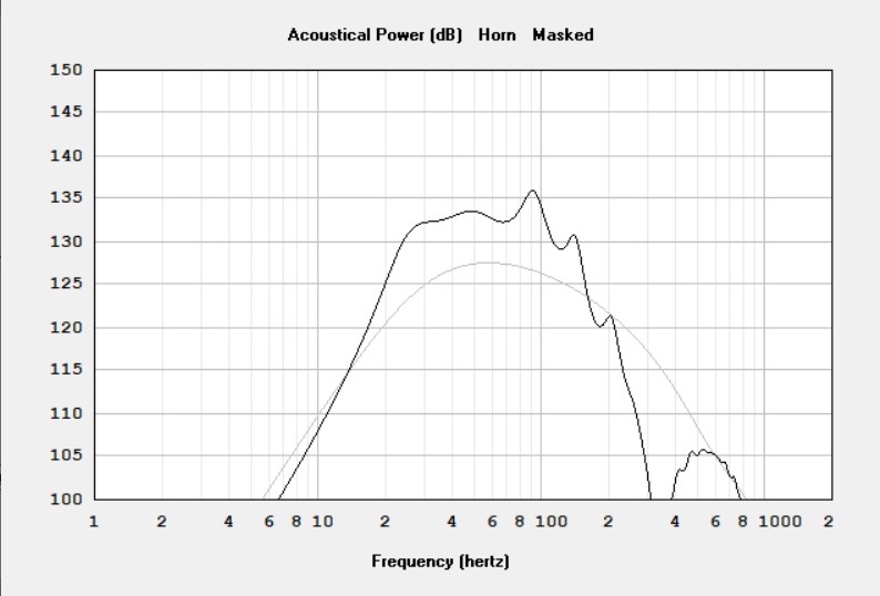

So I had an idea for this that seems to model like a best-of-most-worlds solution for this driver, but I haven't seen anyone do anything quite like it before. Hopefully somebody can tell me if this makes sense.
The idea is that I take a sealed PPSL enclosure, and extend the slot into a roughly 35-40 hz horn. Physically it would look like a "W-Bin" FLH, with a sealed chamber, and with the throat extended through the center of the chamber. The sweet spot that I found is a chamber volume around 350 to 500 liters (the model is surprisingly insensitive to this), throat CSA around 1400-2000 cm^2, and mouth CSA around 4000-8000 (total, or roughly 2-4 square feet per side).
This design would end up in the 1000-1500 liter range. The frequency response looks a lot like a sealed box, but with some extra LF extension, a high shoulder somewhere between 100 and 150 (since it's a 4th order bandpass design), and 6-10db of extra gain in the 20-80 hz passband. Phase and group delay behave themselves much better than in a TL or TH, excursion is very well controlled within the power limits of the driver, impulse response looks reasonable. Hornresp is claiming my current amp is enough to get 125 db at 20hz, 115db at 15hz, and hearing damage in the midbass (in 1pi space; one of the horn mouths will be near a wall, and both will be firing into the back of the seats, so I think using 1pi should be conservative enough, though I remain skeptical of the actual SPL numbers; 135db at 40hz with 1000 watts just seems like an awful lot).
I'll post my sims later when I can. Does anyone see any problems with the concept? I know FLHs not too unlike this have been done plenty of times before, but typically they're using drivers with higher fs and lower qts, and arriving at a somewhat higher passband.
Here's the Hornresp info for one version. The lighter line in the SPL and displacement graphs is a 1200 liter sealed enclosure with two of the same driver.
  • PPHL1.txt

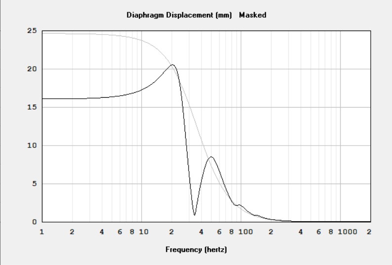

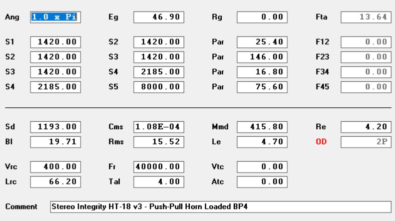

Here's another iteration. Bigger pipe, smaller mouth, flatter response, a little trickier to fit the pipe around the drivers.
  • PPHL2.txt

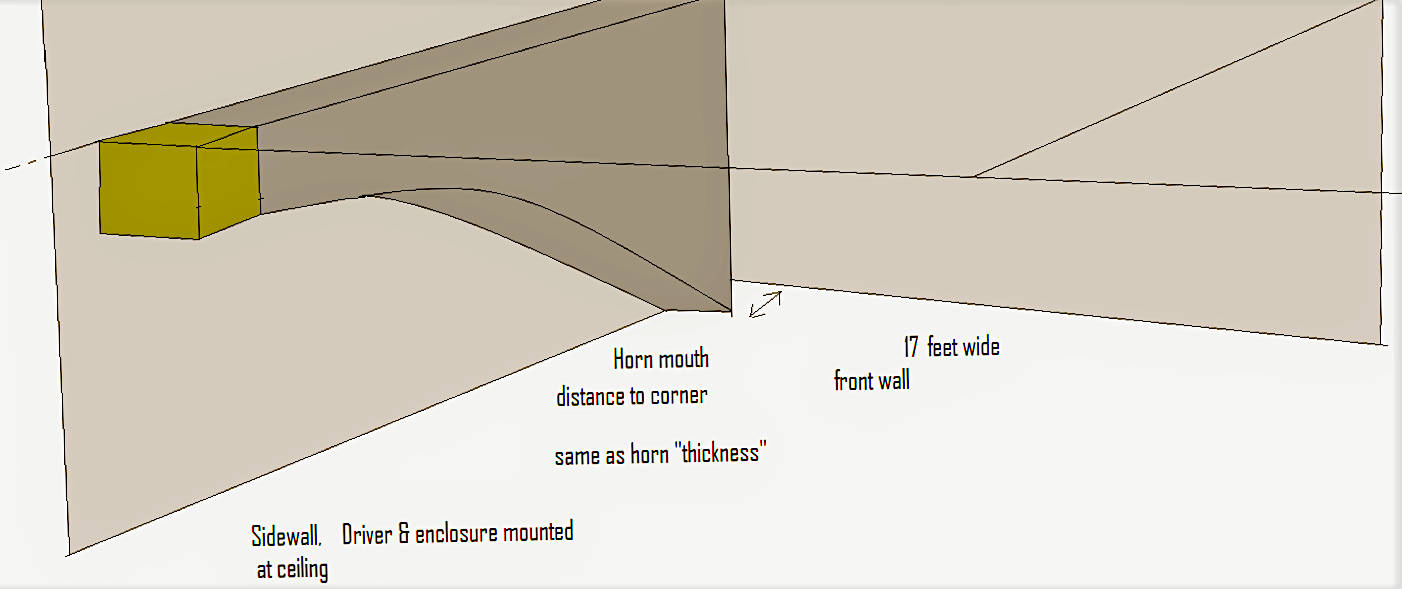

A horn enclosure I'd been contemplating for awhile. This would take advantage of a truly large & proportional main living room.
Imagine if you will a pair of large rectangular "boxes" mounted up in the rear corners of your listening room...a sweeping horn that terminates at the "front" of the room...the front corners functioning as a continuation of said horn.
One could incorporate shelving & cabinetry within the open curvature to disguise its real function.
