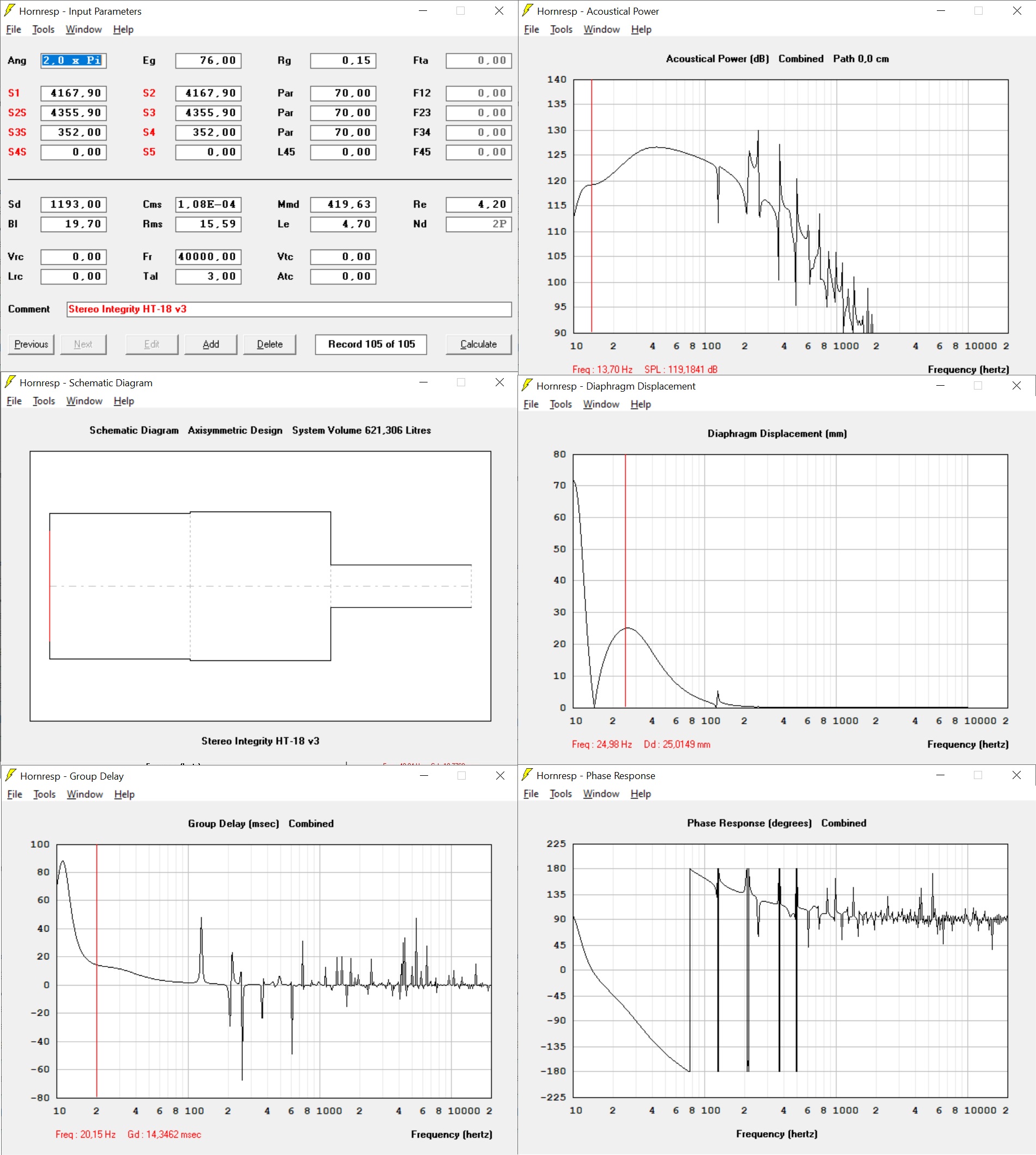

Interestingly, Winisd is showing me a very, very nice looking result from a 600+L box tuned to 11hz. F6 in the 15hz range, good excursion control, very flat. Hornresp doesn't quite agree on the frequency response though, so I'm not believing it.

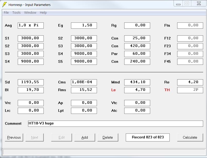

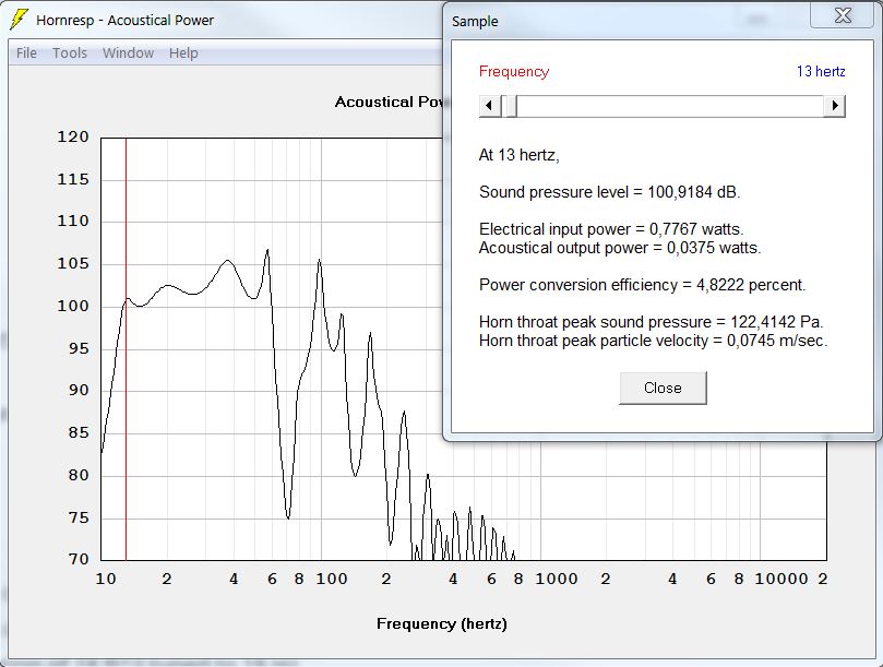

You asked for a "huge" enclosure and mentioned tapped horns. This is a 218 ROAR (8th order quarter wave based series bandpass).
Max spl is with 1500 watts (750 watts per driver) and one Pi radiation angle. You should probably add at least 6 dB room gain in the bottom part of the passband. With corner loading and room gain you could easily see 140 dB spl at 13 Hz if needed.

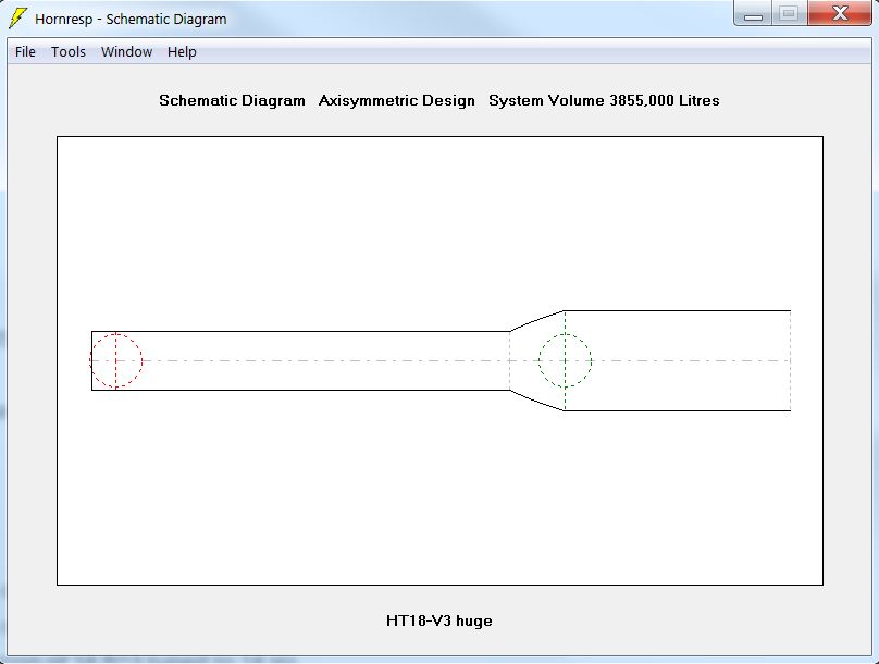

A TL isn't very complex when you're making a 10' long box. It would be a little easier to just build a single-fold TL than to figure out the port. If I model a large bass reflex with the actual dimensions I have available, I end up with some 1/4 wave resonance (and not in a particularly good way), or the port velocity gets out of hand.
In a tapered (smaller at terminus) TL, how undesirable is it actually to have a little underdamped peak at resonance if the resonance is under 15hz? I can't seem to make that go away due to, I assume, the driver's QTS. I'm not worried about the actual FR peak, or even transient response or some ringing in the infrasonic range. I'm more concerned with what it would mean for the system's behavior an octave or more above the resonance. If the effects above 20hz would be significant, can they be mitigated by lightly stuffing the line near the terminus to squash that peak?
