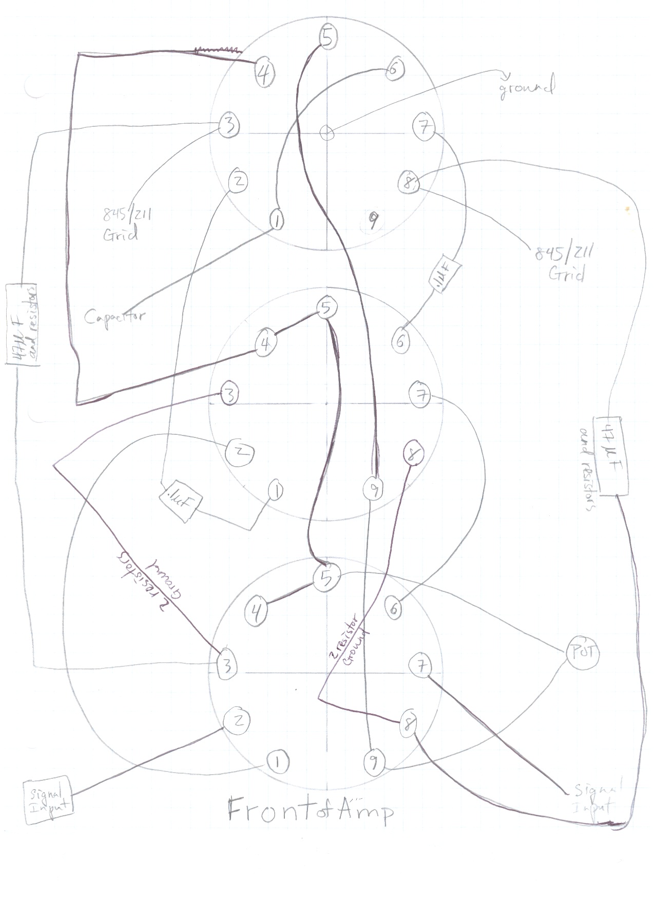

I met up with Stuart today. He figured out that the amp uses 845 tubes. He also figured the smaller tubes as well, 2 6CG7 and 1 12AT7 or 12AU7.
Does anybody have some 845 tubes for sale? I am looking for something inexpensive.
I am still confused about whether my amp uses 845 or 211.
With out any tubes installed the grid voltage is -340 VDC.
With only the 3 driver tubes installed, they are all lit up, The grid voltage can be adjust from +27 VDC to -70 VDC.
Do you guys know whether the grid voltage will change once I install the 845 or 211?
I already ordered the 845. What happens if I put the 845 in my amp and the grid voltage is only at -70 VDC?

I thought it was determined that the amp used 845's?I am still confused about whether my amp uses 845 or 211.
Depending on the plate voltage, you may be underbiased. On my Chinese 845 amp, the plate voltage is about 810VDC and the bias (fixed) is about -104VDC.What happens if I put the 845 in my amp and the grid voltage is only at -70 VDC?
Yes, unless the grid voltage changes with the power tubes installed, the amp uses 211. -60 to -70 VDC grid voltage is for 211.
The plate voltage with out the power tube is 1098 VDC

I still think that Stuart (SY) is right.
The range of bias WITH the driver tubes and WITHOUT the power tube is +27 to -70. That range has to be off because neither 845 nor 211 operates in the positive grid voltage. I think that the grid voltage will change once the power tube is installed.
You can't accurately measure plate current unless an output tube is in circuit.
Based on your latest information, it would seem the plate voltage and bias are set-up for a 211 tube. I run my 211 amp with about 1080VDC on the plate and -60 bias (cathode bias).
Yes, I understand. There is no point to measure the plate current without the tube installed.
The real issue is you can't measure plate current that way. The grid bias voltage controls the current through the tube. I don't think you are measuring something correctly if you can adjust the grid bias voltage positive. If the voltage really is -70, then its too low for an 845. Maybe you could get away with -70 if you kept the plate voltage low... But anyhow the driver tubes should have no effect at all on the bias voltage.
The only way to answer any of these questions is to draw out a schematic. The pictures you posted so far look like a hobbyist amp. For all you know this could be a project that never did work.
Interesting. In my amp, the driver tubes do make a difference. However, this could be due to the fact that I have been measuring the grid voltage without the power tube.
If you look at the drawing, the R and L power tube grid voltage wire go to pin 3 and 8 respectively of one of the small socket.
Just to be clear, the bias voltage is the grid voltage right?
I have been measuring the grid voltage by putting the negative probe on the chassis and the positive on the grid of the 845/211 socket.
How come I can't measure this way? What do you recommend?
