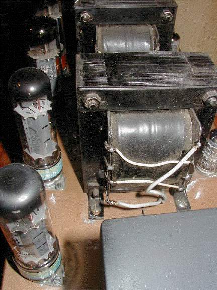

The output transformers on this amp (please see the picture) have only two unmarked wires from each secondary side. How can I tell which is positive and which is negative so can connect them properly to the speaker output?

Geek said:
If your amplifier uses no NFB off the speaker side of the tranny, polarity is irrelevant. If you have NFB and your circuit oscillates, switch polarity 😉

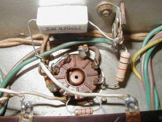

It uses (per channel) two EL34, one EF86, one 12AX7, and one GZ34. Please see the enclosed photo of the output tube wiring. I received the amp with a small box full of caps, resistors, that had been removed, so I'm not sure what (if anything) it had connected to the speaker terminals.

The output (secondary sides) of the OPT have only two grey wires that presently are unconnected. So, these OPT do not have the usual 4-8-16 ohm taps. The Mullard 5/20 schematic says that R13 and C9 (feedback loop components) are to be "chosen to match speaker as follows: 3.75 ohm speaker - 3.9K and 470pF respectively; 7.5 ohm speaker - 5.6K and 330pF; 15 ohm speaker, 8.2K and 220pF.

The links on the output transformer suggest it has several secondaries, connected in series. You could take 4/8/16 ohms taps off those junctions. I suspect it will be set up for 16 ohms, what impedance speakers are you using on it?
One secondary lead from the output transformer should be grounded, the other is the speaker + connection.
As previous posters have said, you should connect the feedbach resistor from the + speaker output, to the input tube, at the junction of the two cathode resistors. If it howls, reverse the output transformer secondary leads.
If I were you, I would study the Mullard 5-20 schematic and simply copy that. You will notice that the input tube has two cathode resistors, one of ~100 to ground, the other several Kohms to the tube. The junction of these is where you atach your FB resistor going to the + speaker terminal.

A .1µF 1000v cap goes from ground to the control grid (pin 5) with a 2.2K one-half watt resistor connected from pins 5 to 6. A 47µF 350v electrolytic cap is connected from ground to pins 1 and 8. Pin 4 is connected through a 1K 2 watt resistor to the OPT primary.

I suspect you are reading the numbers on the sockets wrong, as there should be no cap to ground from the g1 grid of the EL34!!!
The number of the pin is above it on most sockets...
Check whether it is consistent with the mullard schematic...

Well that definitly isn't right! Are you sure it's an .1uF, maybe it's an 10pF or 100pF. Pin 6 would be where the coupling cap from the driver would connect to, the 2.2k resistor being the grid stopper. Is the 1k resistor going to a screen tap on the OPT or the same connection as the plate (pin 3)?

You are correct, of course; the cap in question is not attached to ground, but rather goes between the plate of the 12AX7 driver to pin 6 of the EL34 which is connected to pin 5 through a 2.2K resistor. When I got the amp, these caps were .1µF 1000v "oil caps" (or so it says in Spanish) I replaced them with the type shown in the attached photo. Was this a mistake? I'm not sure why the builder chose the oil caps; the Mullard 5/20 part list/ schem shows C10 and C11 as a .5µF 350v "paper caps".

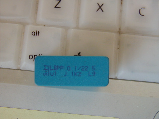

A-lot of people like the sound of oil caps! 😀 Paper caps should be replaced, we have much better caps to choose from these days. I couldn't make out the voltage of the cap in the pic you posted. What's the voltage rating? 630V would be just about ideal, 400V min.

I don't know the the voltage rating of the cap either. But that's because I don't understand the code on it: it looks like (sigma) LBPP 0.1/22.5 (over) 1JK2 L9
These are called "WIMA" caps, I believe. I'm not at all sure it they are appropriate for this application. But they had the overpowering advantage that they were were available. Please understand that obtaining Solens, Orange Drops, metal oxide resistors, and all the other stuff that I drool over when reading the likes of the AES catalog represent a major effort. It would be great to just be able to call an 800 number, give credit card information and have the components I want in my mail box shortly thereafter. But the reality is that living a the bottom of the world and trying to obtain the wonderful tube sound that I love are often incompatible. "Assessing" would involve unsoldering a couple dozen connections in order to be able to view the underside of the board. So I have resisted it.
