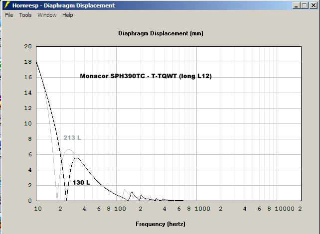

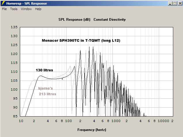

You could probably reduce the size of the box by giving up a little bit of low frequency extension (still goes well below your initially stated goal of 30Hz); but you'll be picking up a bit more excursion capability at the low end. I'll attach a Hornresp example. The slight peak below 30Hz will disappear after the box is properly stuffed. Also, take a look at permo's thread:

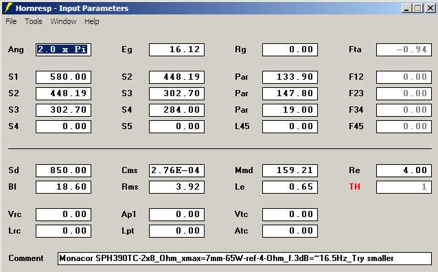

I looked at the T/S parameters again (e.g.: Post #21), and the Re should have been 3 Ohms. Changing the Le from 0.65mH to 1.3mH makes little difference. The model seems to be sensitive to added resistance in Rg.

Hi FroggySeven,
Post #32: "... does it mean that for 130L, Bass reflex is MUCH better for group delay, impulse response and even global frequency response for bass ?"
In Post #21 I tried to show, that in my opinion the enclosure size for bjorno's T-TQWT could be reduced.
Anyway, using Hornresp to model the T-TQWT family of enclosures is only a convenience, as it seems to give an adequate idea of the raw frequency response. The response, especially the pipe resonances changes drastically when the enclosure is properly treated with sound absorbing material. Bjorno models this with MJK's MathCad software (see: link in Post #25). The frequency response is smoothened, and the impulse response ends up to be closer to that of a closed box. The pipe resonances in a bass reflex will not be attenuated as effectively; the resonances of a 15cm diameter x 50cm long duct port will definitely be audible

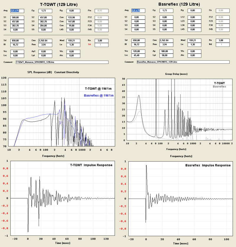

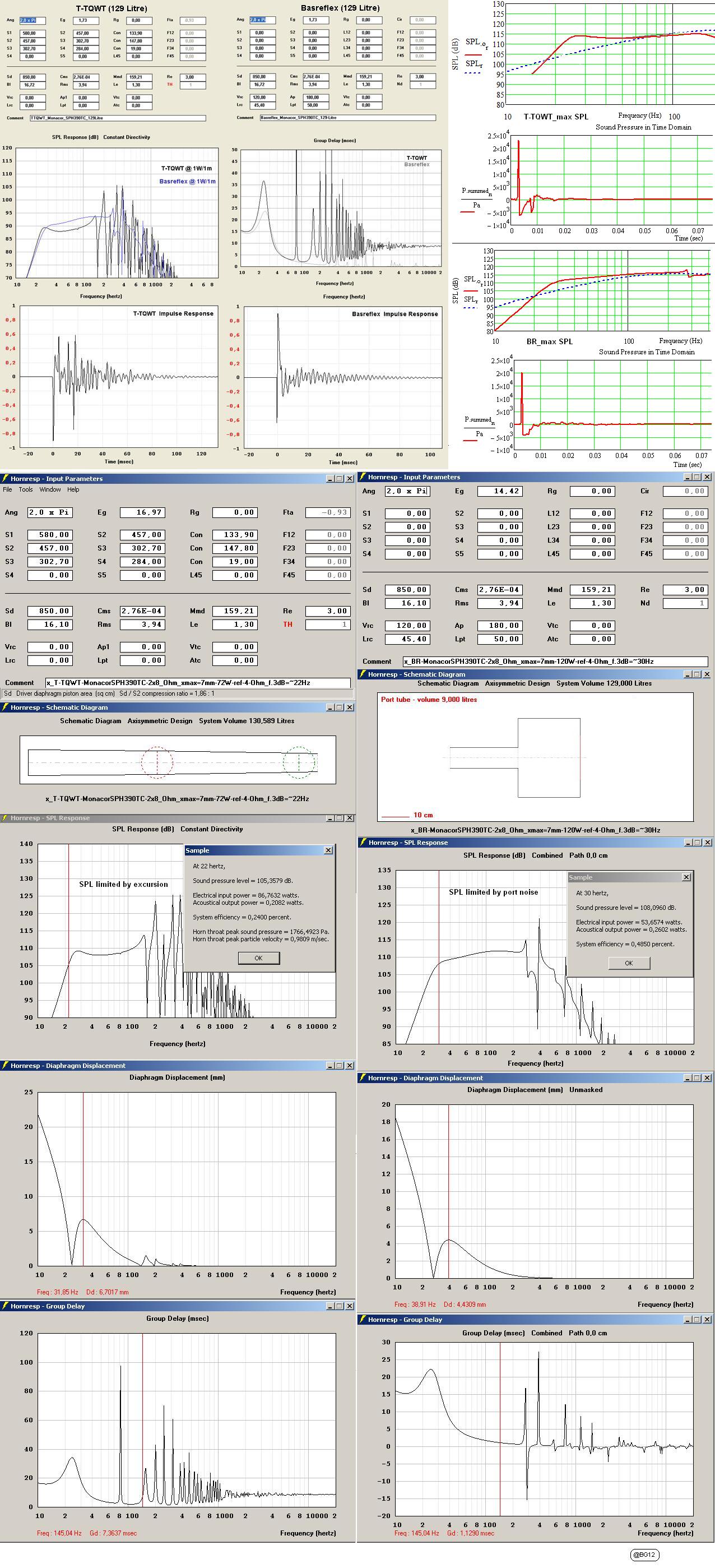

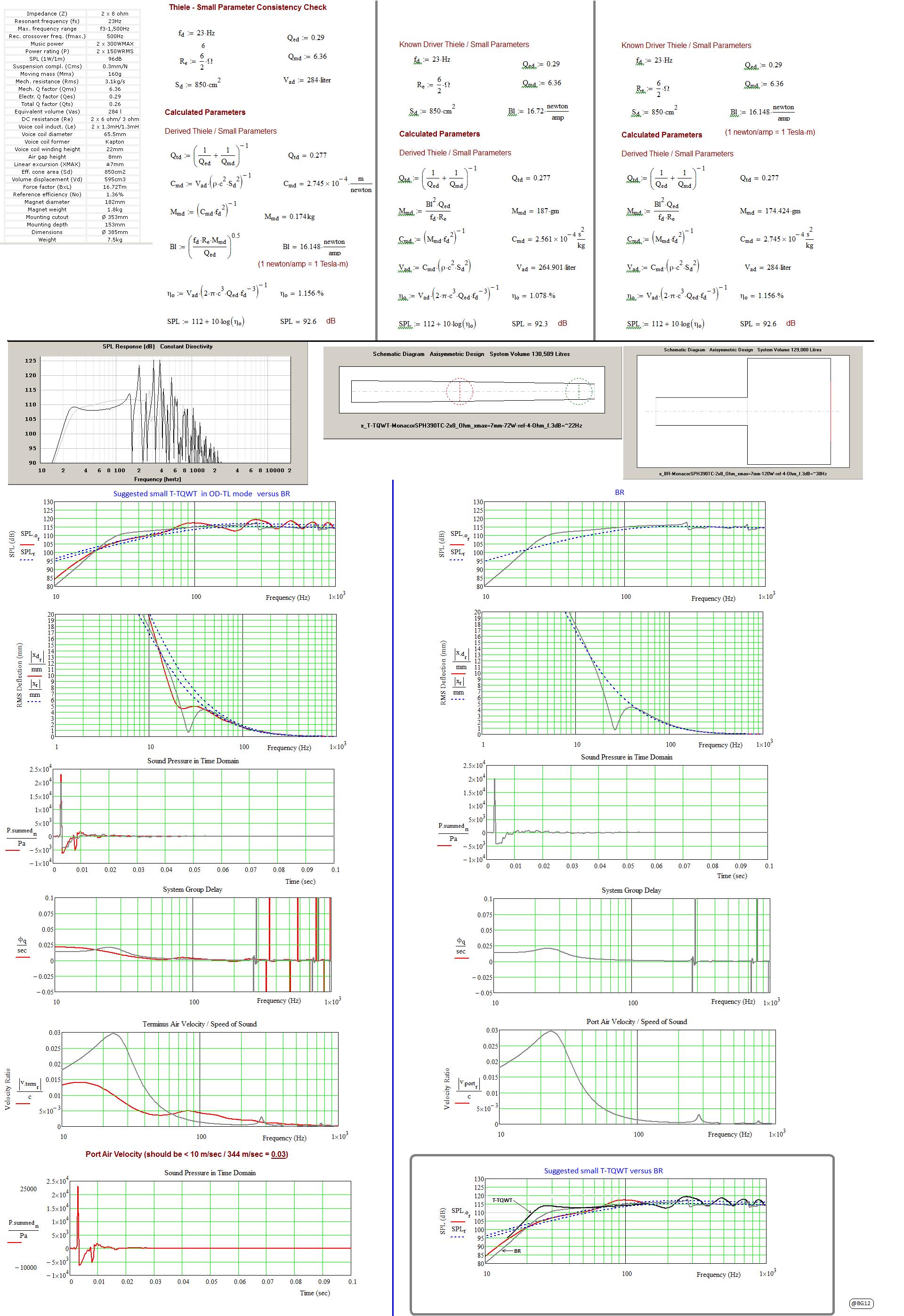

I'm almost back again...50% ?...😀. Ive noticed that my T-TQWT suggestion had a Re = 4 Ohm but should be = 3Ohm = as a result = minor FR difference but more important is that the advertised T/S is not consistent.
A consistency check can be found in the first submitted picture.
I fully agree with tb46 in post# 33 as the comparison made with a BR at 1W only show the speaker sensitivity and empty box behavior differences.
A more useful comparison is shown in the second of pictures.
If comparing the impulse response (always above + 10 mS where it matters its clear that the BR more or less would have an easy heard 'signature' at higher amplitudes even if using a LPF at or above 80 Hz.
Note: The tb46/Djim ? T-TQWT compared with the BR is xmax limited whereas the BR is port noise limited at higher SPL.
The T-TQWT sub can at max be XO:d at 145 Hz using a 24 dB/octave LPF(= max if Hi-Fi where 250 Hz would be 20 dB down) but not the BR that for Hi-Fi use should IMO use a XO < = 120 Hz.
b🙂

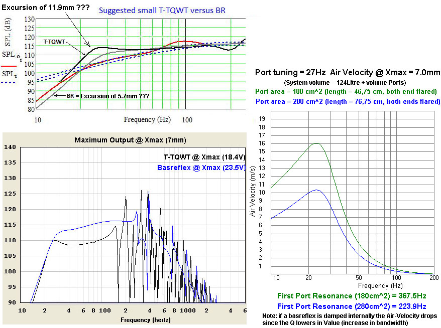

Hi Bjorno,
Maybe I am wrong but why do you compare the outputs based on different excursion values or without notification? See picture with added possible(?) values.
If there are worries about port noises as result of the air velocity, you can always improve it by using internal damping and/or make the port area as big the mouth/port of the T-TQWT (length compensation and volume compensation needed). Internal damping would also improve impulse response of a basreflex.
