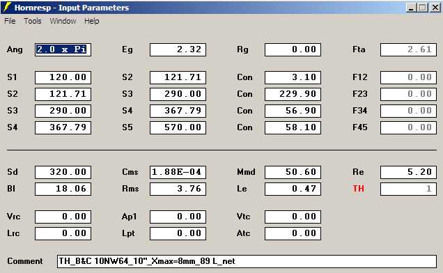

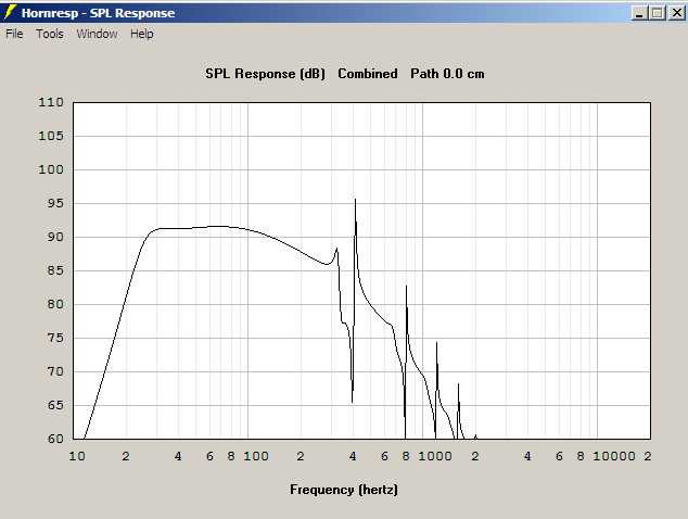

Hi FroggySeven,
How about a tapped horn using the B&C 10NW64, it should be fine from 30Hz to 120Hz (this is simulation only, no enclosure design)? Guessing, it would be about 125 L external volume.

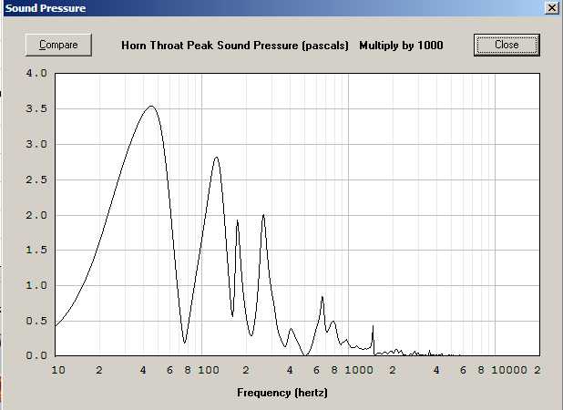

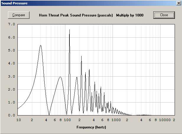

Hi Djim,
I think it is within reason 🙂 ; see e.g.: the attached Hornresp plots for the B&C 10Nw64 and the Eminence 3015LF in the SS15. I know you don't like to see the Fs that high versus the lower end of the bandpass, but all the inital work on tapped horns seemed to indicate, that there is nothing wrong with designing a TH that way. FroggySeven has set some difficult parameters: 30Hz-3dB / 90dB/1W/1m / <150L / <300Euro / 250W, maybe you have a better suggestion.

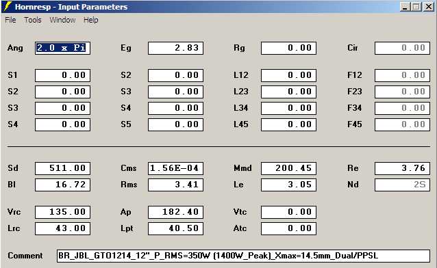

Hi Djim,
"...the old Pioneer (Premier in US) TS-W12 can do such job."
So can two JBl GTO1214, maybe as a PPSL.

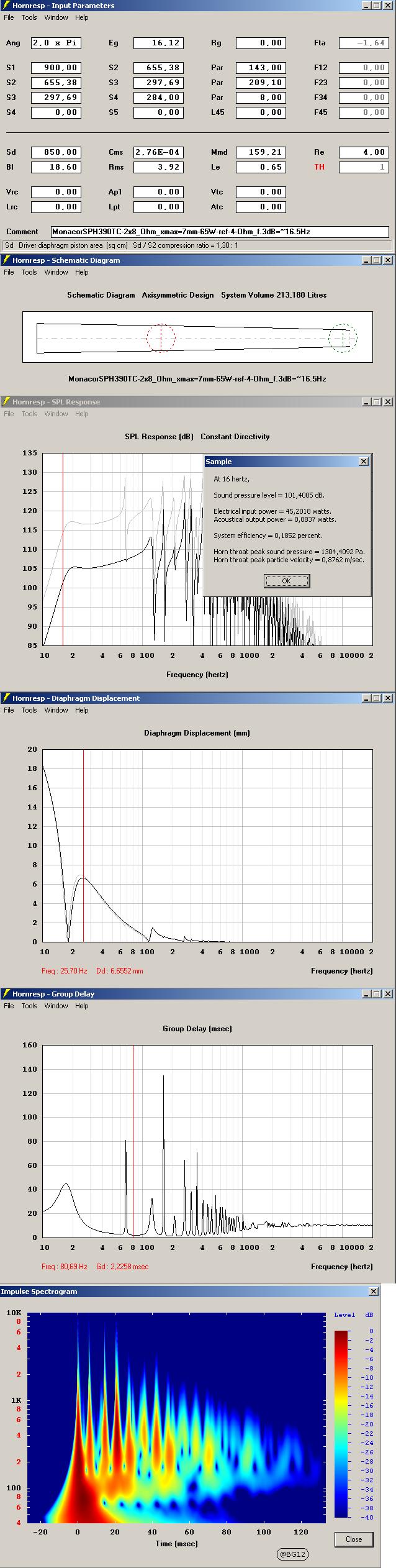

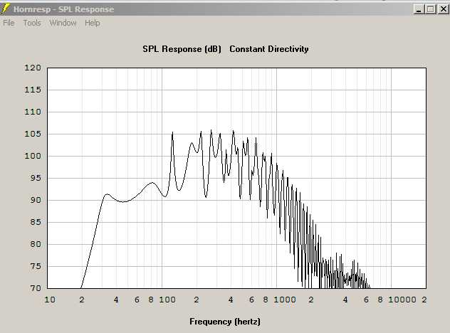

I must admit I don't understand what "tapped horn" or "PPSL" is.
bjorno : I think I have understood on the picture what is " T-TQWT with sloping FR ".
I think this would be really funny in a horizontal position with a glass table on !!!
But I am not able at all to make the plans...
Which speaker do you used ?
Hi, Your idea of a horizontal deign would work well with two folds..I used the first driver in you performance/prize list: The Monacor SPH390TC and this name is also stated in the HR Input screen.
b🙂
