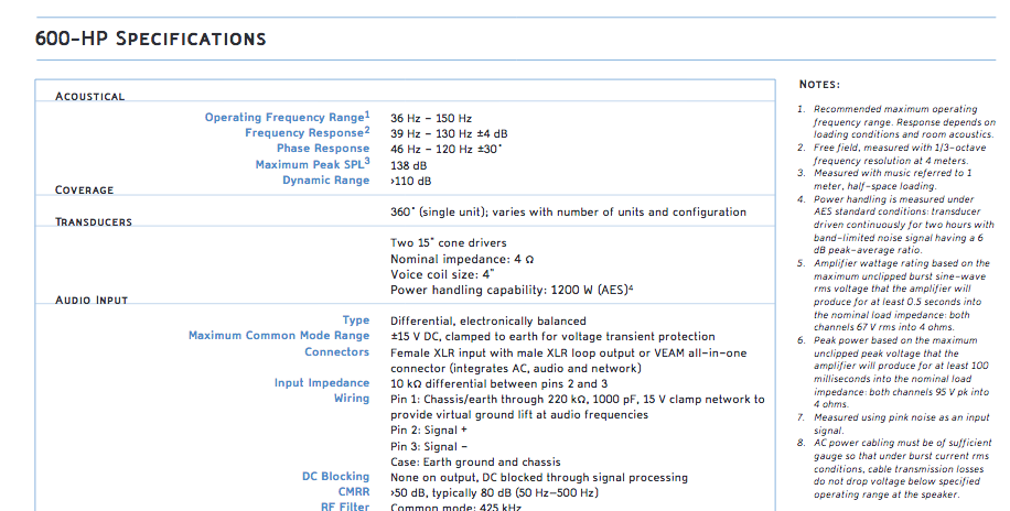

1)Just one thing, I saw this Meyer Sound HP-600 sub (2X15 inch sub with 2200W RMS and 138 spl max).
2)Basically, if I get two RCF 905 AS-II at full sound (one sub is 15 inch, 1100W RMS and 133 spl max), I will get the same power in my ears at a few meters as with the Meyer sub ?

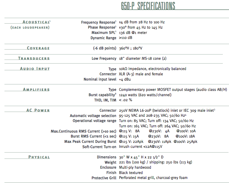

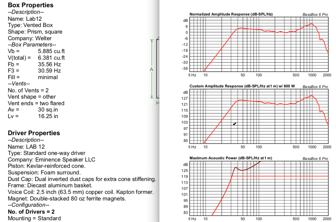

Needbass,
The answers to your questions go back to chris661 "Spec Wars".
1) The Meyers spec is a very short term peak in the upper range. As a comparative example, the 2x18" Meyers 650-P is rated as a "Maximum SPL 136dB @ 1meter", 2 dB less than the 2x15" 600-HP.
On 10/3/2009, got to do a side by side gig with my system ground stacked next to a flown Vertec 4889 system, 8 per side with 4 Meyers 650P subs on the ground per side.
16) 18” cones, 9920 watts ”burst capability”, 140 cubic feet of truck space, 1768 pounds of cabinet weight.
Headliner frequently pushed the 650P subs into “TPL” (TruPower limiting) and “Excursion limit”. The spectrum was 60 Hz boom-boom, about 6 dB more 60 than 40 Hz. At FOH, about 125 ft out, the system was hitting 108 dBC, the hard limit, no extra VU swing resulted in any more low frequency output, though it did sound crunchier..
My stage was doing dance groups with recorded music and one live act. On the last dance group, with some fairly heavy LF content, my 4)WS 2x12” front loaded ported subs using LAB 12s were hitting 104 dB, spectrum looking pretty equal from 40-80 Hz. 8)12” cones, 3600 watts (2 Crest CA-9), 31 cubic feet of truck space, 400 pounds of cabinet weight. Their output was +2 dB at 40 Hz, -4 dB at 60 Hz. Not bad compared to sixteen 18".
Since the ratio of Meyers to WS was 2/1, my cabinets were capable of 6dB more output to keep up- giving them somewhere around 142dB "peak" rating!
That said, I'd rate them at 125dB by their excursion limit.
2) As you can see by #1, peak specs may not relate well to real world output, though the RCF specs are probably far less inflated. Considering the drivers used in the RCF likely have considerably more excursion capability than the Meyers, and similar Fb, safe to say that a pair of the RCF 905 AS-II would have more output than the HP-600.
