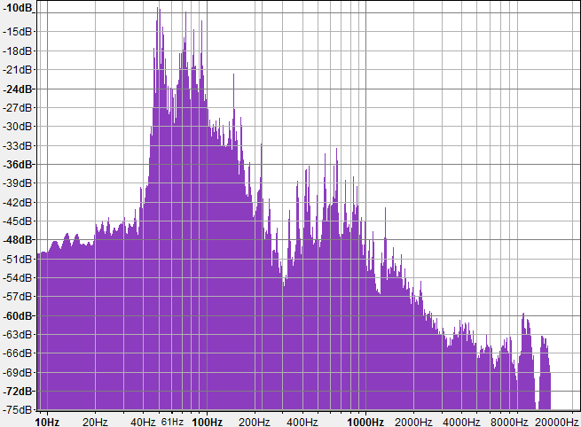

FWIW, I ran a quick spectrum analysis on that youtube clip (from 30seconds onwards where the abss kicks in) - nothing much below 50Hz, though obviously we don't know how much compression/bandwith limiting YT may do to the video after it's uploaded.
So, anything capable of sounding smooth from there on up should give you potential to recreate that kind of sound.

Hello David,
I don’t have the ability to get the hertz frequencies of songs and videos so thanks for that!
So you mean if I have a sub able to go below 50hz, it will definitely be able to recreate that kind of sound ?

Yeah, it does sound a little different, but overall listening to the balance of bass to everything else (even other tracks in the same vid), I think the Yamaha vid has more bass, which will skew our perception a bit.
I know it can be hard (especially right now) but you should really try to hear subs in person rather than just on YT videos to get a better idea of how they perform before spending several thousand Euros.
You simply cannot make judgements on SQ and system extension from a YT video, there are just too many unknown factors ranging from the frequency response of the recording device to who knows what processing that has been done prior, during or after it was converted to a web friendly format.
