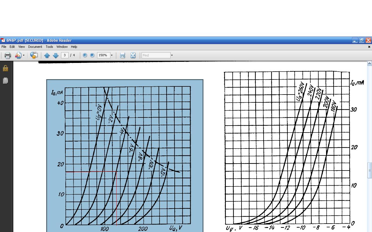

I put 220 ohms on the CCS bias. (couldn't find a 200).
Now I've got better results with the 6N1P.
Plate V: ~170v
B+: 225 v
current across CCS (2/220): 9.1 mA. Not going to burn out the 1w DN2540 with this no?
Do these figures look reasonable?
Thanks very much guys.😀
Update: music test sounds superb now. no distortion, just sweet tunes.
BUT the dn2540s are getting damn hot, almost too hot too tough. I switched it off as I think they will burn out.
I think I willl switch back to my pentode CCS until I get some 15 watt DN2540s.
You are dissipating 0.5 watts, so you're okay. 55 volts across the CCS x 9.1mA. Don't increase dissipation any more. Make sure air is relatively cool and flowing freely around the MOSFETs.
As SY said, to reduce gain change tubes. 6CG7/6FQ7 is 9-pin equivalent to 6SN7, mu of 20.5, cuts your gain in half. With LED bias and a CCS your stage gain will equal mu.
The 6CG7 likes 150V and 7mA, which can be achieved with 3.4V on the cathode; two red LEDs or four SiC Schottkies.
When you increase your 200R to 220, you'll possibly come pretty close to 7mA, but your B+ will rise as your plate voltage falls. Dissipation will be around 0.6 watts, so get those TO220 cases in the loop.

Brit01: as SY said, use a resistor to set the MOSFET CCS current. These things vary a bit, and to set the current you want/need you'll need to tweak a bit. To measure the current through the tube with a SS bias device (or grounded cathode and battery bias) simply measure the voltage across your resistor in the CCS. You must measure the resistance of the resistor itself of course, when you're using a pot. Ohm's law.
Use a 500R pot, see if you can adjust to the current you want with that. Otherwise, you may have to play around a bit to get the value you want. I'd use a good multi-turn pot and leave it in. When you change tubes, you can adjust the pot to experiment with operating points a bit.
