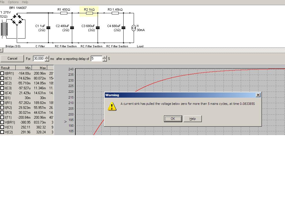

trying to simulate a smaller B+ with PSUII but it keeps showing an error "current sink has pulled voltage below zero volts".
I only have a 275 volts tranny and I'm trying a new SS rectifier with FREDs.
Can't get the B+ low enough for my small 6N1p and this CCS.
Any suggestions on the design? (apart from going back to my valve rectifier or using chokes)

You're doing something wrong. Can you show a screenshot?
FWIW, with a 15mA CC load, a FW solid state bridge, and a 275 transformer, I used a CRC filter, 47u - 1k - 220u and got a fine result; 367V B+, less than 12mV p-p ripple.
edit: at 30 mA, I get 350V, no error message. You're trying to get much too fancy and complex. KISS.
screenshot displayed above SY 😉
I tried with CRCRC and CRCRCRC
Too much value in the capacitors. The transformer and bridge just can't charge them initially, hence the error message.
Try CRCRC with all 3 C's at 47uF and 470 resistors as a starting point. You should get B+ around 260v and very low ripple at 30mA load. They will charge to full B+ in less than 1 second, so cut your reporting time back to 5s.

ah yes you were right. The high caps were pulling it down.
Managed to get a nice 180 Volts with a 1uf film cap as the first cap. followed by 1K/100uf/5K/100uf.
