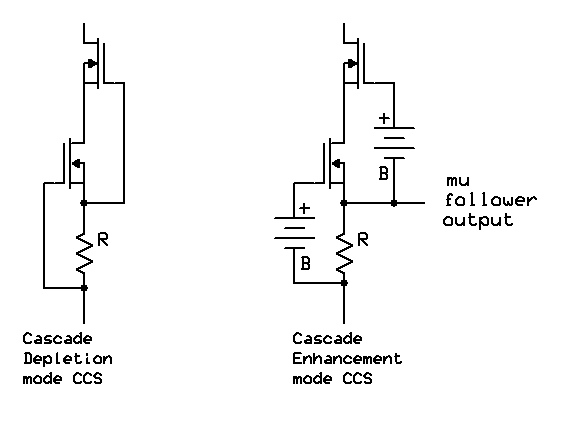

Not sure which is the gate,source or drain on this diagram.
Please can someone advise?
Is it just me or are those P-channel devices turned upside down ?
It's not you. The schematic drawing program I had at the time only had P. The devices are actually N channel. Pretend the arrows go the other direction. Or use the correct schematics from the ImPasse article that explains the use of the simple cascodes.

Attached is the schematic from Gary Pimm's website of how to connect the devices, but the "stopper" resistors are omitted.
