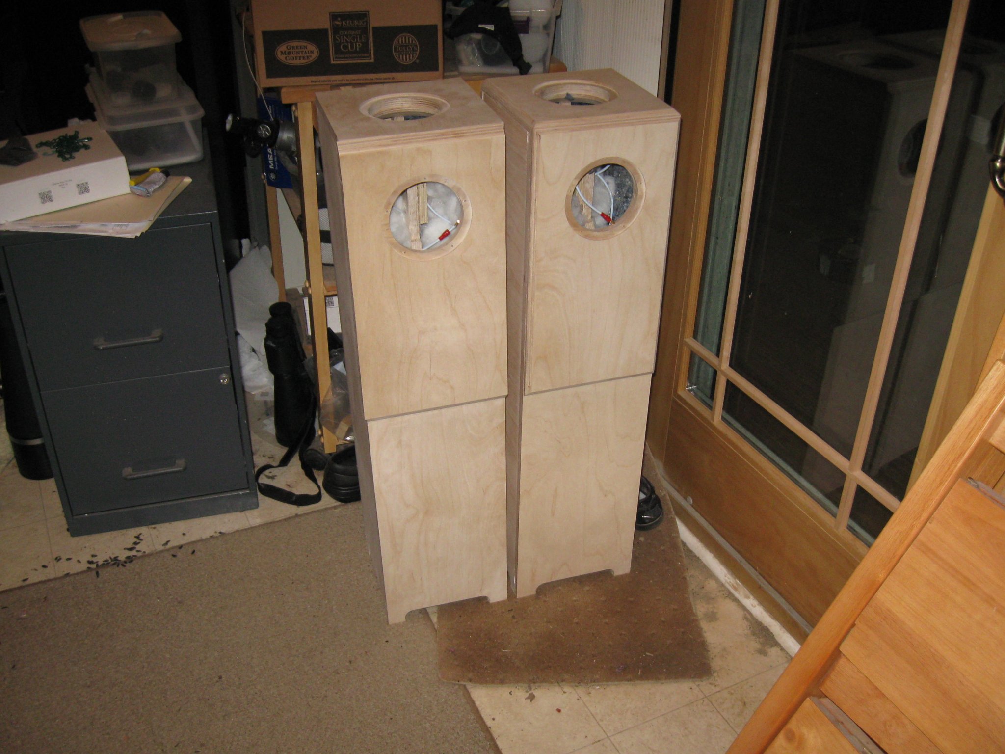

HI. I am so grateful that you posted this. I would like to build micro towers for my small room, but there are so many variations on them. Could you please post some photos and dimensions of yours? If there is no crossover, how do you connect the drivers? And the last question, where can I find / buy drawings?I built both the micro tower castle (flat top) with Pluvia 7 HD and the CHN-110 in the 18 liter BR box. Both sound great. I think the micro towers have a lower tuning so they reach deeper. The biggest difference that you may want to consider is, to me it seems like I can sit closer to the micro towers and still get a big sound stage. With the CHN-110 boxes more distance is needed to get that same sound stage. That might make a difference in a small room.

Hi Andrew. Some photos of my cabinets are in this thread https://www.diyaudio.com/community/threads/microtower-revisited.364581/page-11#post-6569709
On the first post of of that thread is a link to follow to get Dave's plan set . These speakers started with a driver that was different from the original driver and has a bigger (deeper) magnet. So to make them fit and keep the bracing, I doubled the front baffle and the top baffle. I'll try to get the dimensions today. They took a long time at low volume for the drivers to really shine. It was over a week of constant playing in the basement until they reached full potential. Lastly the stuffing was tuned to get the low end performance. Hope this helps

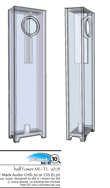

Thanks, but they're too big for me. I even thought about half towers, but I can't find the tests anywhere. Does anybody know how they sound?Maybe this one ?
With Alpair 10.
Thank you. So I found this pdf, http://frugal-phile.com/boxlib/P10free/microTower-maps-020615.pdf, and I don't see the drawing of the version with the driver on the top. Still not sure how to make stuffing. When it comes to the baffle for the top driver, it is not clear from this pdf what the baffle should look like. Where can I find or buy drawings for Pluvia 7 HD and the CHN-110 drivers?Hi Andrew. Some photos of my cabinets are in this thread https://www.diyaudio.com/community/threads/microtower-revisited.364581/page-11#post-6569709

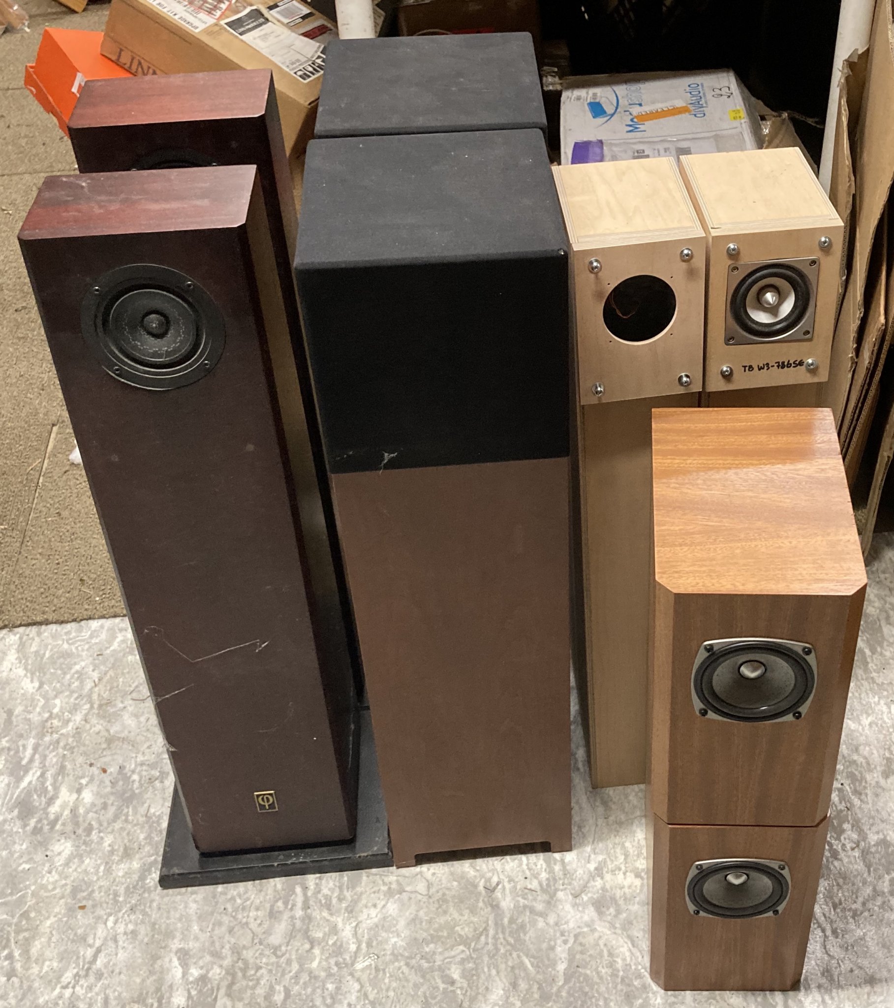

Since there are a zillion options.
Here are the ones i have - in the middle between the Mar-Kel70 Compact floorstanders and the FH-Lite, grills obscure the drivers.
