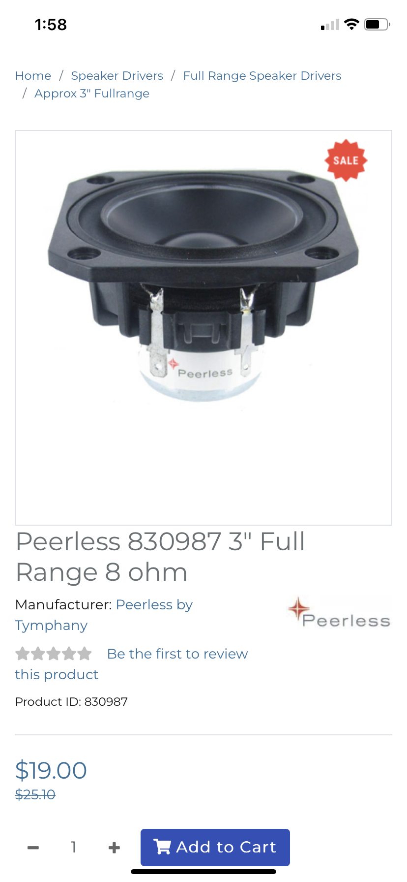

5.Peerless 820987 (On sale at Madisound now).
Not familiar with the Peerless, i can’t find it at Madisound.

Hi here’s the peerless fullrange driver at madisound on sale.Not familiar with the Peerless, i can’t find it at Madisound.
While all the other drivers are good, none will produce the required bass.

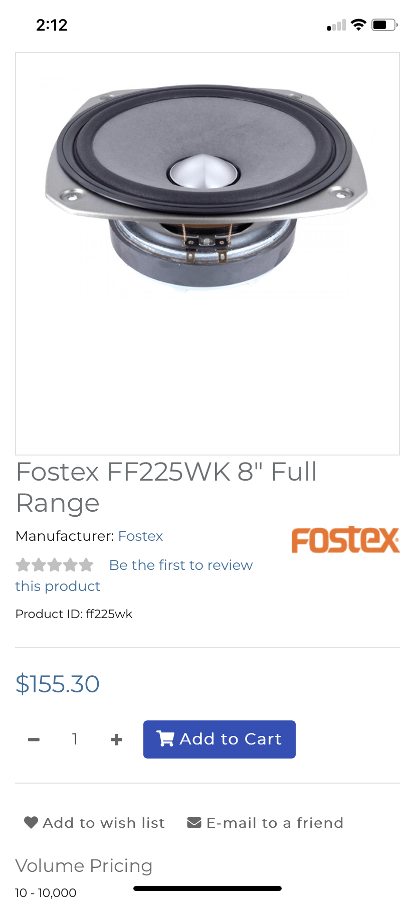

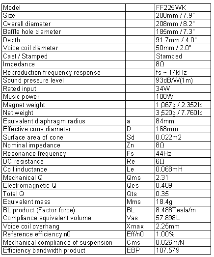

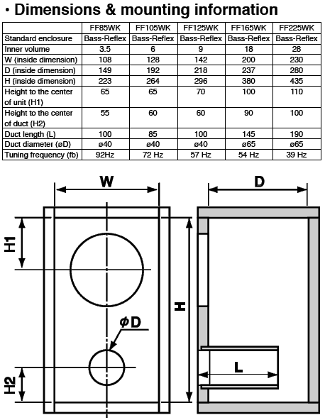

This fullrange driver comes to mind. (The 6 1/2 inch is sold out at madisound). It’s the fostex FF225WK drivers and put them in the ported box designed from fostex. Goes down to 45hz at 8 ohms and 93 DB. You can always build them and then add a super tweeter in the future. This is at Madisound.
FF225wk needs a tweeter in most cases. I have a pair of those kicking around as well.

Indeed, especially for the desired app, but I was referring to the driver, i.e. ideally needs a larger one with at least a 40 Hz Fs to get the desired 'fullness', preferably > ~6.5".FH3 is not that small

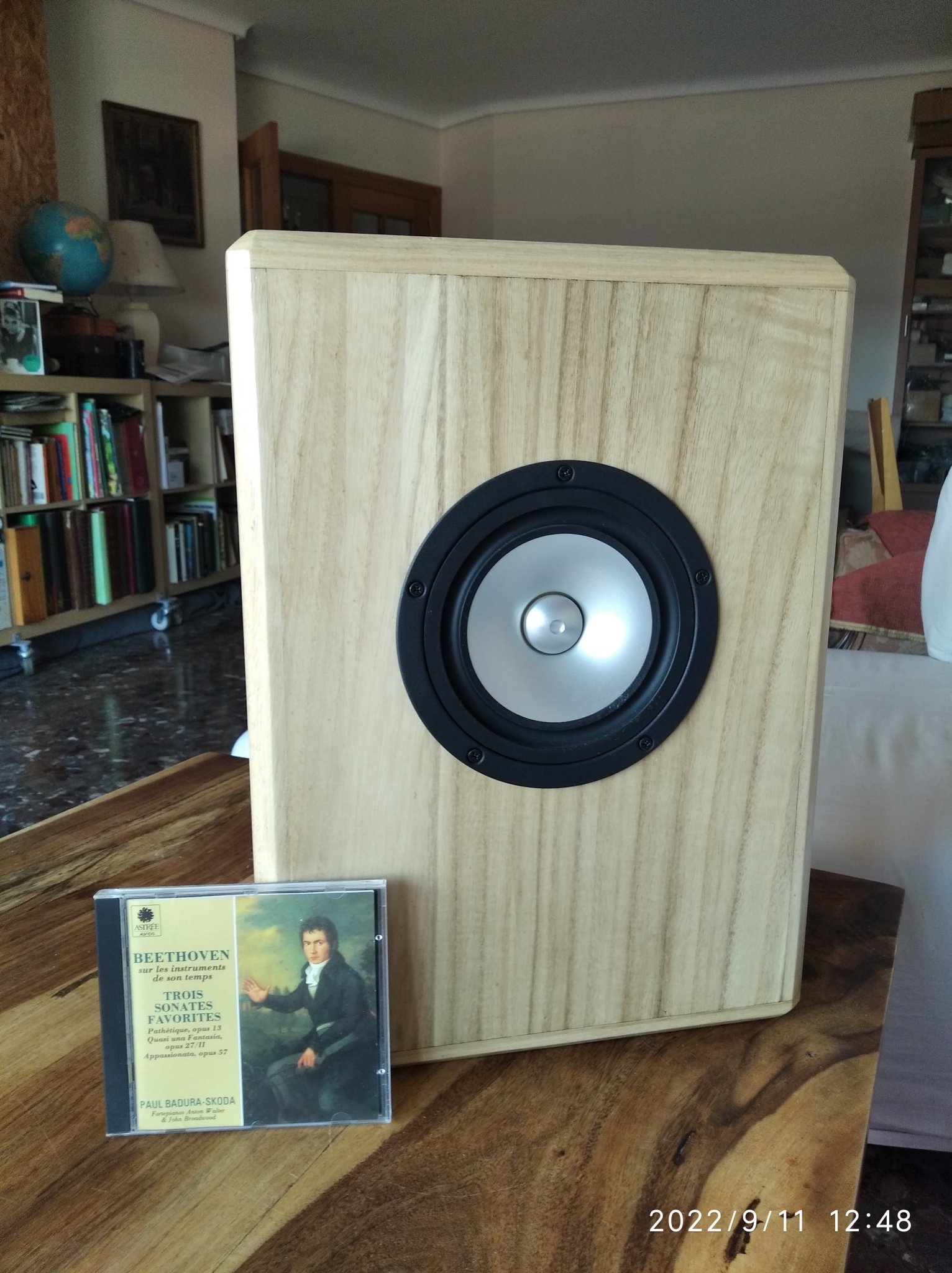

I'm another fan of Mark Audio if you want to go with a single-driver full-range setup. I have several pairs and none are my favorites over any of the others. They all sound great. If I'm not mistaken, they are built for the full-range setup, so you shouldn't need any filter or BSC.
I have a pair of CHP-70s in Dave's slim golden ratio cabinets and they sound amazing to me. I also have a pair of A10.2s in an Onken and, again, they are amazing. For what you are looking for, I would lean toward one of the A-10s. I haven't heard the CHNs or Pluvias, so take that into consideration. Whatever you do, have fun!!!

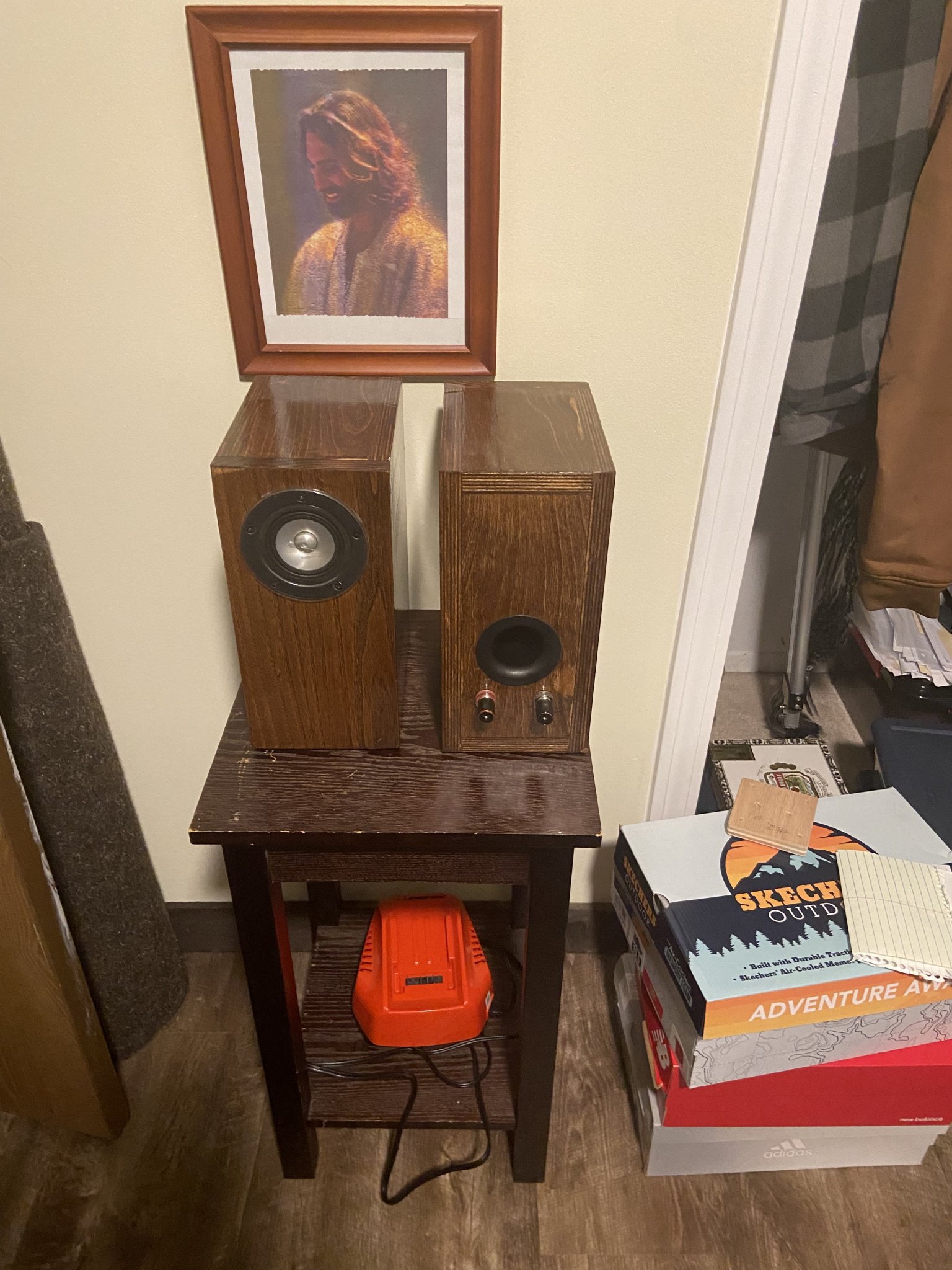

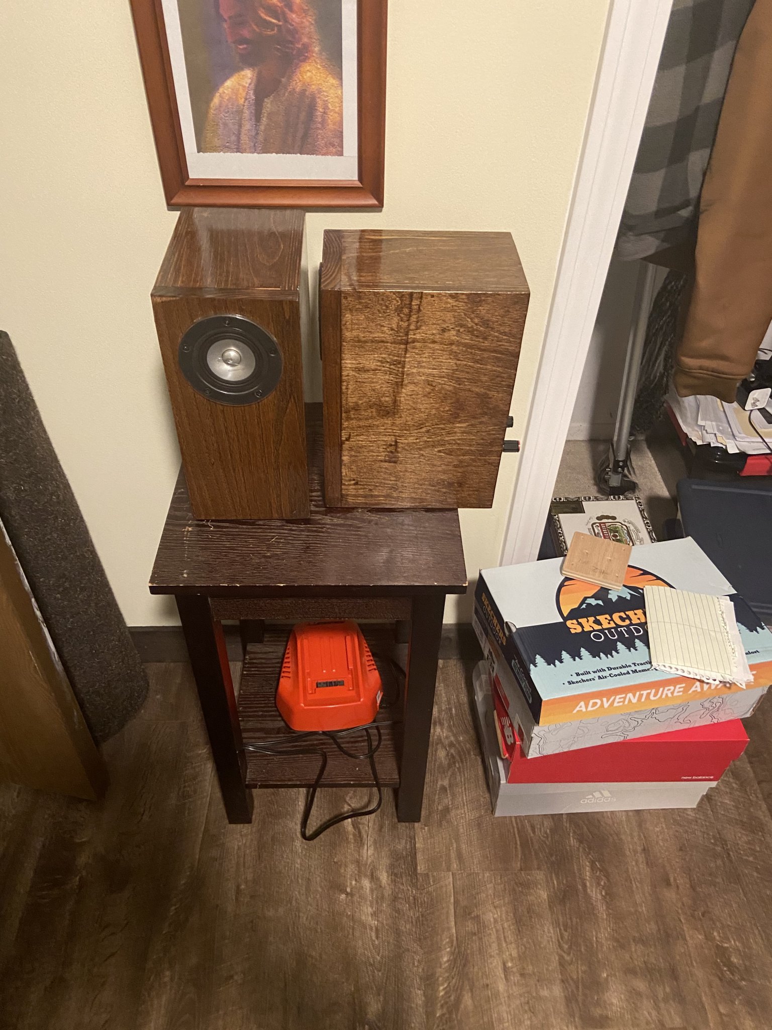

So I have both drivers. I have not used the CHN-40’s (2 1/2” inch driver) vs the CHN-50 drivers (which is a 3” inch driver’s). I have the CHN-50 drivers in a rear ported box that I desigand built 2 years ago. They are natural but warm sounding and the extended highs are a little soft and rounded out for me but, One the best 3 inch fullrange drivers for the price range. Here’s a few pictures. Good luck.
