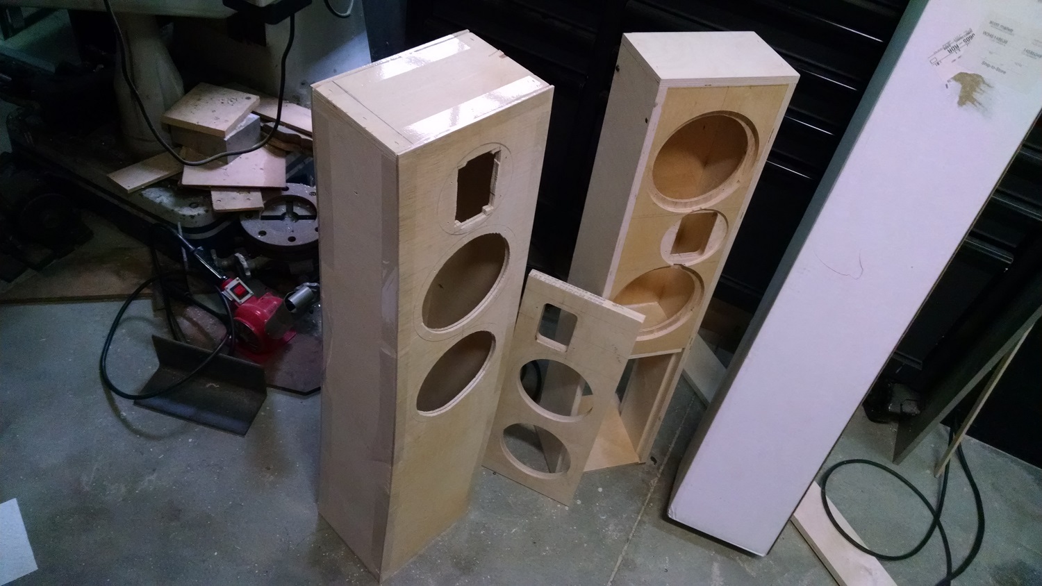

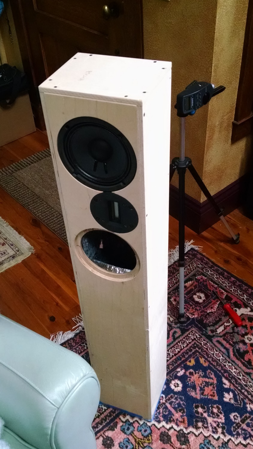

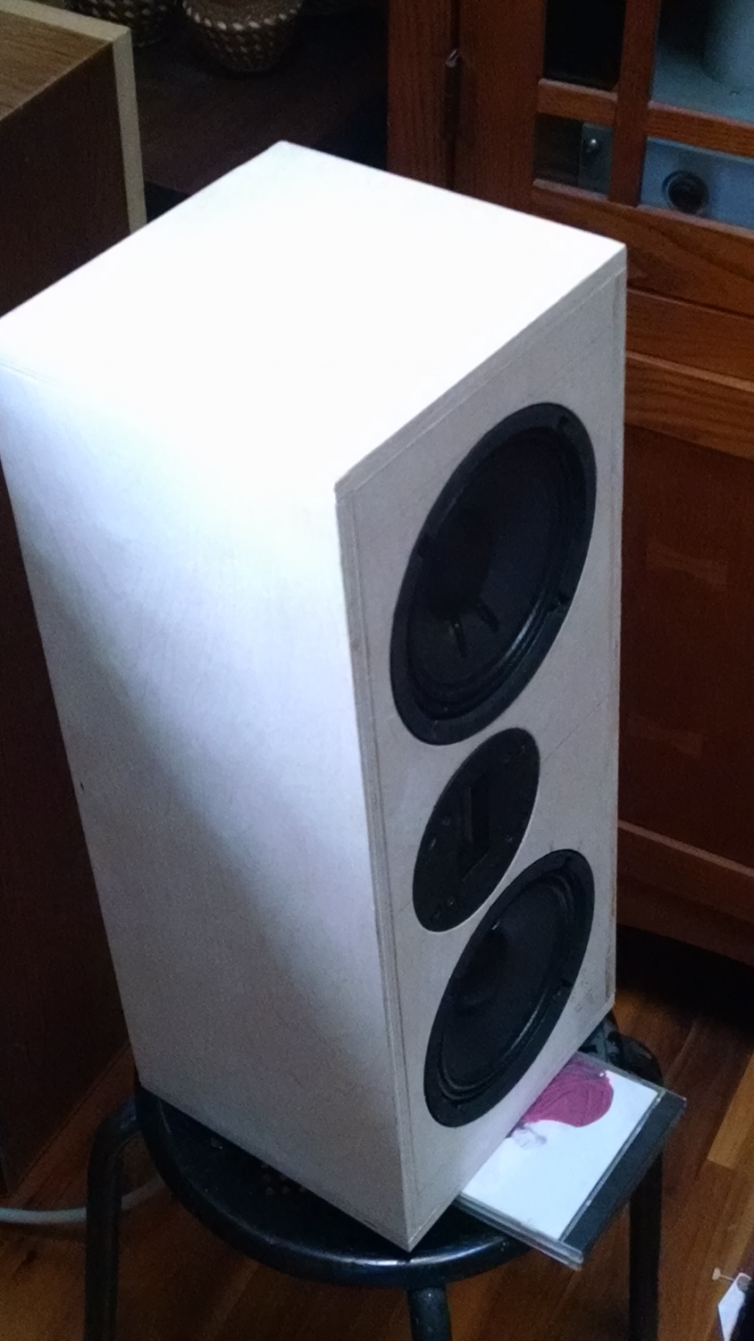

Mine are just prototypes....since we are all holed-up at home I've been making lots of sawdust building and testing vented and sealed designs....getting closer to a final design.

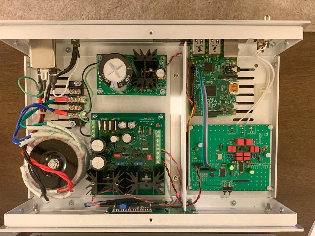

If we're on the topic of streamers, one of my completed projects is a Raspberry Pi streamer.
I use LMS (Logitech Media Server, same server as Squeezebox) on my main computer with all music ripped to FLAC.
The RaspberryPi runs piCorePlayer (headless client running squeezebox software).
Initially I used a HifiBerry DAC which was nice. I recently added an AMB gamma2 DAC module connected with i2s to the RPI.... I think this was a nice upgrade.
In the future I'll try out this setup with some USB based DACs.
The DAC and RPI run on separate regulated power supplies, and lastly I've added an LCD display showing the song info..
Overall very happy with this device
