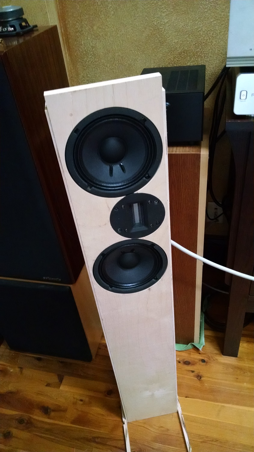

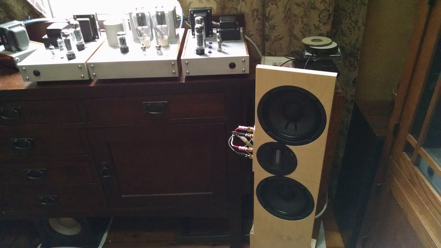

Since we are all sheltering in place out here in CA....I've been playing with other speakers.
I'm experimenting with a pair of FaitalPro 6FE200 6" and a Fountek NeoCD 3.0.
The FaitalPro's are 95db sens wired in parallel, so about 101db sensitivity neglecting baffle step losses. The Fountek ribbon is 93db, so in this case no tweeter attenuation is required.
I'm using a MiniDSP setup to drive them; the TSE is driving the mid-woofers, and 7 watts or so goes a long way with 100db+ speakers. The tweeters are being driven by a pair of Poindexter Music Machine EL34's (about 14 watts).
One thing to note, and George can add some detail if needed, is that the gain of the TSE is one the low side, so a preamp with some gain helps the volume level, esp with lower sensitivity speakers.
That's why I'm driving the FaitalPro's with the TSE, since I have some sensitivity to burn since the tweeters are 93db.
They sound and image really really well. I'm running them open baffle at the moment, but likely today I will build one of them as a closed box to attempt to get more output in the 100-300hz range as an experiment. I'm finding that these produce a very nice image/soundstage on many more songs compared to the Tang Band W8-1772's. I'm running the same subwoofer with these as with the Tang Bands.
The FaitalPros are readily available from Parts Express and a few other places in the US, but only in 4 and 8 ohm flavors. These are 16 ohm and I bought them from a place in France, but the price was lower than domestic prices even after shipping.
One other thing to note if anyone is thinking about miniDSP (highly recommended!!!)......you can dial in loads of crossover points, slopes, invert polarity, parametric eq and freq response curves (with Free REW software and the miniDSP Umik-1) from your compute via USB. You can do a month's worth of passive crossover tweaking in an hour or less, it's crazy.
I bought the std miniDSP box; they are around $100. One thing I'm finding limiting here is that the max output is .9VRMS according to the specs. The MiniDSP HD (around $200) has a max output of 4V, so that may help getting additional output from a lower voltage gain amp.

I really dig your setup!
2 questions:
What is your source?
What kinda music are you playing?
