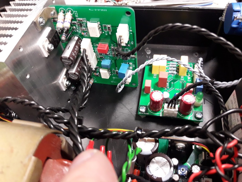

Sorry that I will speak not about shielded cables, but I want to add my humble experience: I started to use twisted pair instead of shielded cables, and a problem with "witch cable to choose" has gone.
I just take usual 0.22-0.25-0.35 mm2 wire, and twist it by myself. It is very flexible, and good enough for my measurement instruments (including low-distortion oscillators, amplifiers, etc).
Here is an example:
Here is an example:
But the shielded cables we've been mentioning here are twisted too. Is your twists per inch more than the normal shielded cable figures?I just take usual 0.22-0.25-0.35 mm2 wire, and twist it by myself. It is very flexible, and good enough for my measurement instruments (including low-distortion oscillators, amplifiers, etc).
I don't know, it's hard to find good enough for me twisted shielded flexible cable (somewere in my area). It's very rare, I started to see something like I need only last years. I have one or two examples, but I haven't taked it apart intentionally, and that twists I see in them - they are less twisted than I do, and they have less square milimeters wires (so they are not durable - 0.10-0.20 mm2). If wires are thick (tought) enough for me ( >0.25 mm2) then cable (with shield and outer isolation) becomes too thick and less flexible for inner wiring - not suitable.
The price for that cables (which are almost ok, but not 100% ok for me) is an order larger then just hand-made 0.25-0.35 mm2 twisted wire.
So, from all points of view I have chosen to twist wires by myself. Shield doesn't help much if wires are twisted good (6 dB max in theory).

Yes, I can agree with one point: I too have seen shielded twisted 2-conductor cables which are twisted sparsely.
UTP cables (for Ethernet) have very tight twists, but it's hard to find shielded Ethernet cables where I live. Since you seem to like unshielded cable, maybe you can check out UTP cables?
It isn't suitable for me to use UTP/FTP. Cheap UTP - is bad, good UTP - is expensive - I can twist two wires much cheaper. I just don't like to buy expensive cable, and take it apart, and it takes time too.
