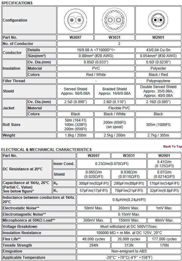

I use Mogami W2697 and/or W2901 microphone cable. It's very very small diameter ("lavalier") microphone cable, not the big fat rope that vocalists nervously fiddle with while they sing. I bought both types of Mogami from a US website called "Redco Audio".
Both of them have two signal conductors plus a ground shield, see attached diagram.
I use one signal conductor for "signal hot", connected at both ends. I use the stranded copper shield for "signal cold" a/k/a "ground", connected at both ends. I also connect the other (the second) signal conductor to ground, at the source end but not at the destination end. What I mean by source and destination is:
RCA input jacks ---> amplifier PCB: Source = RCA jack, Destination = PCB
PCB --> volume control potentiometer: Source = PCB, Desgination = Pot
I prefer to use the copper shield for "ground" at both ends, because it is bigger and heftier (more massive) than the second signal conductor. So it provides better mechanical support at each end of the cable, thus the weight of the cable is not pulling on a tiny and fragile stranded wire signal conductor. That's what I tell myself anyway.
