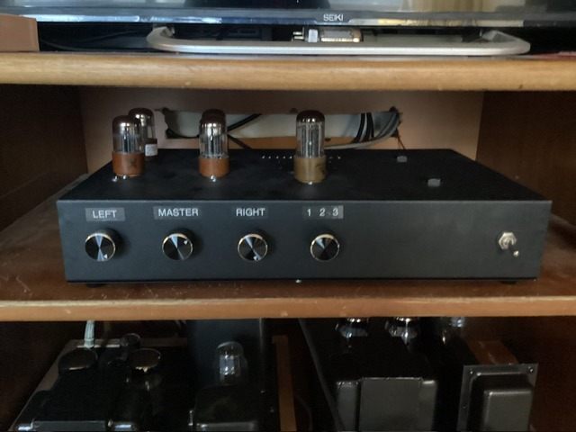

In my scratch build I use a 6X5 rectifier, a 20uF film cap, then a Neurochrome Maida regulator followed by 10uF film cap. That's it. The Neurochrome board is pricey but you can easily adjust the voltage for different configurations and it sounds lovely. The filaments are provided with 6 volt in > 6 volt out board made by diyaudio member v4lvelover.

I must have mis-typed. The only Aikido preamp circuit I have used is the SP14. Initially I modified one for a friend. I liked it so much I bought my own board and assembled one in a not very nice case. I have since rebuilt that using p-to-p wiring, a Neurochrome Maida board for the high-voltage supply and a 6 volt regulator board for the filaments. That is what I used now, with the same operating points as the SP14. Possibly the SP14 operating points contribute to the very nice sound. I have not experimented with changing them.
I should also clarify that when I talk about the "naturalness" of my Aikido preamp, I'm referring specifically to the 6SN7 Aikido. A friend of mine built an Aikido preamp with high-transconductance 9-pin tubes (I forget which, possibly Russian ones) and it's also very transparent but with a more analytical sound. It's my experience that the Aikido circuit will reflect very clearly the sonic character of the tubes you use in it. I prefer the 6SN7 for it's ease and naturalness of sound. This is true for my classic Williamson amplifiers as well, and also contributes to the very pleasing signature of several of the Eico amplifiers that use the 6SN7 for a driver.
