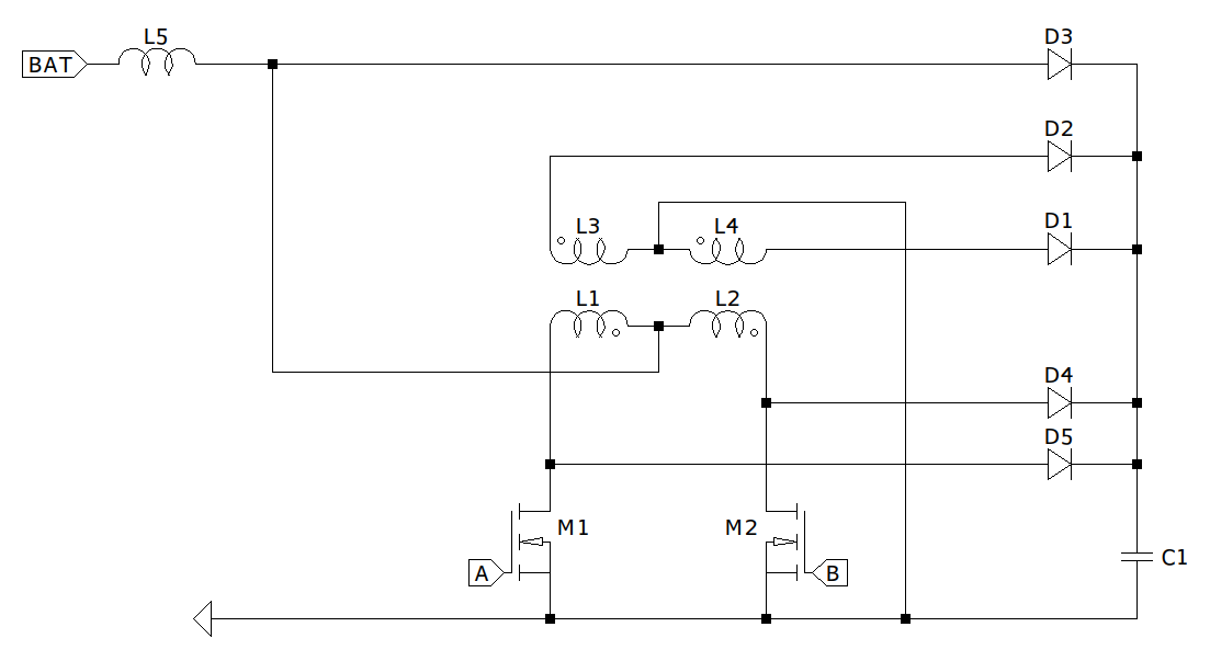

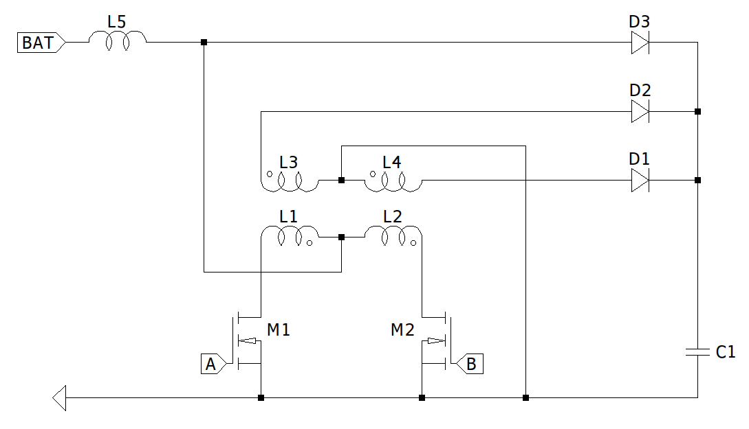

Anything current fed is nice because input filtering is easier. Like as not TI would have given you the best bang they can do for their buck. Your output voltage is greater than their design @54V vs 36V but it is specified for a 50V load dump. You'll know more about such things than me but the automotive environment can get nasty. Based on that alone I would be specifying 60V plus devices which may well be what TI are using anyway... oh they are happy with 50V. Car audio generally uses a push-pull convertor and relies on leakage inductance in the main transformer as something else to blow things up. You might consider a current fed push-pull boost, overlapping drives clamp to output, but it does not really give you anything over the TI solution other than an extra transformer and some more headaches, might save you load dump to the output since that should be regulated out. AFAIK Cuk suffers from twice the peak currents and/or twice the peak voltages in the power devices and you have to be happy shunting 50A/100A square wave currents through capacitors.
Yes. Cuk has continuous input and output currents. Every time I looked at one however I fell into all sorts of problems with untamed resonances which resulted in glowing resistors in damping networks.
In respect of my guess at the push-pull boost one of the things I was trying to avoid was overvoltage on the mosfet drains due to leakage inductance. Nominally you still need a VDS rating of at least 2VIN which really gives no benefit over and above the TI note but I guess it might be possible to play with turns ratios and get below that.

As I see it, the leakage inductance only causes spikes on the drain of the MOSFET, but this only affects the voltage rating, as this is not a permanent voltage. The switching loss is still merely affected by Vin as opposed to the boost converter, where the switching loss of the MOSFET is Vout*Iin

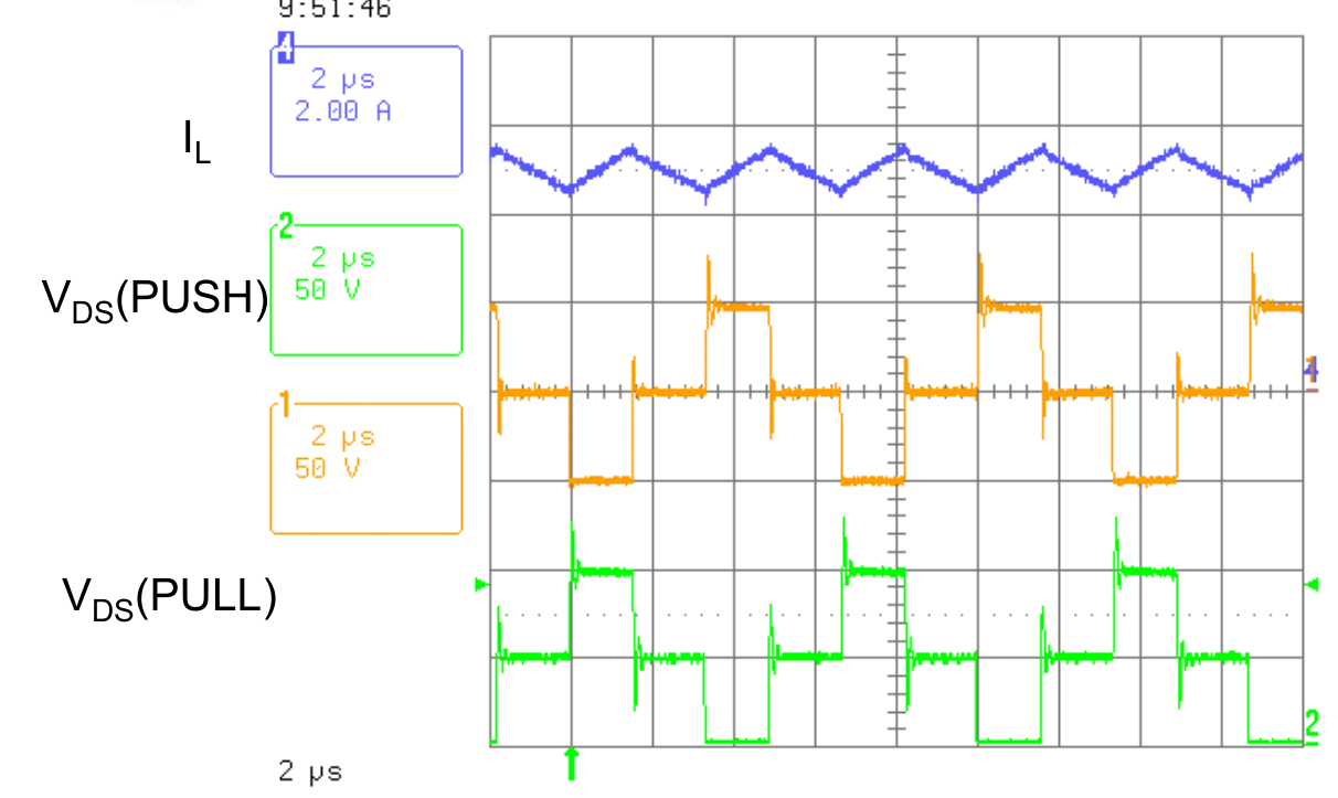

Here is a 250W reference design for a push-pull converter by TI: http://www.ti.com/tool/PMP11186
It's got a peak efficiency of 88% (going by only FET losses, a dualphase boost would have around 95%; the inductors wont have much loss, RedExpert by Würth gives me an approximate 1.2W per inductor), I'm going to calculate where all those losses come from (transformer?).
