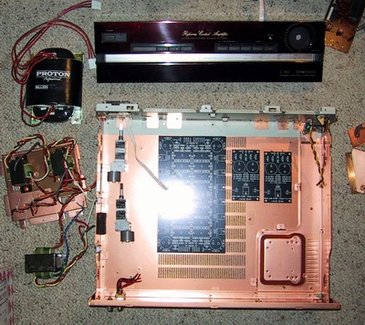

Aleph P
Preamp question...
I'm in the starting phase on a P v.1,7, and want to implement a "normal" volume-control (remote-operated).
When reading the service-manual, I understand that the gain-pots can be used as vol-pot. (And just leave out the "RELAY-pot-vol-control" on the output). Is this a way to go?
Or should I just use it "conventional", on the input of the circuit?
(Even an ALPS would probably not like to be used on the output?).
Arne K
