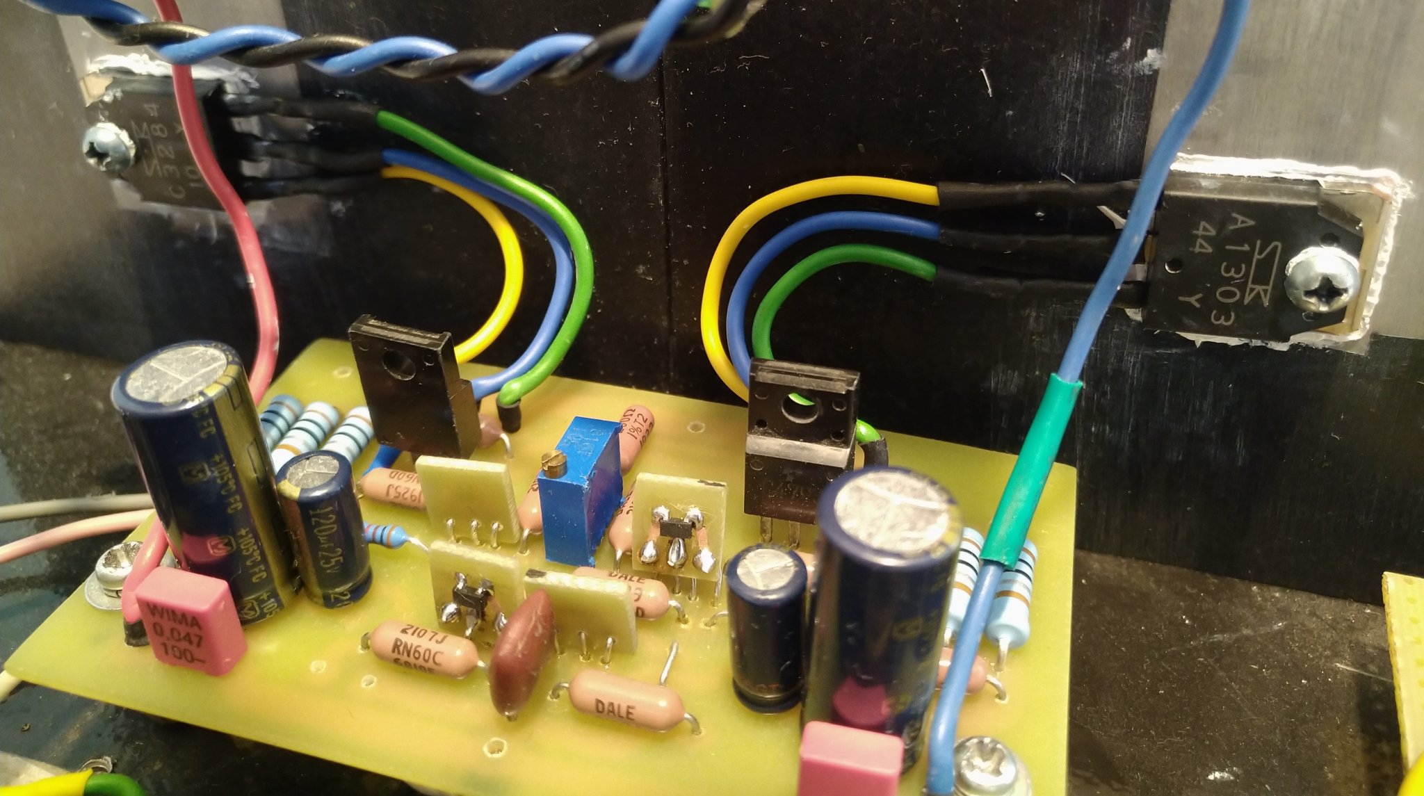

I use sanken 2SC3284/2SA1303, hFE rank Y

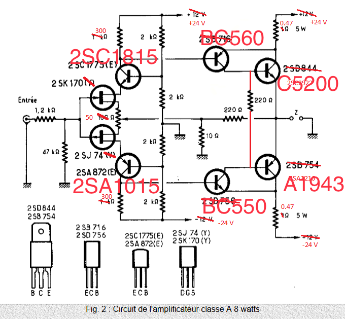

Hi all hiraga mamber
please help to correct the value of the schematic resistor and transformer that I use 18-0-18 after rectified at 25v.
Or can i use my schema and value with this component?…
is there any other good scenario for the component i have ? …
SK170-J47
2SA1015-2SC1815
BC550B-BC560B
2SC5200-2SA1943
Best regards
Rubah Ganteng

It is not a good idea to use BC550B-BC560B as driver transistors; use medium power transistors as KSA1381 and KSC3503 instead.
A great chance: the Classe A is a 4 step complementary parts amp.
Use the same transistors fo step 1 and 2, and other same for step 3 and 4.
Example: BC550/BC560 and BC560/BC550, TIP41/TIP42 and TIP42/TIP41.
Why: The (nearly) same current (exacter: curring, flow) of the parts are reflectet half waves related. And: you introduce only 2 x 2 instead of 4 x 2 different tonal characters. Result: a finer, more homogenic, more "dissolved" sound.
Reactions: rubah.ganteng

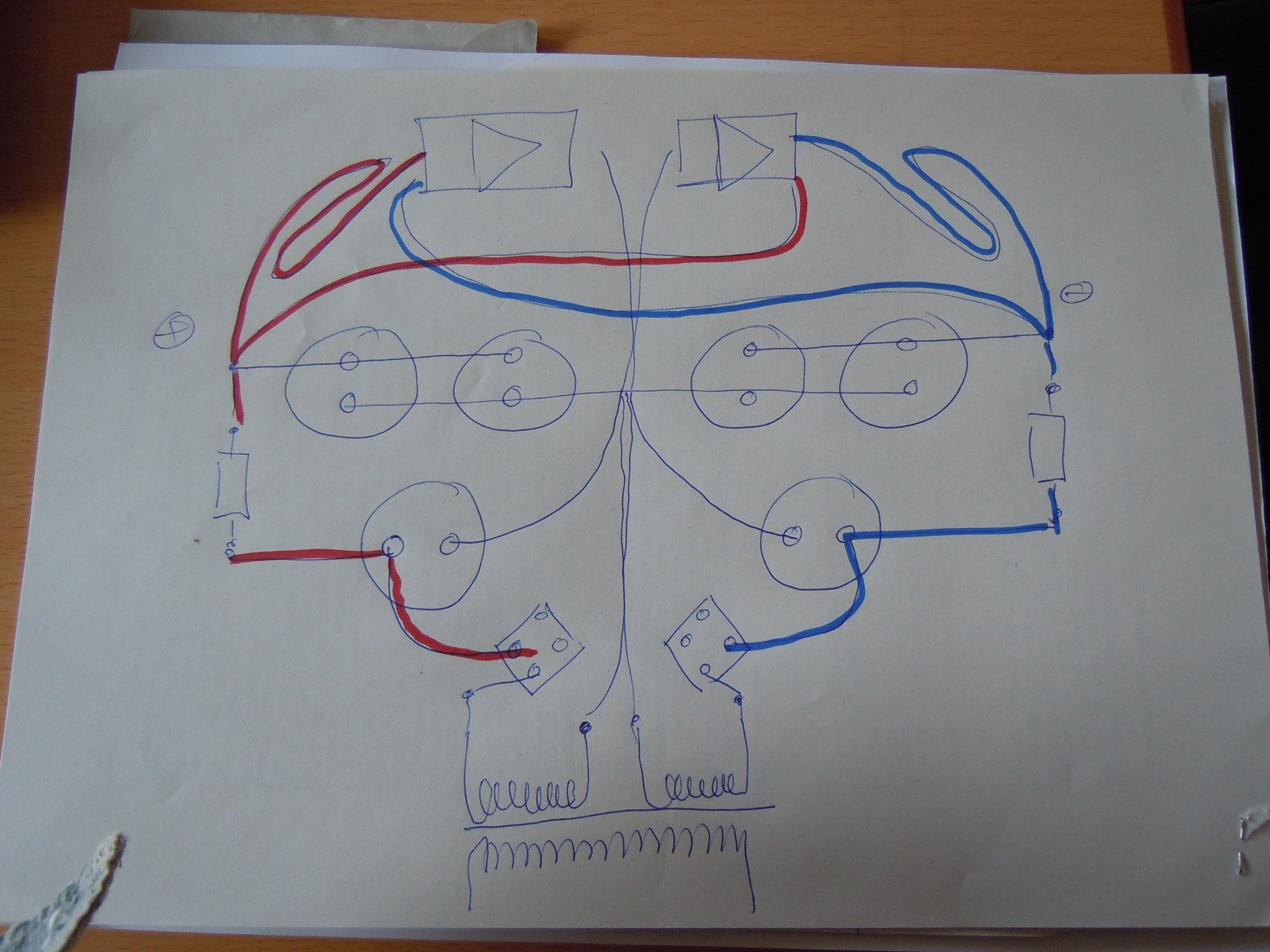

For maximum sound: resolution and homogeneity, in the case of Hiraga's Classe A, or Le Monstre - and also other half-wave amplifiers:
  • Connect each half-wave amplifier to even just one secondary winding of the transformer - Two rectifier bridges or only two simple diodes required.
  • With several parallel capacitors: route the voltage supply lines to the amplifiers in the opposite direction to the earth connection.
  • Make sure that the cables to the amplifiers and power transistors are identical in length: per half wave and channel.
  • Remove the thick copper bars and replace them with single wire, max. 1 mm diameter.
I would remove the bypass capacitors.
