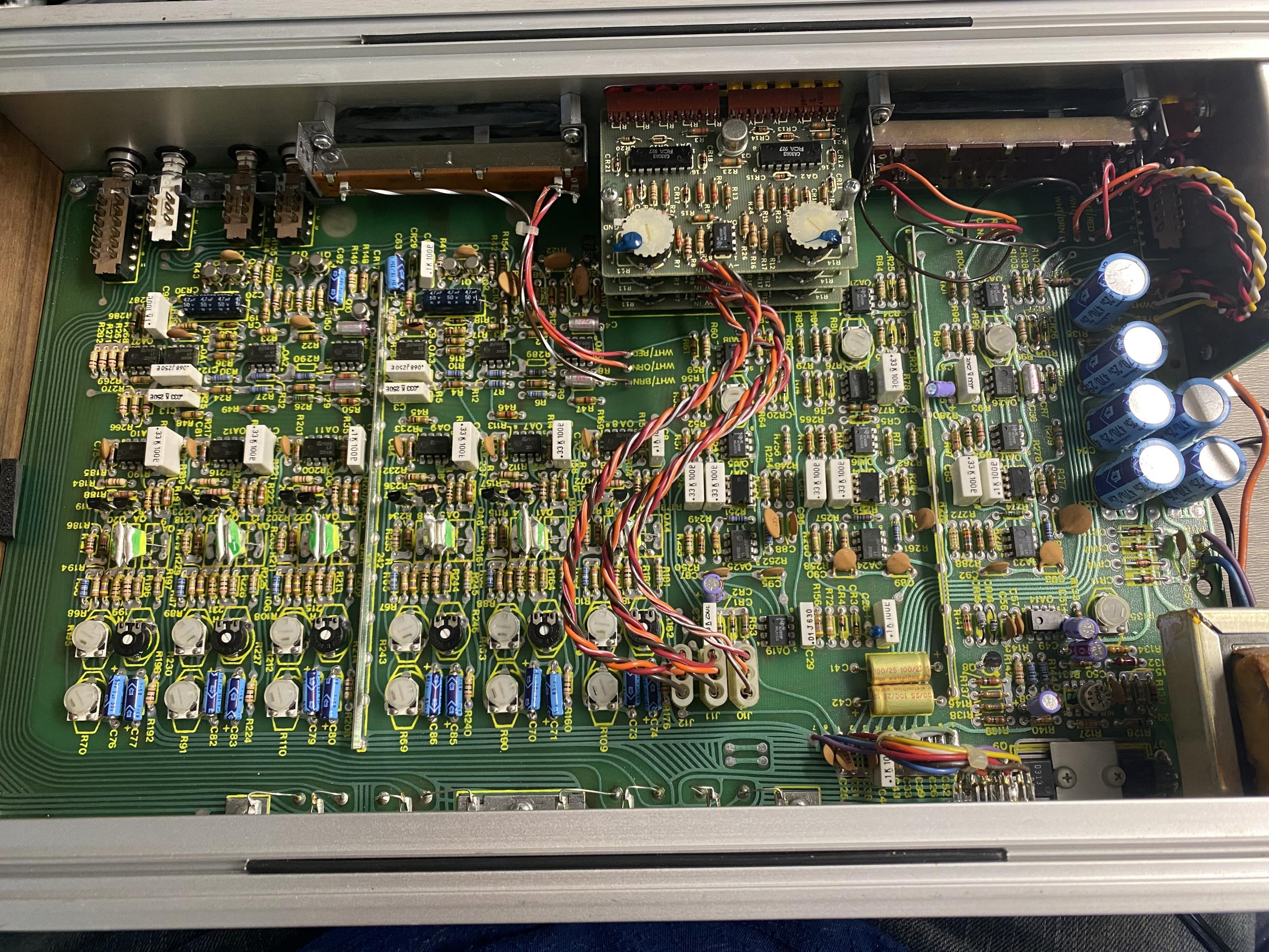

If your unit is the original one, the service manual doesn't give a components list to match the schematic. So it's hard to say what opamp to change...
At least 3 4558 are there to drive leds, not a very critical task.

Since it seems like the OPA1656 and OPA1641s are drop ins, could this mod in the link above be performed using the 1656 and 1641?

Thanks all, so it sounds like the 4558 isn’t the greatest performer, and yes three are driving the LEDs.
Here are the positions of the ICs.
LF351N: OA5, OA6, OA7, OA8, OA9, OA10, OA11, OA12, OA26, OA27
LF353N: OA1, OA2, OA3, OA4, OA20, OA23, OA24, OA25
RC4558: OA1 (of the LED driver boards) x3, OA15, OA16, OA17, OA18, OA19, OA21, OA22
Hope this helps a little.
Dan

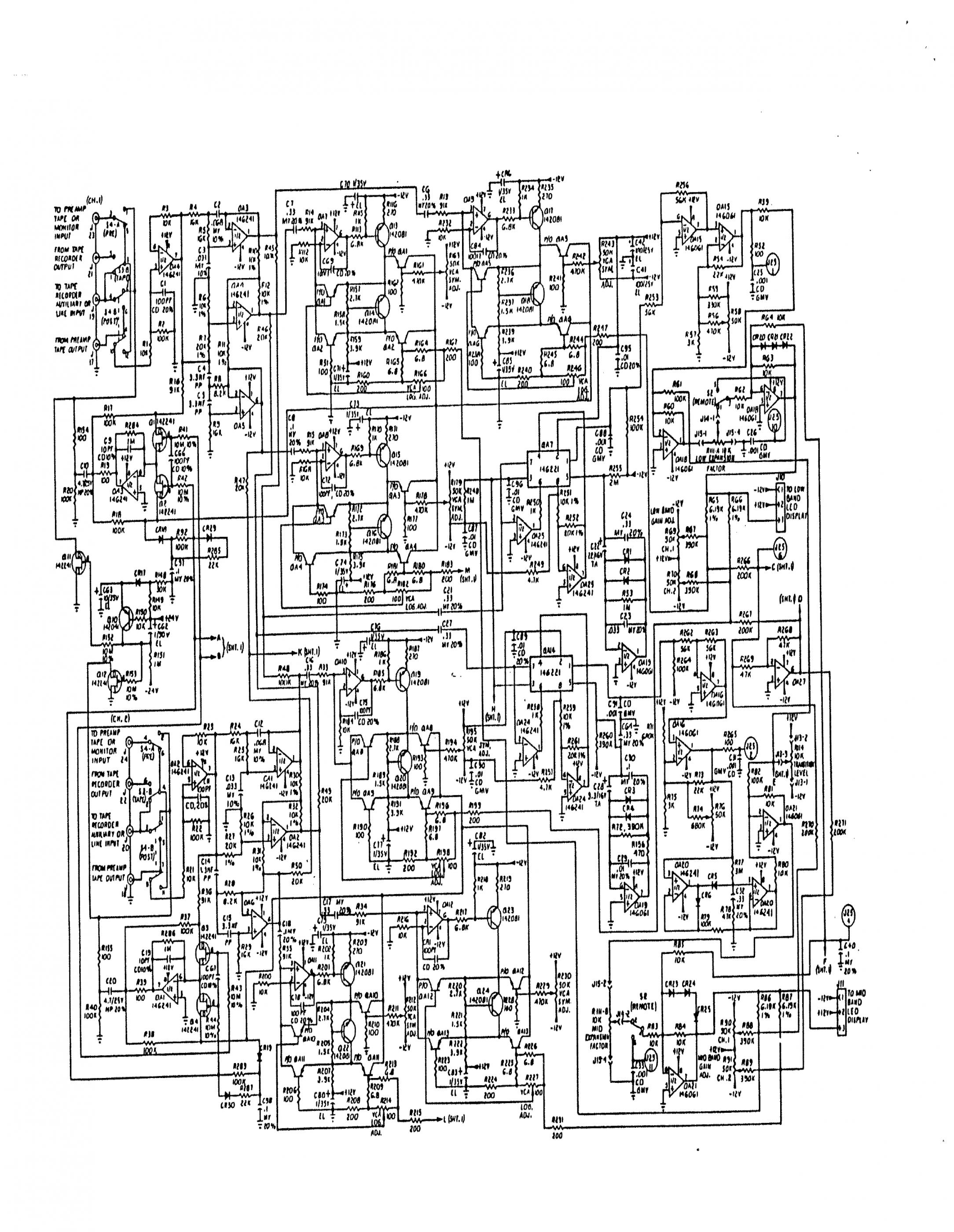

On a dual opamp, just put one 22 pF cap across pins 1&2, another across pins 6&7. They will then be in parallel with the feedback resistors and curb any tendency of the opamp to oscillate.The 22pf across the feedback resistors, how can I identify the feedback resistors? Also, does that mean wire them so that the cap is in parallel with each of the resistors? Dan

All the ones in the AUDIO path. Leave others alone.
Oh yes thank you, I figured that. I was hoping someone could help me determine which were in the actual audio path.

dotneck335 is right though. You could, like most of us started, take the schematic and draw a red line of what you think the signal path is. Then people here can comment and/or correct. That is the necessary "self responsibility" for a learning traject.
Please start with the red pencil. I think it is strange to ask if we can determine that as it is your device, your wish to change it and you should learn how to do stuff. Getting told what to do is not learning but the easy way out which is a weak spot to many tech people. For some reason many of those feel that telling someone what to do is the opposite of helping.

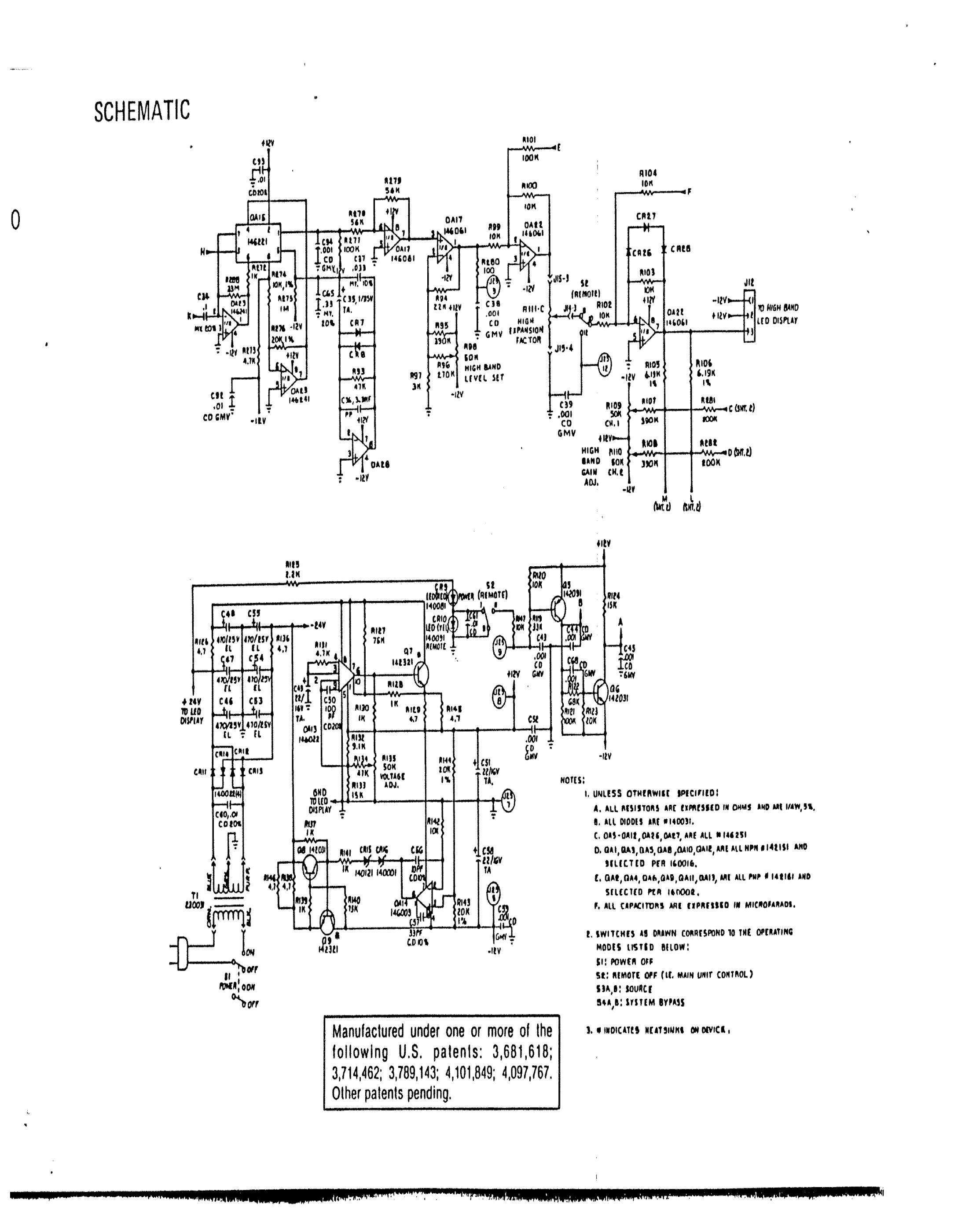

The schematics in post #6 should be attached instead of screen shots as they are very hard to read. Make a new post, click on "go advanced", "manage attachments" etc. Make that either the complete manual or just the schematics. If one wants help one should provide optimal/complete/readable information.

Here are the schematics in better quality or at least the best I could find.
Frankly, it's too complex for me to say which opamps would benefit from being replaced and I've no experience with such circuits. So I'll leave it to people more experienced.

Let's all be polite again. Please. The schematics as posted by 00940 are hand drawn and small which both contributes them not being easily readable so I will pass this one.
